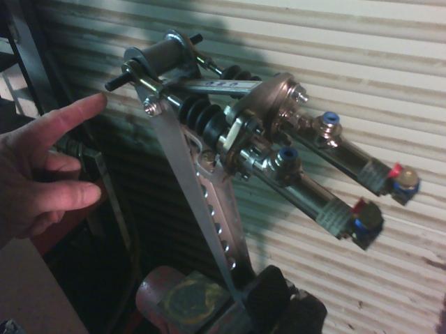

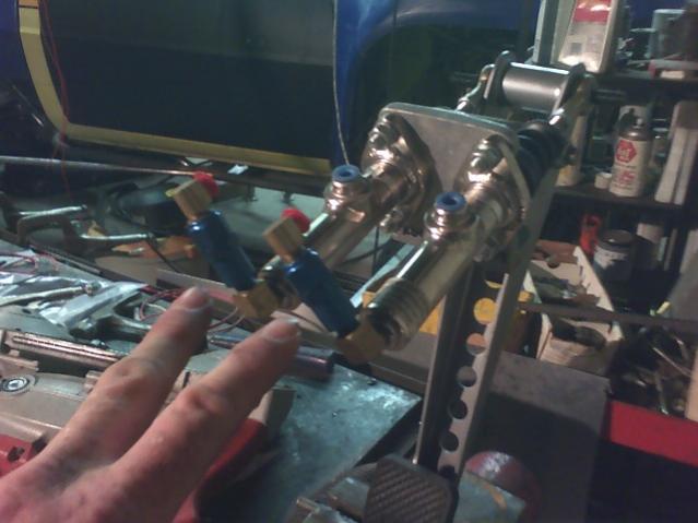

    Residual pressure valve. --------- proportioning Rod. It moves a shuttle left or right inside the tube. Changing the ratio. Front to rear.
