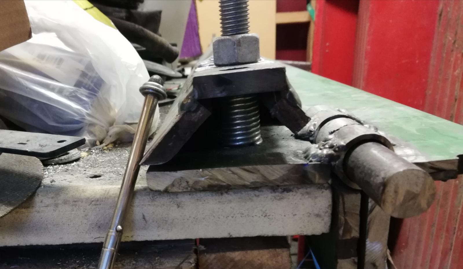

    Without a welder this week so ground To a halt on everything else.
    Drilled some holes in my bench and added the springs.
    Had a small test and it works quite well even without handles on 1mm steel. When I get a welder back I'll go ahead and add the centre clamp section

    More or less finished now
    Using up a few offcuts, but it works. Need to go through and gusset a couple spots. Forgot to get some 20mm ID pipe this morning shopping, but I'll use that to allow my 2 Jack handles to slot in in various positions. Bent a 50cm 1mm thick sheet to 90 degrees with no handles and it worked well, a nice crisp bend. May want to add in some fore/aft adjustment bolts to easily set up for sheet thickness.
    Yeah the bolts make it a bit slow, but if I end up being bothered by it I can do something about it later. I don't see myself needing to do a ton of bending on any particular day at this moment.
    Now I can get stuck into my tray!

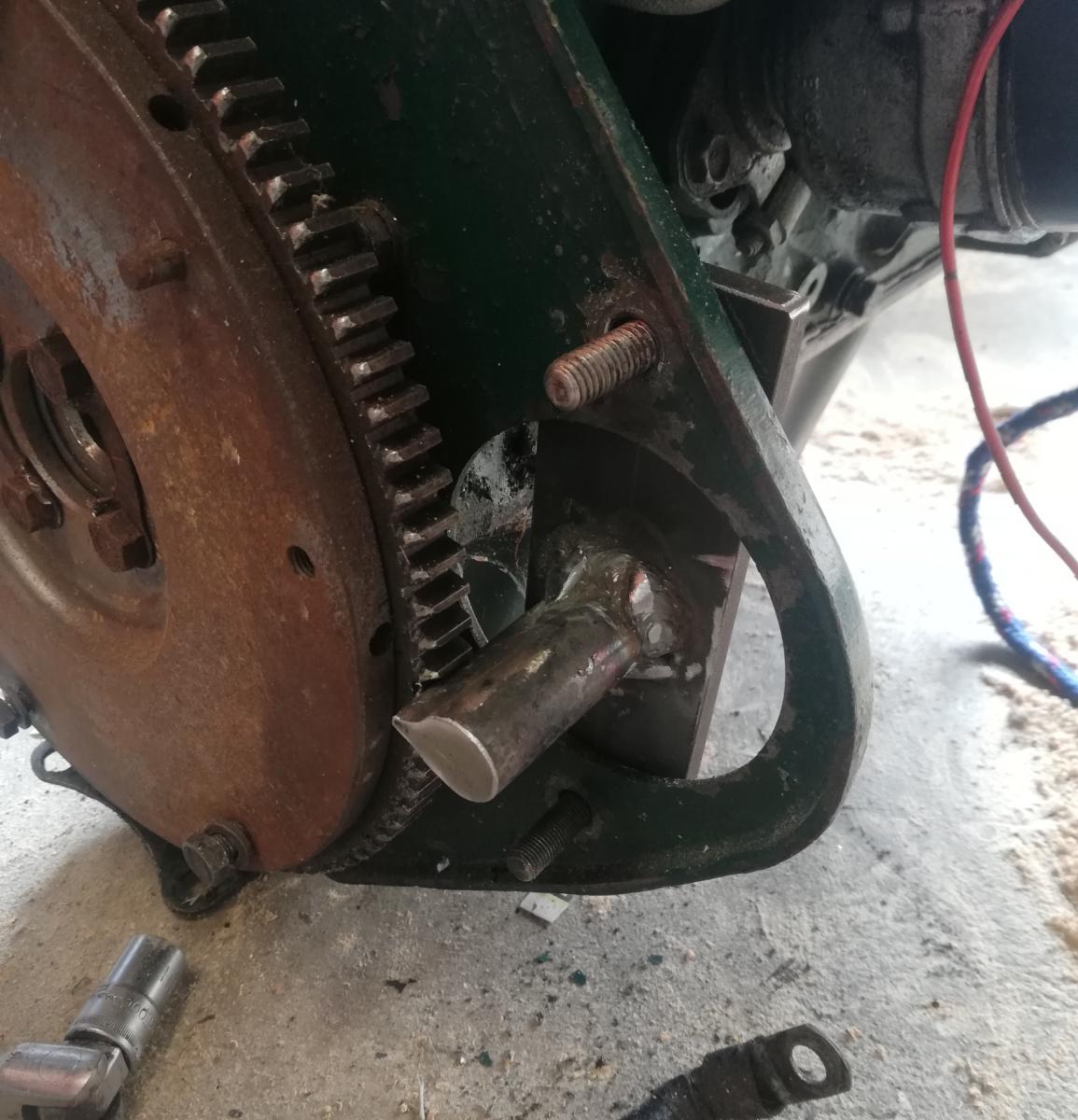

    Here's another little project.
    Needed to unload a Morris engine and store it, I have a spare engine stand so I thought that would be good for keeping it mobile and out of the way.
    Only problem is, I need to remove the flywheel.
    Can get away with a couple of big screwdrivers to stop the flywheel turning when removing it or the crank bolt. But I'm likely to want to use a stop again. Can buy them, they are the same for minis and all other A series engines, but I wanted it today and I have a shed of tools and steel stock.
    A series flywheel lock tool. Will fit minis as well. Works with or without gearbox attached.
    8mm plate cut to 6"
    Holes drilled about 5" apart to fit the starter bolts and holes
    I cut a piece of 20mm rod 2.25" long and then cut a quarter out of it lengthways in my bandsaw.
    I then cut a strip of 5mm plate to make the tooth. This is quite close to the tooth profile, so just a few minutes shaping it with a sander.
    Then welded the strip to the rod, and the rod to the plate
    Works well. I will letter punch what it is and tuck it away with my other home made Morris service tools
