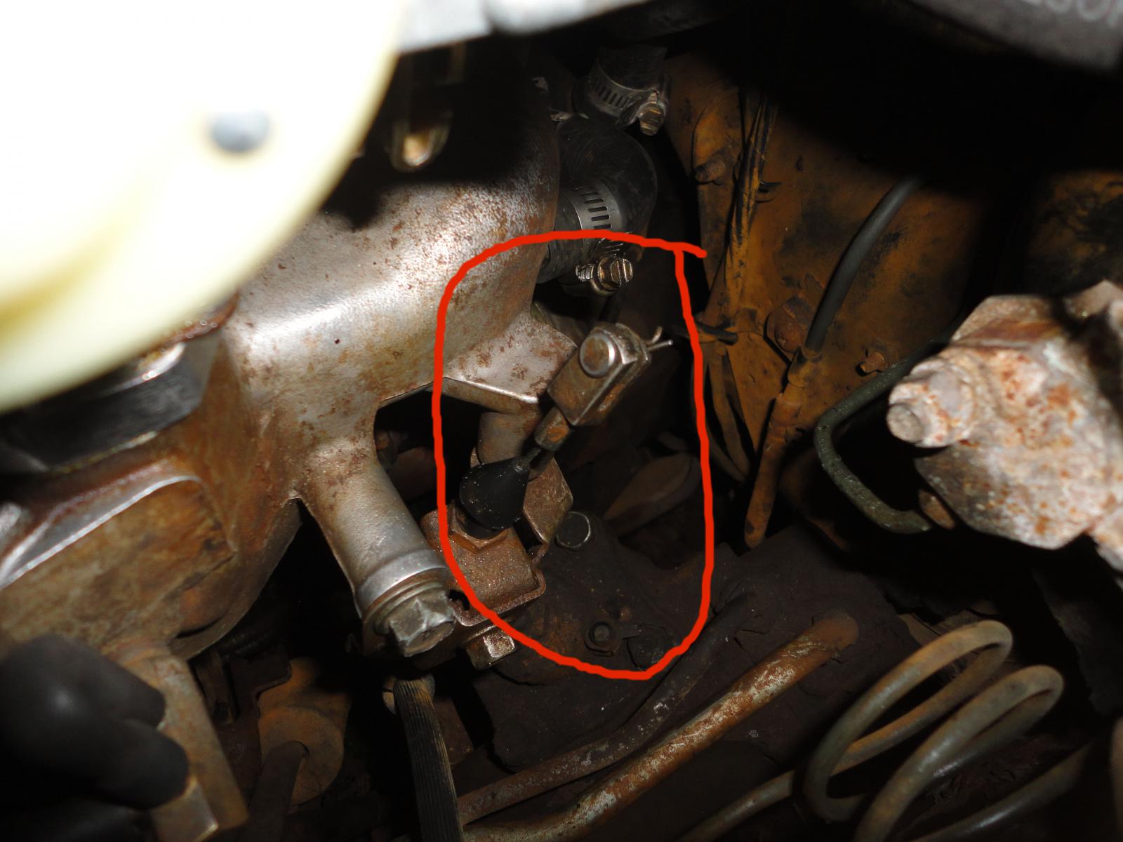

One major problem is the overdrive not working?
The overdrive light works, and I can hear the relay clicking. But nothing?
I've been told I can ground the temp sensor?
Well that's fine..
Which one??
I found 2 by the thermostat housing. One has an orange wire, and one is yellow with a red stripe. Or am I missing one, not sure what I'm doing?
Senior
what the sensor does is once the transmission gets warm enough it tells the transmission to kick the overdrive in. keeping that in mind is your transmission going into overdrive at all? it may be more than a sensor problem it may be a linkage problem.DSC02577.jpg
