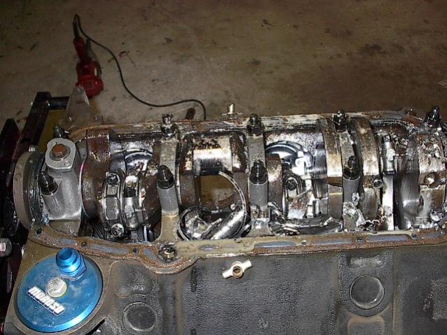

    I've blown up 2 SBC, one 283 and and one 350.

    Quote Originally Posted by LSR Mike View Post
    Were they boosted? And is that a good or bad thing....

    Never a good thing to blow up a SBC :-) They weren't blown, but same rules apply.
