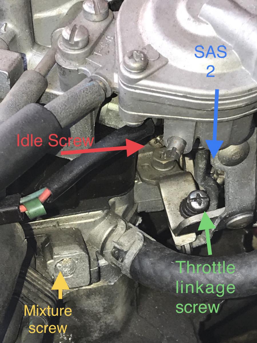

    Back off the throttle stop screw and the fast idle screw (the adjuster under the throttle cable linkage - do NOT remove that screw as there is a captive spring in there and you will have to be extremely lucky to find it if it drops out). Check the adjuster for the throttle cable to ensure it's not loading up the throttle and you have a little play on the cable. Wind the throttle stop screw back in until it touches the throttle cable linkage and try to start the engine (this needs to be done from a cold start so the fast idle can be set). Wind the fast idle screw in until you get an idle rpm between 1150-1250. Try not to apply pressure on it as this will fudge the idle. Let the engine warm up and check the idle (should drop back to 850-900 rpm). If you've got your carb sorted out, now would be the time to reset your ignition timing as the ignition relies on the engine idle being correct. Some carbs have a sealed idle air bleed screw which can't be monkeyed with but the usual way to adjust them is to wind it in all the way gently until it seats itself, then wind it out 1&1/2 - 1&3/4 turns.

    793A19FD-695F-468A-B88E-A65B310447D1.jpgDo have this identified correctly
