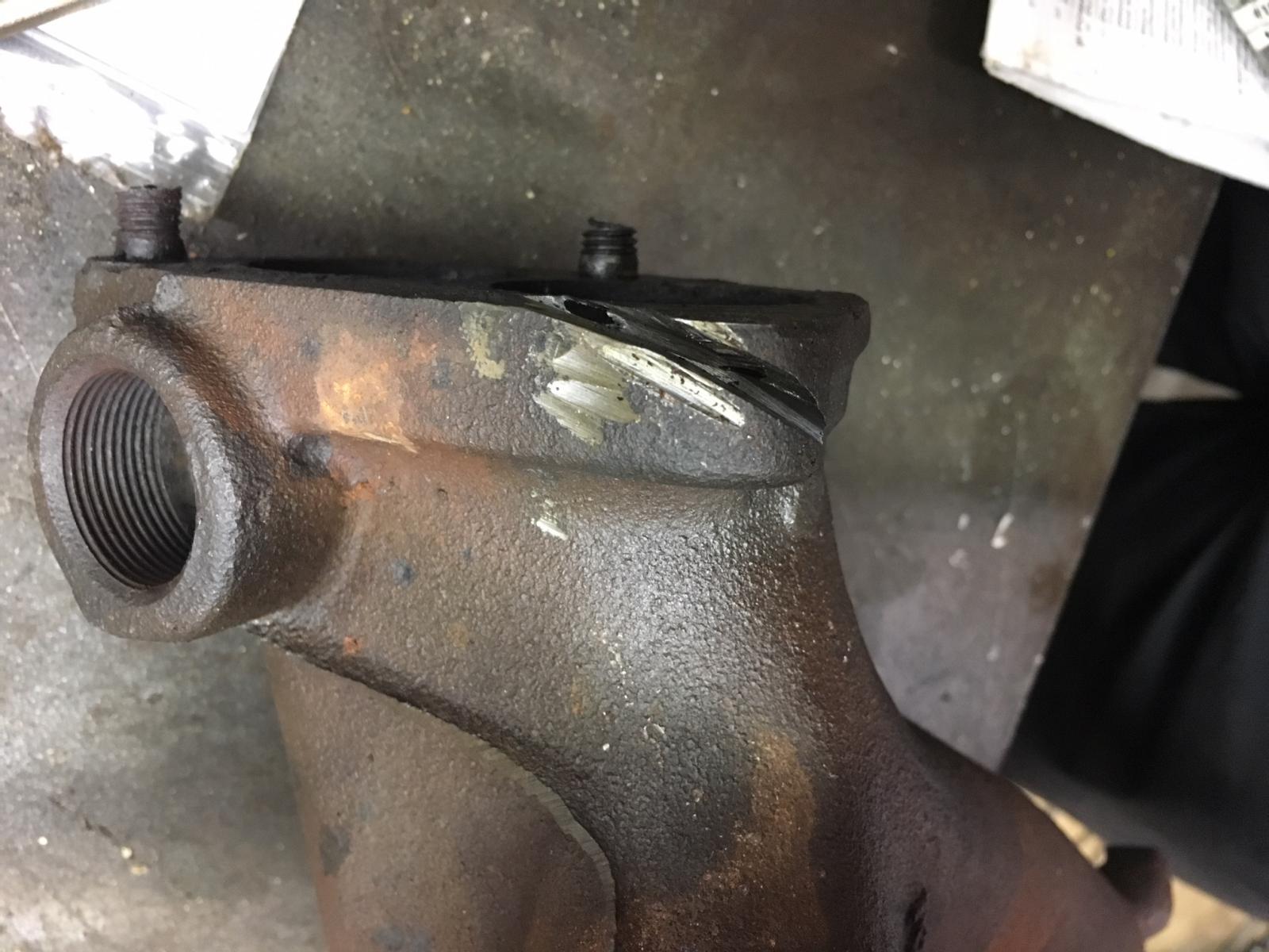

    Thanks everyone for the help. Well I finally got around to it this past weekend and I couldn’t see the back side of the manifold and effed it up with grinder. So now Idk if I can fix it or be better to try and find another one. Also got 2 block off plates made for the fuel pump and Egr valve. Thinking about starting an a new thread for my Weber installed and get some ideas on what I can remove from the engine bay
