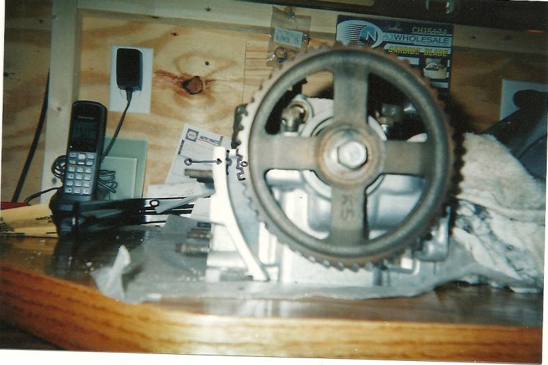

    But do stay on the timing. The ground wire isn't going to do any good until you get it running. Turn the crank back to #1 TDC, and look at the crank pulley mark. Put it at 10 degree BTDC, then look closely at the rotor, in the distributor cap - make sure it's in a position to get spark. I doubt the timing belt skipped a tooth, but that is possible. Take the top plastic piece off the timing belt cover, and check to see what condition the belt is in. Also look to see that the timing mark on the cam cog lines up with the mark on the head (NOT the top of the head). Those will give you some indication of how well the timing is set up.

    Have you tried moving the distributor position ? That is how the timing is adjusted. As for the cam alignment, click on the image below, and you'll see where I highlighted the "bump" on the head casting, and the mark on the cam gear. Those should be aligned when you're at TDC.

    I set it back to TDC (about 10 degrees before) and the cam gear lined up perfectly on its mark, I had to retard the rotor just a bit to get it where I wanted it and I noticed there was a faded mark mark that a previous owner had made so that's what I went with and she's trying to start. I was SOLO close just a minute ago. The battery started to sound weak so I have the charger in it now. I think I should have it by the end of the day
