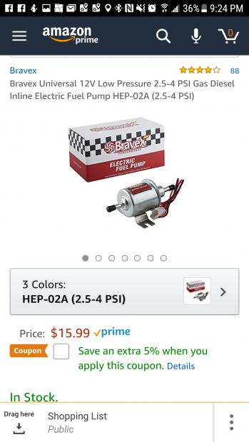

    The pump is an Amazon special. It was 2-5 psi 34lph I got a regulator and set it to 3psi. If u let it just set and idles it dies faster but if u run the rpm up around 1500 it will last longer.

    Here is the pump I'm using.
    Dude, I'm seeing bench tests on those pumps and they aren't exactly stellar... hardly any fuel flow (seem to be relegated to fixing ride on lawn motors and small carbs). Is the chassis of the pump grounded properly/good voltage/close to the tank etc? I still suspect it's a combo of tune and fuel flow.

    Im running that same pump geezer linked. It has done great for me and I dont run a regulator with it due to it having the correct pressure.
    The only issue I had was on a top speed run. It did starve for fuel for a second on 2 occasions but that was only after being wide open throttle for well over a full minute. Lets be real though, most people that have one of these trucks arent doing that. Could be hose routing. Its a great pump for the price and works well.

    Sounds like I'll be junking that pump. But I did notice today when I went to put some seafoam in the fuel the fuel tank had all kinds of pressure in it.

    That exact pump (Same part number stamped in plastic) is sold under mr gasket brand at autozone, which is where I got mine. Pretty much every autozone in the nation have these on the shelves in the "performance isle".
