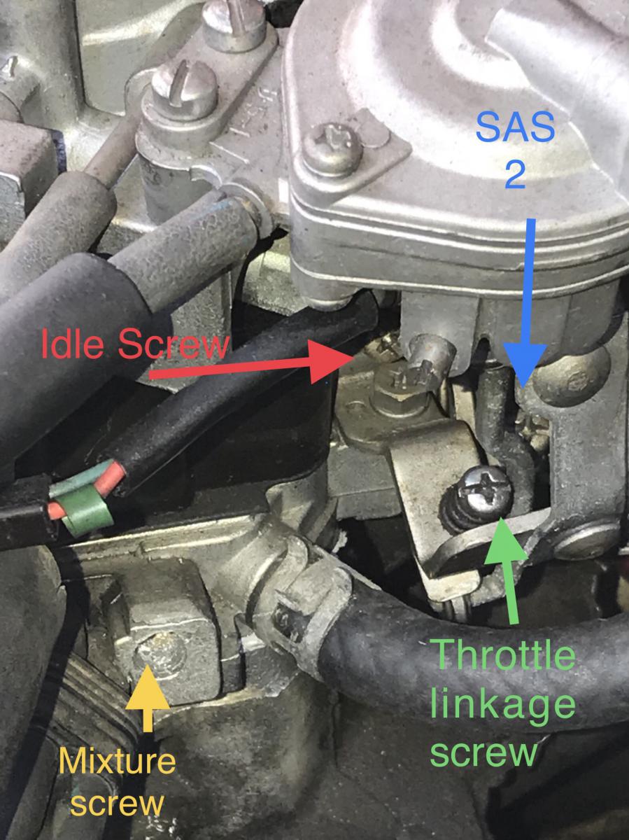

Hello i I am in need of some major carburetor help. I know the settings are not right. An I’m trying to follow your instructions but just not getting it. Sorry help me!!
