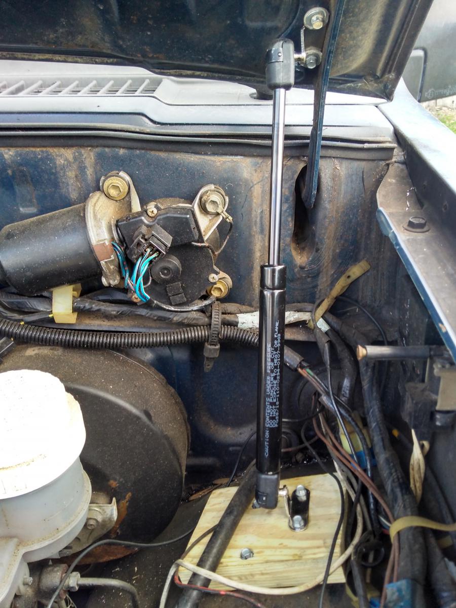

    well geezer got my studs in today and here are the results of my first attempt so far so good the only problem i ran into is the struts i have are to weak to hold up the hood they almost do but not quiet. they are 40lb load i just ordered up some 90lbs loads get this they are for a Porsche hood lift supports struts shocks props fit for Ferrari lol hope that don't make my little truck get the big head
    IMG_20180316_133708291.jpgIMG_20180316_134945368_HDR.jpgIMG_20180316_135656487_HDR.jpgIMG_20180316_141616171_HDR.jpg
    https://www.ebay.com/itm/10mm-45-Ste...53.m2749.l2649
    in case you want the link to the studs
    and the struts
    https://www.ebay.com/itm/US-2PCS-636...53.m2749.l2649
    once the new struts get here and i see if they work then i will do something about the base plate maybe weld some steal plates down and attach them to it. but for right now i figured the wood would work.

    Quote Originally Posted by jamesw View Post
    and the struts
    Is that how you're planning to permanently attach them?

    Sorry James but...that is a fail. The best way to mount them is in a location where they are completely horizontal when the hood is closed. Move the mount that is attached to the hood further forward and find an anchor point on the ledge where the fender bolts up. It is exerting too much force that far back. The mounts on those struts aren't awesome either - are these the struts from your tool box lid?
    yes they are from the toolbox thats why it,s not holding. as far as being permanently nope just experimenting. as far as being in a bind or exerting to much force the hood close's with no problems @ all and opens ez just like normal. it,s just the struts are too weak to hold open the hood if all else fails i can always go back to the rod lol
    FYI:
    the weight of of the hood is 38.1 lbs .
