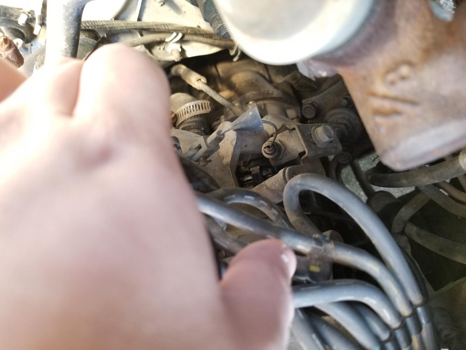

    Fluid level is good and red doest smell burnt or seem that dirty. Is the kickdown connected to the bottom side of the throttle cable bracket? Theres a cable coming from the trans uo to that and it has alot of slack. Il see if i csn post a pic real quick

    Throttle linkage behind hand
    Yep that's the kickdown - and it does look like it needs adjusting.
    Any suggestions on adjusting it it doesnt feel like it will go back in or do i need to adjust it somewhere else?
    If it don't go back in that is your problem - at no throttle there should only be a little slack on the cable. Go under the truck and move the kickdown arm that is attached to the cable to see if it will move there. The cable needs lubed, or your kickdown linkage is sticking.
    That kickdown appears to be on a slide plate - undo the mounting bolt and try lowering the bracket (don't remove the bolt completely, just loosen it). If that isn't the case there will be a retaining nut on the end of the cable that you'll need to undo and then wind the cable end out (like the adjustment on a throttle or clutch cable). In a crappy spot to get to but simple enough to fix
    But I wouldn't do that until you are sure the cable is moving freely, and the arm isn't stuck. Mark the slide plate so you can return it to the place it was before you move it incase that is not the problem.
