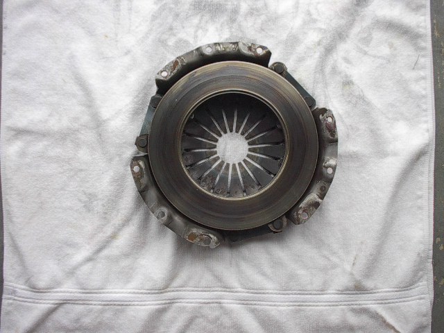

    Could this be because I mixed two different gl-4 rated oils? when it starts to get hot it also slows down the speed. When it's cold it runs normal. also how can you tell if you have a bad clutch.
    Bad clutch will be slipping or shuddering, excessive pedal travel, hard to shift into reverse (these symptoms are related to all the transmission parts - clutch, pressure plate, thrust bearing, flywheel and clutch arm mechanism). Heat is a by product of friction. Maybe add a friction modifier to the gear oil, check your oil level etc. This will also swallow up HP. I want to try out Petron Plus in a transmission but the stuff isn't cheap - it had better live up to the hype...

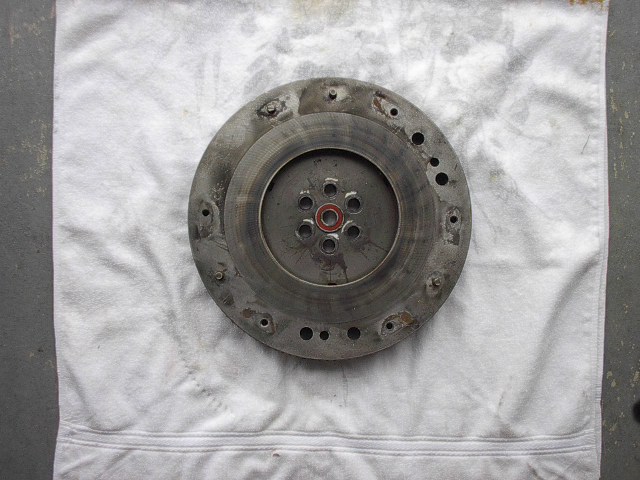

    Will clutch replacing require flywheel grinding?
    04-04-2011
    712
    Columbus, OH
    1992 Mitsubishi Mighty Max
    you should have the flywheel surfaced, look for burned/hot spots.
    examples.
    1,219
    It's normally the done thing as it's all apart already. Most clutch places will do it for free if you buy the rest from them
