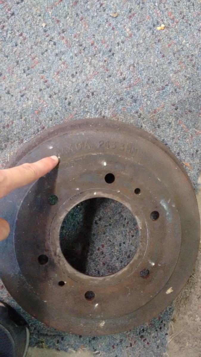

    How can u tell what size brake shoes I need without taking drum off
    1,219
    The max over size is printed on the drum itself
    243.3mm equates to the 9.5" shoes. Probably you have these anyway unless 4wd. With an 84 make sure you get the 1st gen ones
    1,219
    Here's my 1st gen drum
