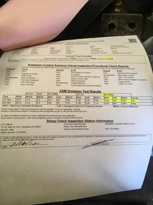

    Just got foxy (82 power ram 50) smoged today and she passed everything but nox! I need help!

    Here are the results
    3,085
    A number of possible causes - a vacuum leak somewhere, the A/F mixture isn't adjusted properly or the EGR system isn't operating properly. There is also a possibility that the plugs are the wrong temp rating, a tuning issue has ramped combustion temperatures or the combustion chambers are carboned up. If your engines cooling system is struggling this will also affect combustion temperatures (all of which increases NOx emissions).
    I have the plugs is says to have the ngk plugs it has a brand new no jet valve head, head studs new head, intake and exhaust gaskets. New fuel filter, lines and new gas. New water pump fan clutch, 160* thermostat. It runs cool now. Had many problems with it overheating hence new head. Now it dosent overheat but won't pass.
    Gonna try to clean the egr and recheck for vacume lines. But none of that got replaced or messed with.
