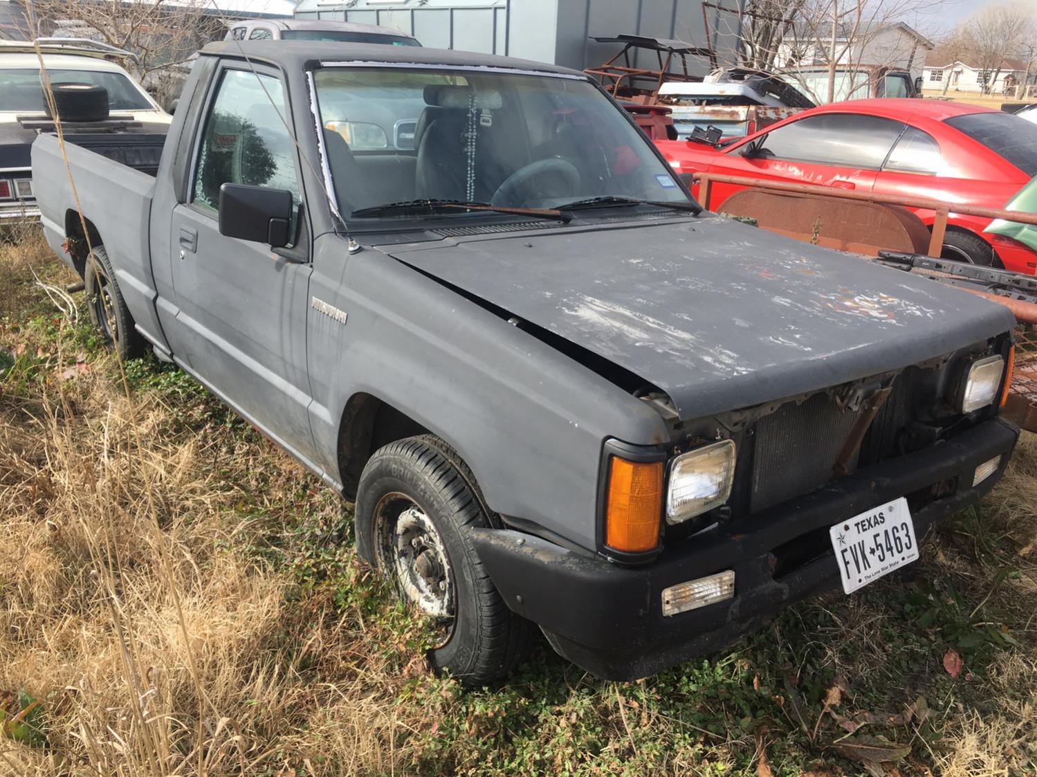

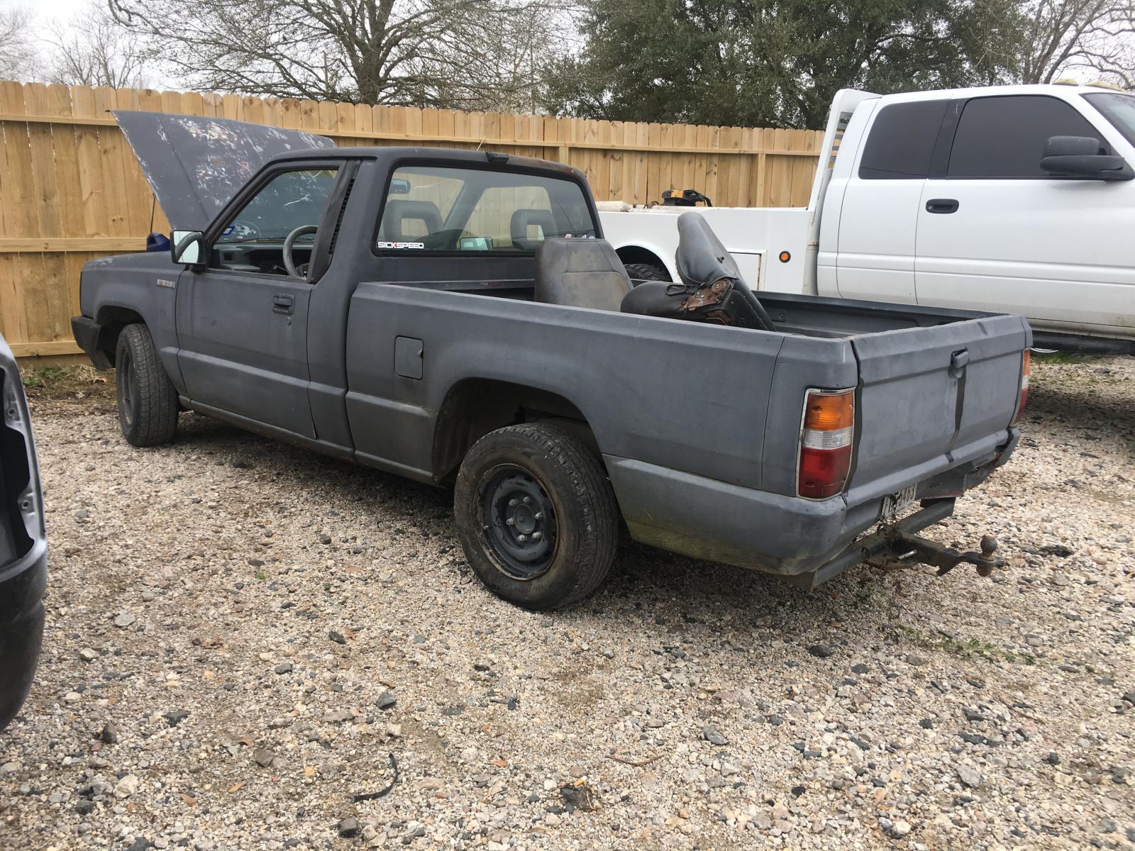

    here she is, i have her in the back of my shop, im currently working on one of my other trucks and cant have 2 of my toys taking up customer real-estate lol.
    she aint pretty, but she runs and drives and the body is straight and the interior is in good shape
    A grille and a straight front bar, it'll be road ready. Even the tires look like they've got plenty of meat on them. Wonder what plans the PO had lined up...

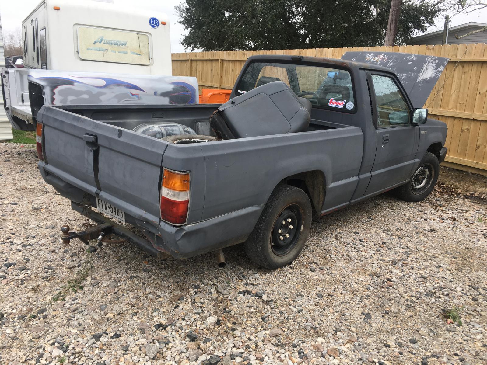

    brought the ole max up to the front of the shop and messed with it for a little bit, only damage is the rear pass side quarter on the bed but thats an easy fix, drove a few laps around the block at the shop and then pulled it up and started doing a tune up on her and after a plug swap she started running pretty good and then ran out of gas, lol, so thats where i stopped...
    and the stuff running down the tailgate is penetrating oil to make the tailgate open and shut better

    thanks for posting the pics
    1,267
    Indeed, thanks for posting the photos. We're always asking for photos, but I wonder if we thank people enough when they DO post.
    You might do well to access the tailgate hardware by removing the panel in the tailgate...if the screws aren't too rusty.

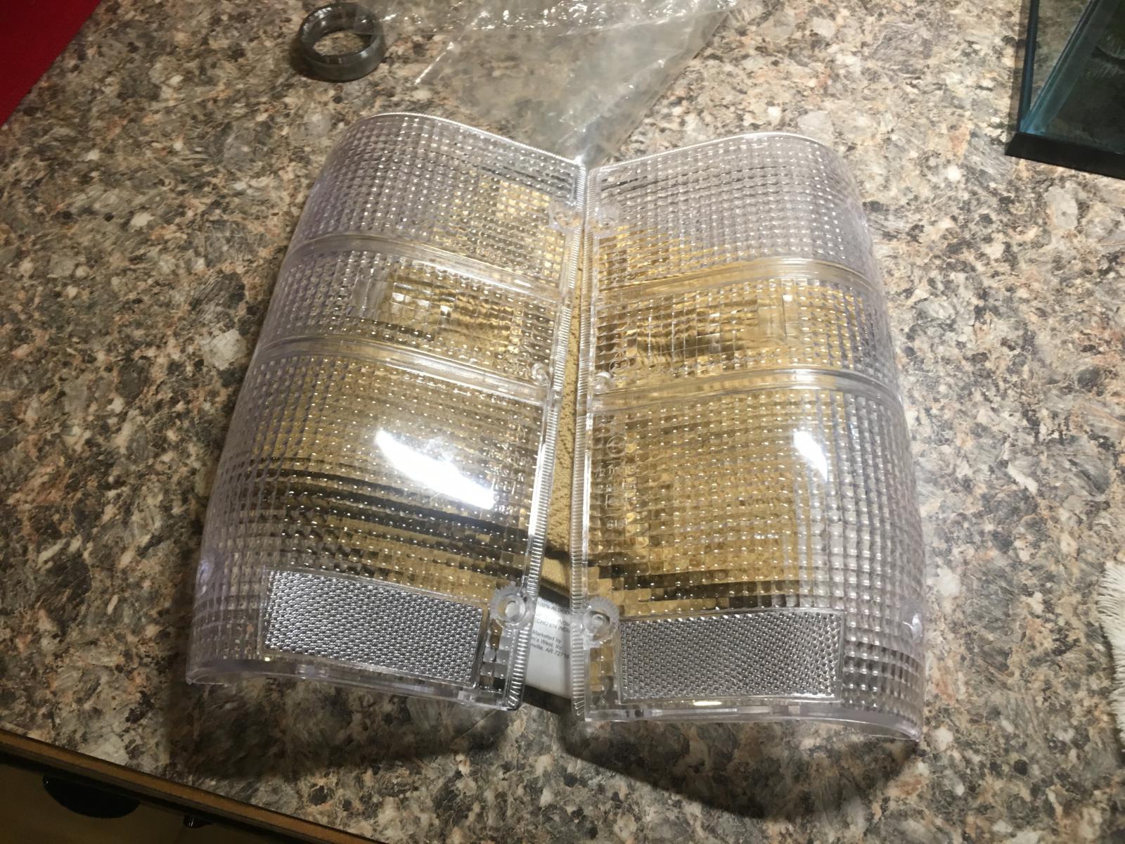

    my clear lenses came in!
    1,267
    Always a great day when your parts arrive
    put a good coat of clear on them to prevent them from hazing out
