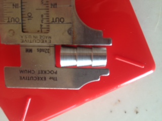

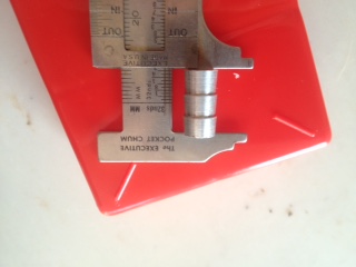

    And the 32/36 Weber kit came with a aluminum barbed plug for the rearward manifold vacuum port? The vertical one? Next to the heater hose?
    The black wire/white stripe fuel cut solenoid wire for the Mikuni is the wire you need to hook up the electric choke (makes life sooo much easier). You don't want to delete that big vacuum barb on #4 intake runner - you need to have that brake booster hooked up or your brakes are going to really suck (worse than they already do). Normally the install instructions for the Weber carb are good You will need to block off the coolant barb to the carb - off the shelf brass barbs are available and will tidy up the coolant hose situation (if you have the less common electric choke Mikuni carb then this is one thing you won't need to mess with). I have a feeling the heater barb used on 6 cylinder Ford manifolds will do the job as well. Most of the time that coolant T piece barb on the manifold is nearly rotten anyway. I sealed up the coolant port that passes under the carb base into the manifold by tapping a metric thread into it and plugging it up with a grab screw and loctite. It normally doesn't leak but this way it pretty much 'seals the deal' so to speak.

    never seen one like that in a weber kit. Not sure why you would need it.

    In the weber distructions under universal disassembly Step #10 stateslug the water choke hose on the rear tee of the intake manifold with the supplied 8mm barb? I dont think i have a tee. Just got her running and went for a test drive to the beer store. Boy those new plugs dont look so new anymore. I bled the brakes but it didnt fix the spongyness. Any ideas for brake upgrades.
    Nup, haven't seen a barb like that ever (not without a NPT thread on the end of it). Was your Mikuni electric choked? 95% of the Mikuni carbs that members have grief with are wax pellet/water choked carbs, we don't see very many Mikunis with an electric choke on them. As for brakes, Gen 2 assemblies are a nut and bolt swap. Take the whole steering hub - hub/spindle, brake rotor & caliper + brake hose. You can go up to twin piston calipers but you'll need the calipers off a Montero Sport. If you only take the rotor and caliper off the Gen 2, the caliper will foul the arm where the tie rod bolts up to. Your master cylinder might be (and probably is) tired. Next question - did you go to a reputable dealer for your Weber? If you got it in a Redline/Weber box it's the real deal. The fakes are garbage and can't be tuned (I mean there is no amount of jetting or adjusting that can be done to get it to run properly)
