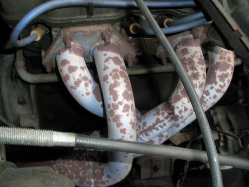

RIMG1048.jpgThese yeah? mind the rust, ist been about 5 years since ive pulled them out and painted them.
these are the Pacemakers
My local has a few spare il ask if you like.

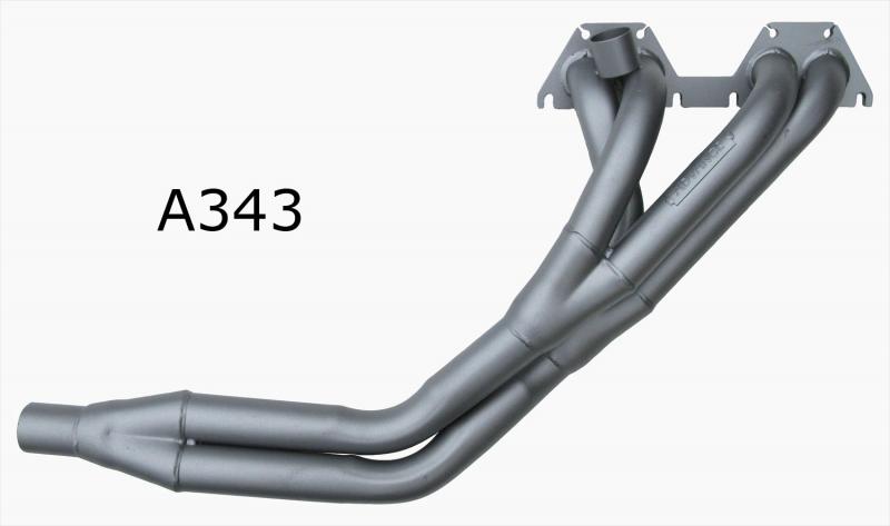

Heres another set, seem pretty cheap but ive never used themhttp://www.ebay.com.au/itm/Mitsubish...item2a22d39efc

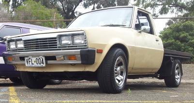

This is my daily slut

Now thats a header worthy of using - its a copy of the doug thorley tri-y for the 2.0 paired port. too bad the shipping is probably more than the header - i'm sure he won't ship it to the US for that price.

Sorry to resurrect an old thread but a vendor on eBay said he could get paired port Aussie "extractors" to the US for about $300 shipped. Has anyone tried these on a 2.0 or 2.6? I wonder if the stock header even that restrictive and if this is a worthwhile part to try.

I need a set of headers for my 2.4L MM since mine are cracked. I am interested tho. You say the seller will ship to US for USD$300? (since he's an AU seller on AUeBay) I can't do it yet but I'd like to soon.
So why would you buy one from Australia, have it shipped to here, and hope the quality is up to your standard? Just from the picture I can see they used a plasma cutter on the header plate, they used a pipe bender to make the bends, and mig welded it. There not a mandrel bend, you can see the deformation. Is it port matched to the gasket? At least with the ones we have had built for the board. You have some kind idea of what you will get. It also looks like they used the same size pipe at the end. so thats already to small.

"Stage 1: Mild steel with formed collectors for $500.00, plus s&h (as pictured in previous thread)."
That's why. $300 shipped and direct bolt on for those. With the first ones I'd need to drive it to a muffler shop with an open header to have the exhaust flanges and such welded to it. I'm selling the truck when my diesel is finished I'd prefer to have the exhaust leak fixed. If I intended to keep it I'd be after the forum headers. Plus it's not my only truck, I've got to repair multiple vehicles. I've wanted exhaust for my sentra for years which is about $660. Just over what those headers cost and that car takes priority since it's my daily. Working on a budget :p
Well why didn't you say you were going to sell it. I was thinking you were doing a full build truck. You should just weld up the cracks and a new gasket. If it's the stock manifold mig it with argon and it will be fine. You can stop drill the cracks and it will last for years. Or tell you sell it.
