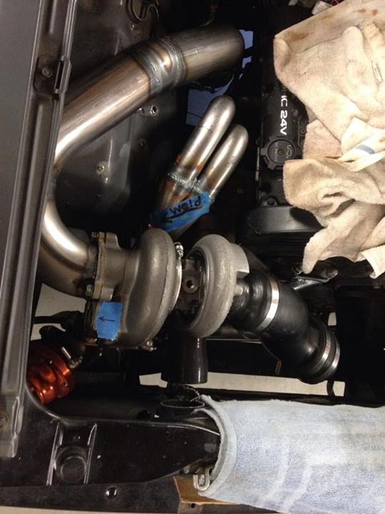

Used Montero 3.5 water pump and pipes, custom fab on the one on the back of the heads. Note the CAS will interfere with the firewall where it is. I'd recommend doing this swap with a 93+ engine if I had to start it over again... but I have a plan.

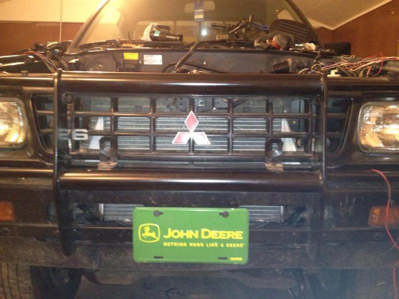

Sitting in the truck...

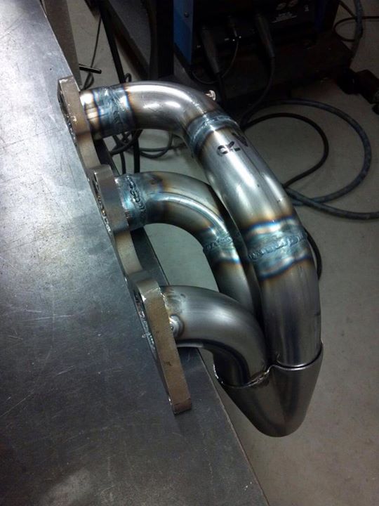

I'm currently sorting out using the 3000gt power steering and AC compressor. I'm also looking at a single turbo instead of the twins, purely for easier fab. I'm trying to keep the power level near stock, I'm not sure how strong the stock transmission is...
