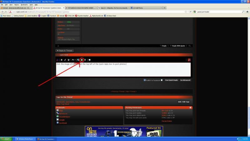

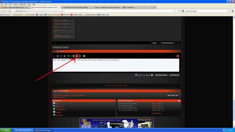

    I'm sorry, im just not used to the not being able to edit my posts after I post them, as it used to be, I guess I should donate anyway. But What I meant was the DFAV is not really a true Weber, The 32/36 is the barrel sizes, 32 primary, 36 secondary. Yes, the Ebay carb is the correct carb, it has an auto linkage on it. Uploading pictures isn't to hard, just when you are in quick reply, click the at the top right of the box, and you can either upload an image from your PC or from the internet. I use the theme Velocity (Which you can choose at the bottom left of the page in the click down menu that says "Light Theme"). I use it because it is not as bright and hard to read like "Light Theme" is.
    03-29-2011
    352
    Payette, ID
    Click the image of the tree at the top left of the Quick reply box to post photos.
