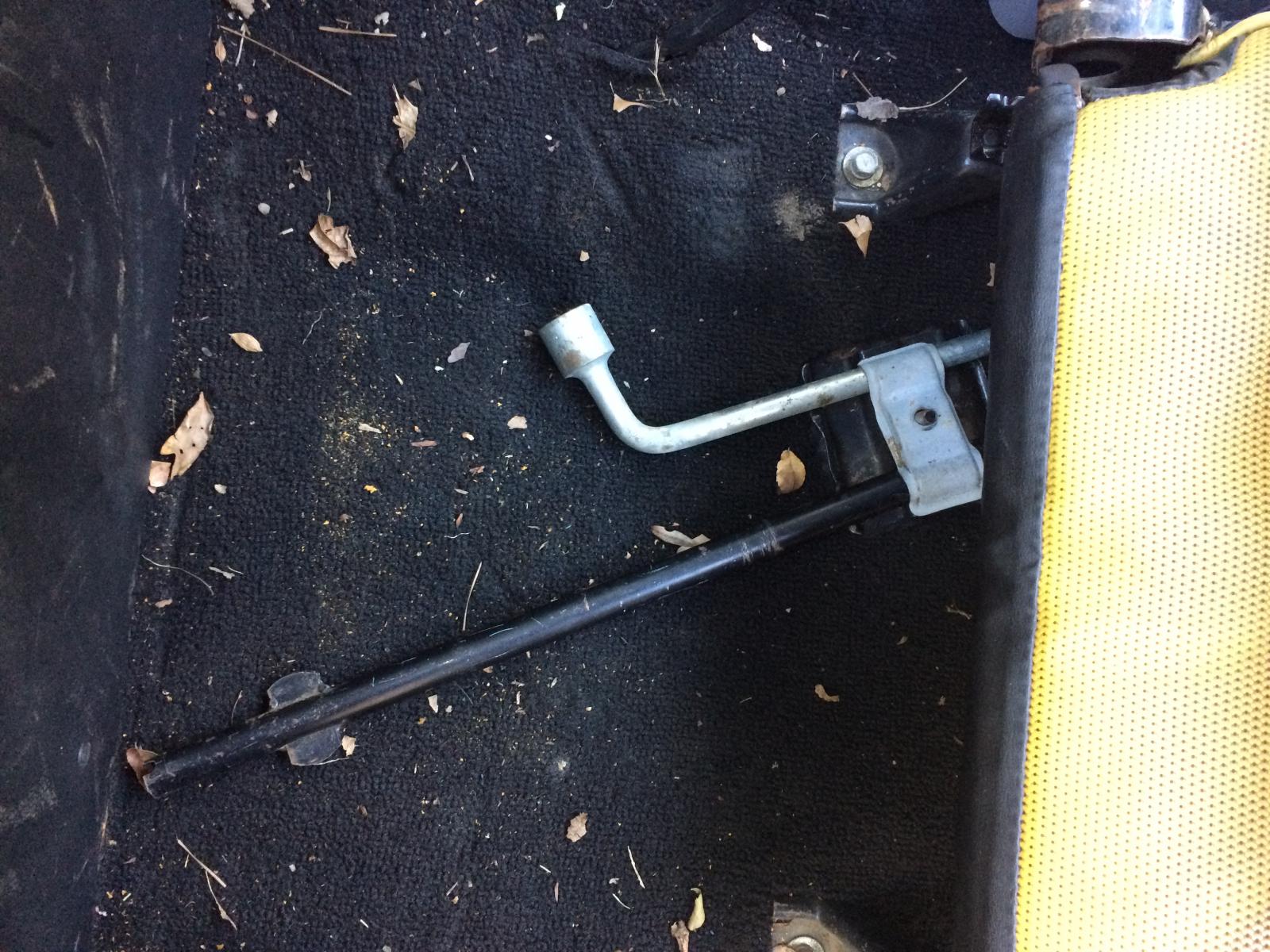

    IMG_4430[1].jpgthis is the jack handle and the spare tire removal tool in place, passenger side, rear of the cab at left.

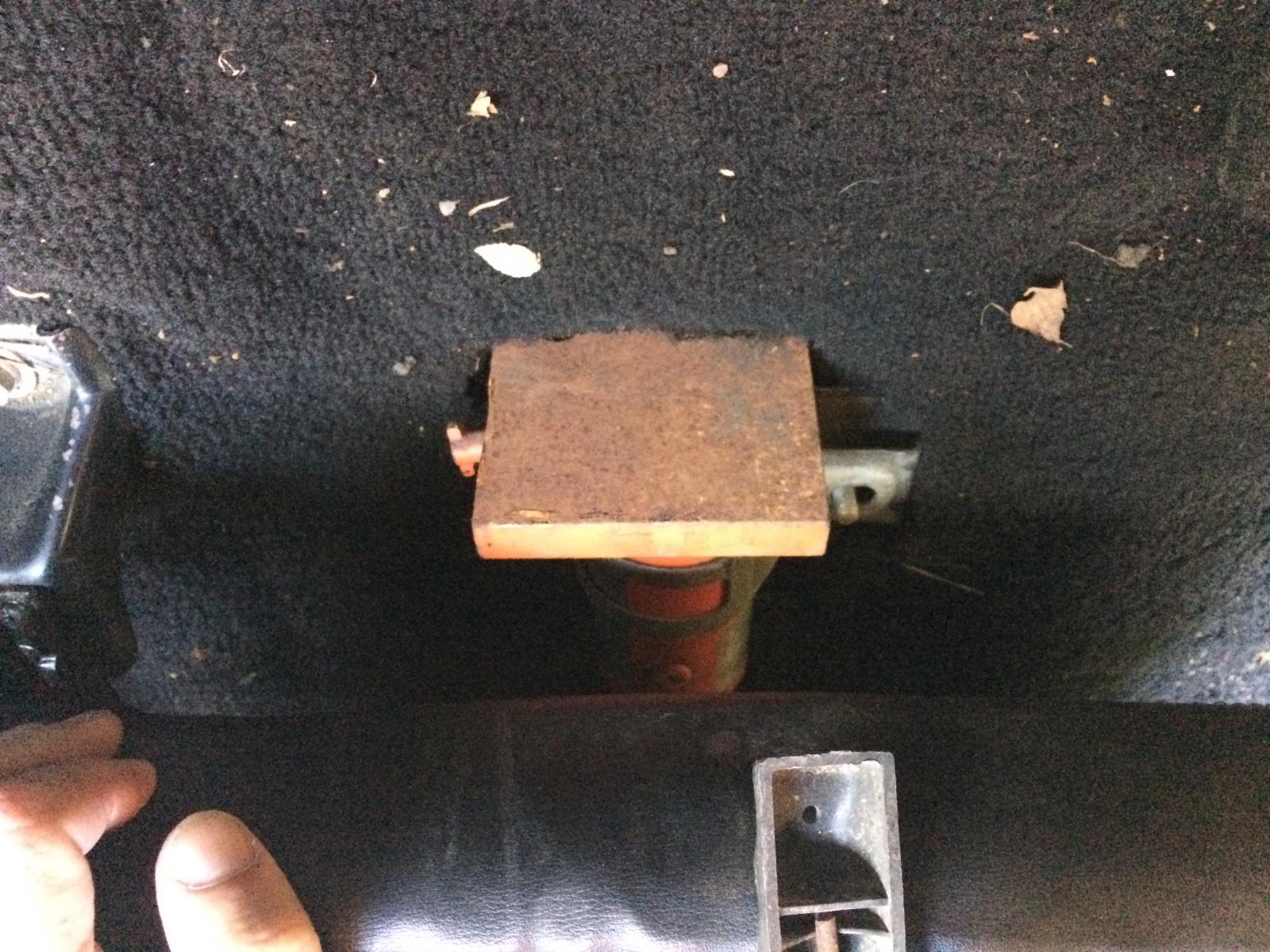

    IMG_4431[1].jpgthis is the base of the bottle jack as seen from behind the rear of the drivers seat. I cant get a better pic without removing the seat as it is slid all the way forward in this shot. bottom of the pic is actually up
    10-29-2014
    1,261
    Earth, the Solar System
    Thanks. By what I can see there is a metal strap that holds the jack in place which I am missing along with its wingnut and I don't have the black rod I assume is the jack tool.
    07-08-2017
    118
    Cataula , GA
    the black rod is indeed the tool to get the spare out and also the jack interface tool. the bottle jack does have a metal strap.

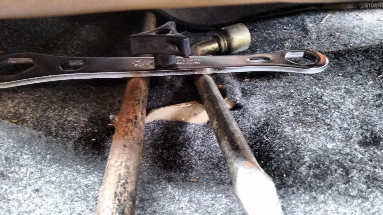

    Just had a dig though my detritus and found that lawn mower handle bolts/IMG_20171222_135527452.jpgIMG_20171222_135527452.jpgknobs have an M8 1.25 thread.
    Drilled a hole though a tow ball nut wrench I got for $1 for the strap
    The lawnmower knobs are probably a nice solution if yours are missing, readily available and nice and thick to grab under the seats
