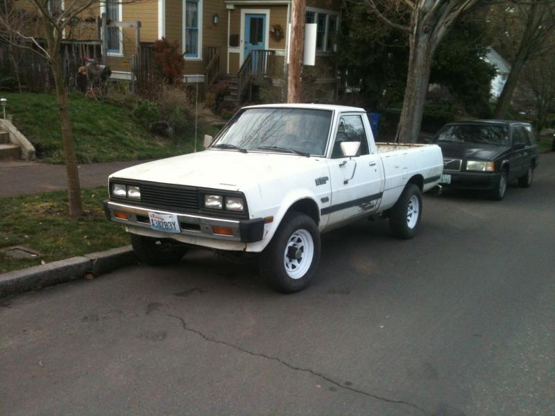

    Here is a pic of my ride as it is today. Nothing pretty to look at.
    Body Lift? Can the #3023 kit be put on the older body style or at least adapted?
    http://www.ebay.com/itm/PA-3-Body-Li...4d8e96&vxp=mtr
    Thanks Again
    1,271
    I disagree: it's a strong survivor with a spirited stance. And a lotta good potential.
