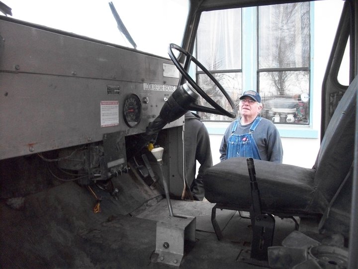

    Some Pictures

    Well, the Jeeps home is at the post office, but here is a pic I found on the internet.
