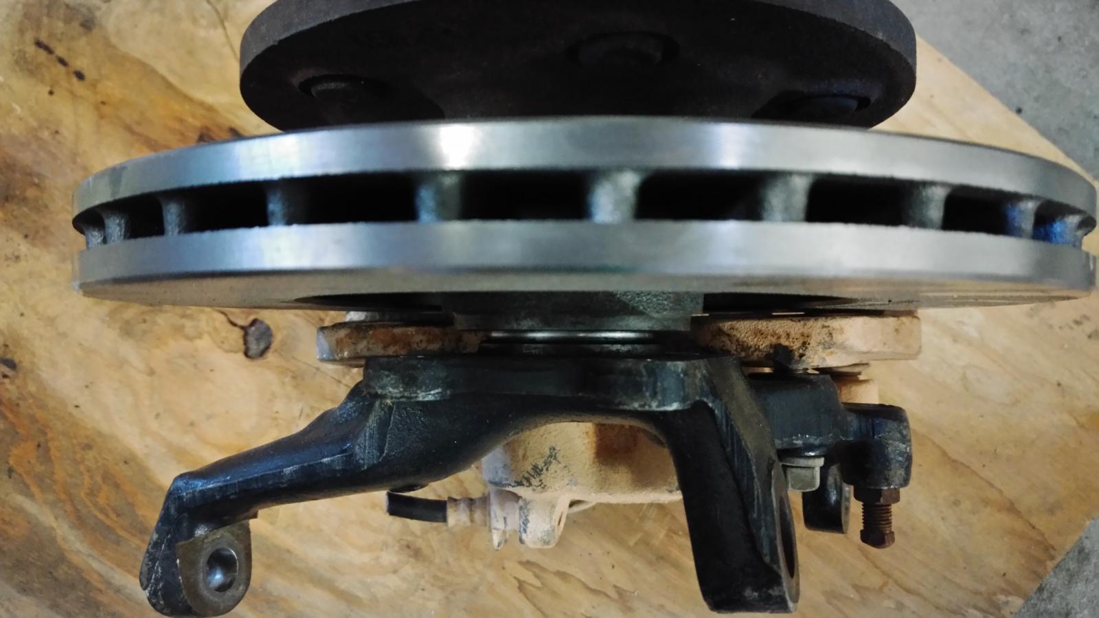

    I'm in the process of doing this right now for my project and I can tell you, the Montero calipers will line up perfectly to the mount holes on a 1g hub with the 2g rotors. you do need to grind a little bit of the caliper off to make it fit right. another thing you have to consider is running a bigger wheel the 2 piston calipers are huge compared to the single piston calipers count on running at least a 16" rim I'd think.
    It hits right here.
    You'll also need to either get a bolt with a shorter height or grind into the steering arm on the hub.

    I'm gonna do a write up this weekend when I take this 2g MM apart to swap the hubs Geezer. I don't fully understand why Mitsubishi changed the design on the 2g knuckle though. I mean the caliper is no where near anything for it to hit. Doesn't make sense to me. but Ill find out this weekend.

    So I took the plunge and bought a pair of Gen 2 steering hubs and rotors for my Gen 1 brake upgrade. And I can confirm to all that have and will ask this question - yes, the Gen 2 caliper bolt holes are the same distance apart and threads/bolts are the same but are 'clocked' on an angle compared to the Gen 1's. I wanted to go the full deal and use twin piston calipers from a Montero (Pajero in Oz) but I wasn't able to find any in the JY but I did make an unexpected discovery. I noticed a pair of twin pistons on a 1998-2000 4WD Mitsubishi Challenger and decided to try out the fitment on the Gen 2 steering hubs - and they bolted up perfectly. I think the calipers are intended for a bigger rotor but they'll work (unless I can find a rotor to match them). Added note - the Gen 1 and Gen 2 geometries are the same (215mm high from ball joint to ball joint - 135 mm from centre of the bottom ball joint hole to centre of the tie rod end hole)

    Instead of the bolt holes running parallel to where the ball joints align with each other, the top caliper bolt hole is directly in line with the ball joints while the bottom bolt hole is located more off to one side. The calipers' relation to the disc is still the same but now it is further up and away from the steering arm end. Put it simply - Gen 2 steering hub assemblies are a nut and bolt swap not needing any modifications. You could use the whole steering hub and brake set up as the floating caliper is an improvement over the fixed caliper on the Gen 1, but due to improved clearance of the Gen 2 design, twin pistons will mount up with the only mod (that I have seen so far...) is bending or maybe notching the backing plates a little.

    Ouch Roy, that one stung a bit I haven't lost any further digits of late, I sorta more grind them down... And I did mean clocked. Gen 1 brakes mounts holes are at a '12 to 6' relation, while the Gen 2 brake mount holes are more '11 to 5'. Get your Gen 1 brakes fixed folks for cheaps! Better than using the back of a Semi
