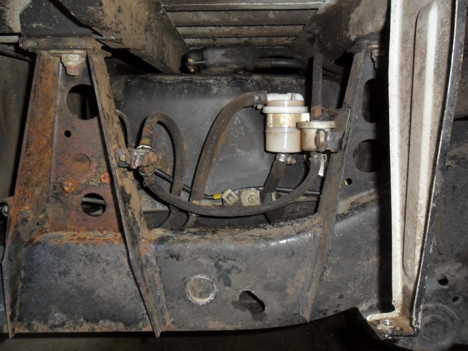

    I have the skirt off, I am unsure of what the FSM is showing me. I can tell the fuel supply because I installed that filter. I am unsure of the return line. I am thinking it is the line coming from the left then up to that valve which is closer to us and to the right of the filter in the picture. If that is it do you guys plug it on top of the tank or ??
    That little plastic canister next to the fuel filter is part of the tank breather system (don't mess with it - bad things will happen) There's 2 lines tapped out from the tank below the tank halves seam line. The one below the fuel pick up connection is the return line. Luckily I have a spare tank sitting out next to my truck that I could visually refer to lol.
