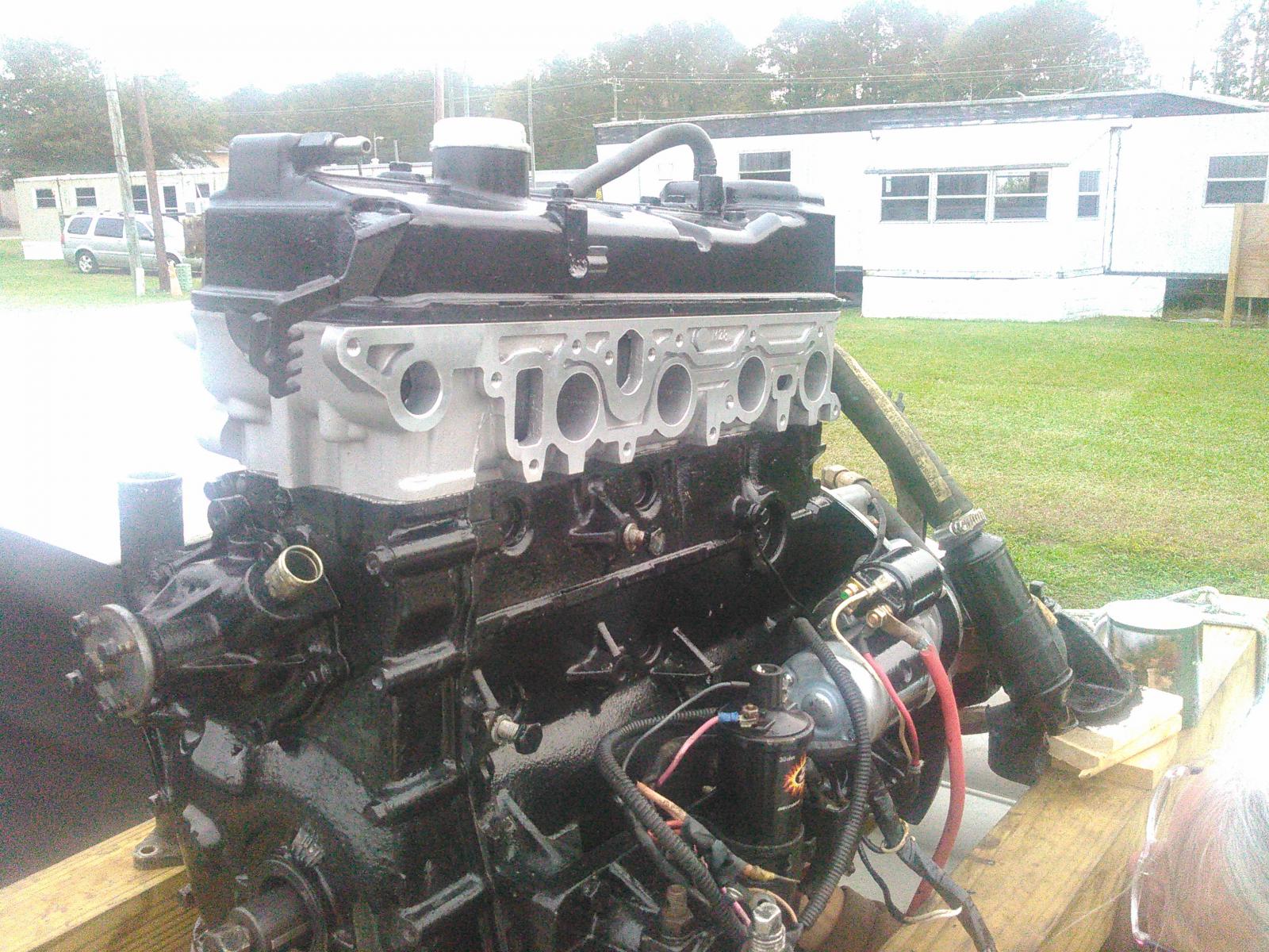

    Here are pics of the new head...
    All mechanical, non jet valve head - perfect for chasing HP. Has it been ported? Those inlet ports look cavernous!

    No, this is the standard new non-jet head. Another stage x rebuild is planned for next year. Yes, this engine is absolutely old school. Distributor, carb, mechanical valves, timing chain and sprockets, no balance shafts and not jet valves. Clean, simple, straightforward and a beautiful design. I added a K&N for good intake sound. I took the dog house (the thing that covers the engine) off. The sound of this thing, running 4 or 5 thousand rpm, two feet behind your head, is like a symphony.
