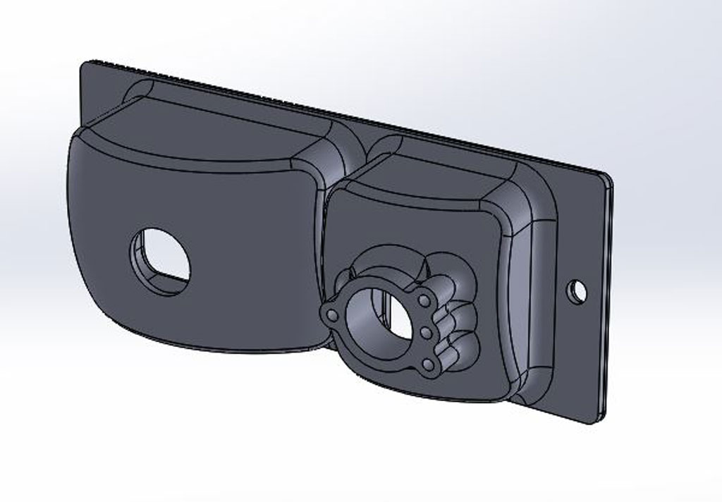

    - Designing and fabricating front bumper lights.

    Front bumper position and turning light redesigned and fabricated in black for testing, the final ones are going to be white..
