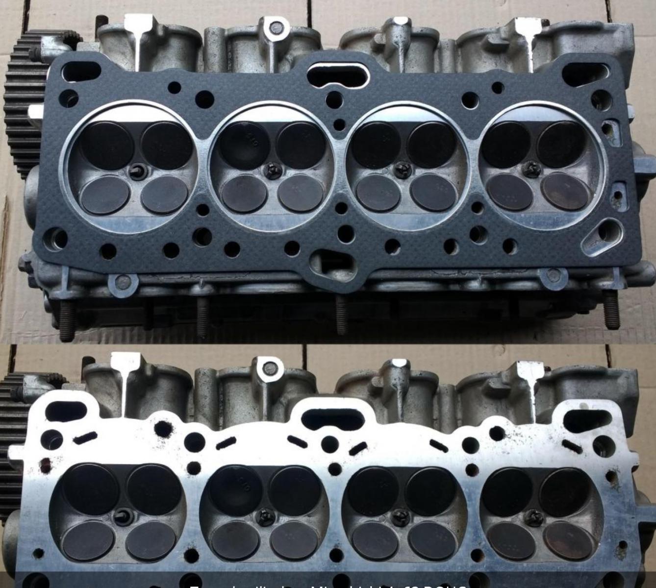

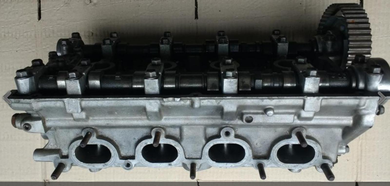

    I've just bought a 4g63 dohc 16v cylinder head! Its in really good condition but it has a few missing parts (Valve cover, one cam gear and cam rockers). Nothing serious, I'm going to complete it as long I'm moving forward through the project.

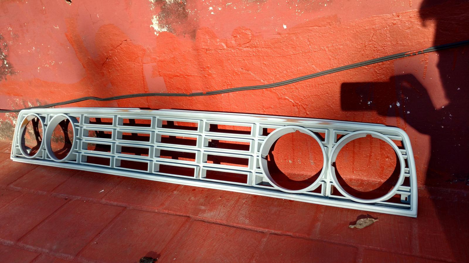

    The front grill is almost finished too! That was a challenge since I had to fully reconstruct it manually and by 3D printing some sections.

    Well, I just wanted to check in and update this thread. Leave you some pics of the head.
    Any recommendations will always be gratefully received.

    Don't worry about the cam gears, you can buy shiny adjustable gears pretty cheap but you really need to know what you're doing with timing adjustments on these heads. The valve timing on 4G63's are critical and one goof will destroy valves and potentially the engine. That being said, the extra cam will get your engine breathing like it has desperately needed it. I'd love to do this conversion but with some big ass 40mm bike carbs and a bespoke set of headers. Mitsubishi did do an old school twin cam engine on PHH carbs but not only are they rare but damned hard to fix if you are unfortunate enough to had a mechanical problem. Don't even mention the HKS aftermarket head unless you have bottomless pockets... Keep us up to date on he swap

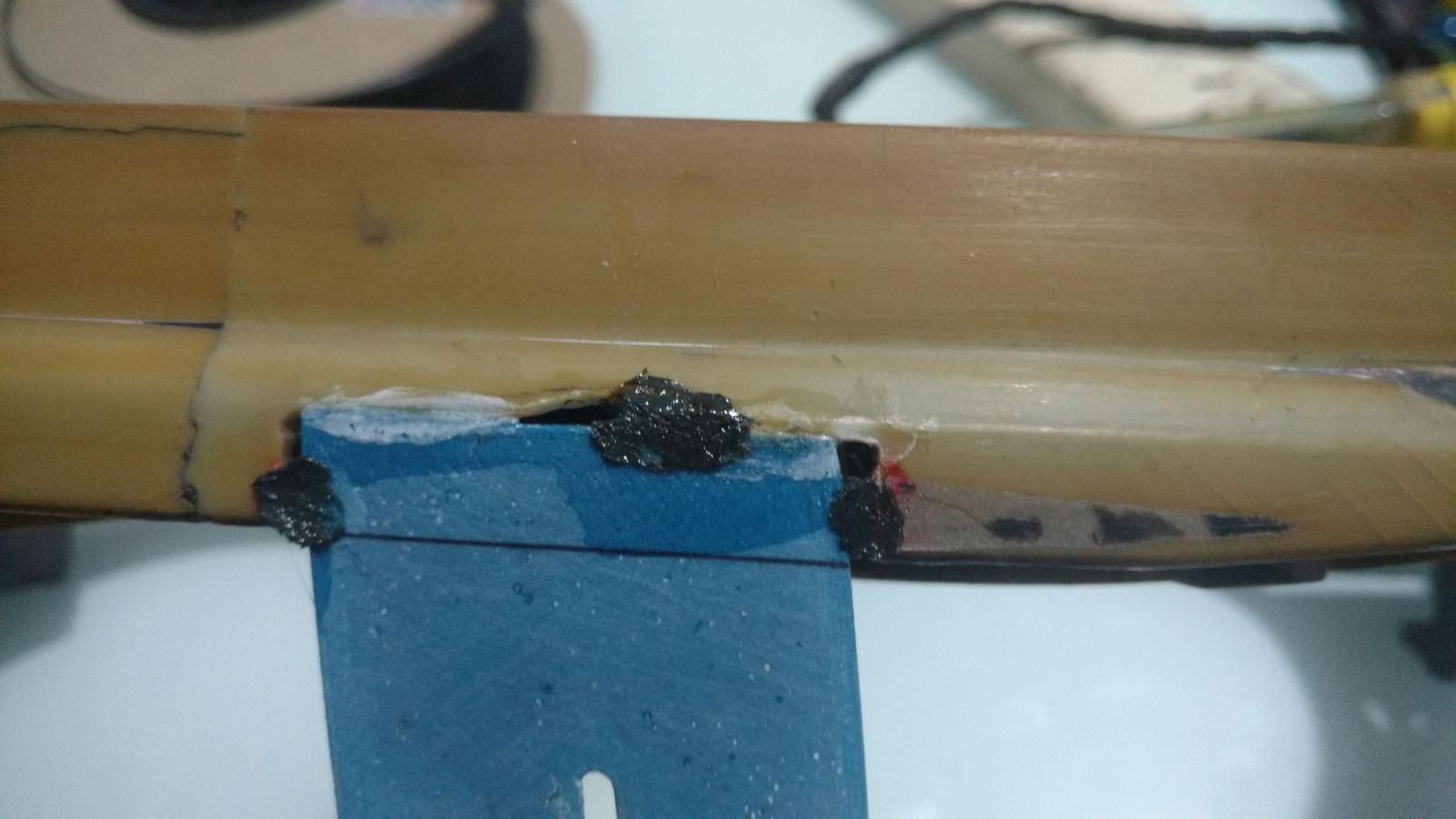

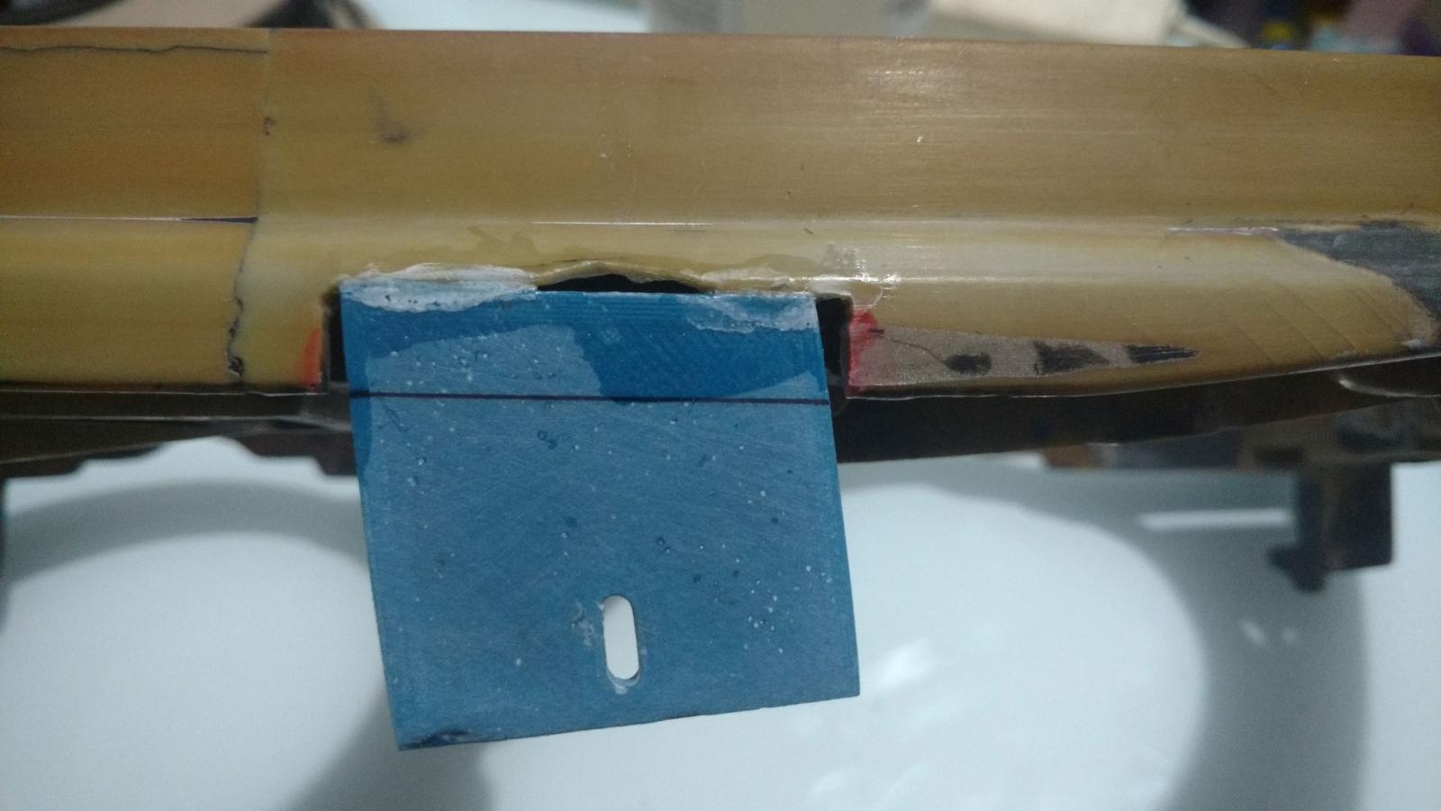

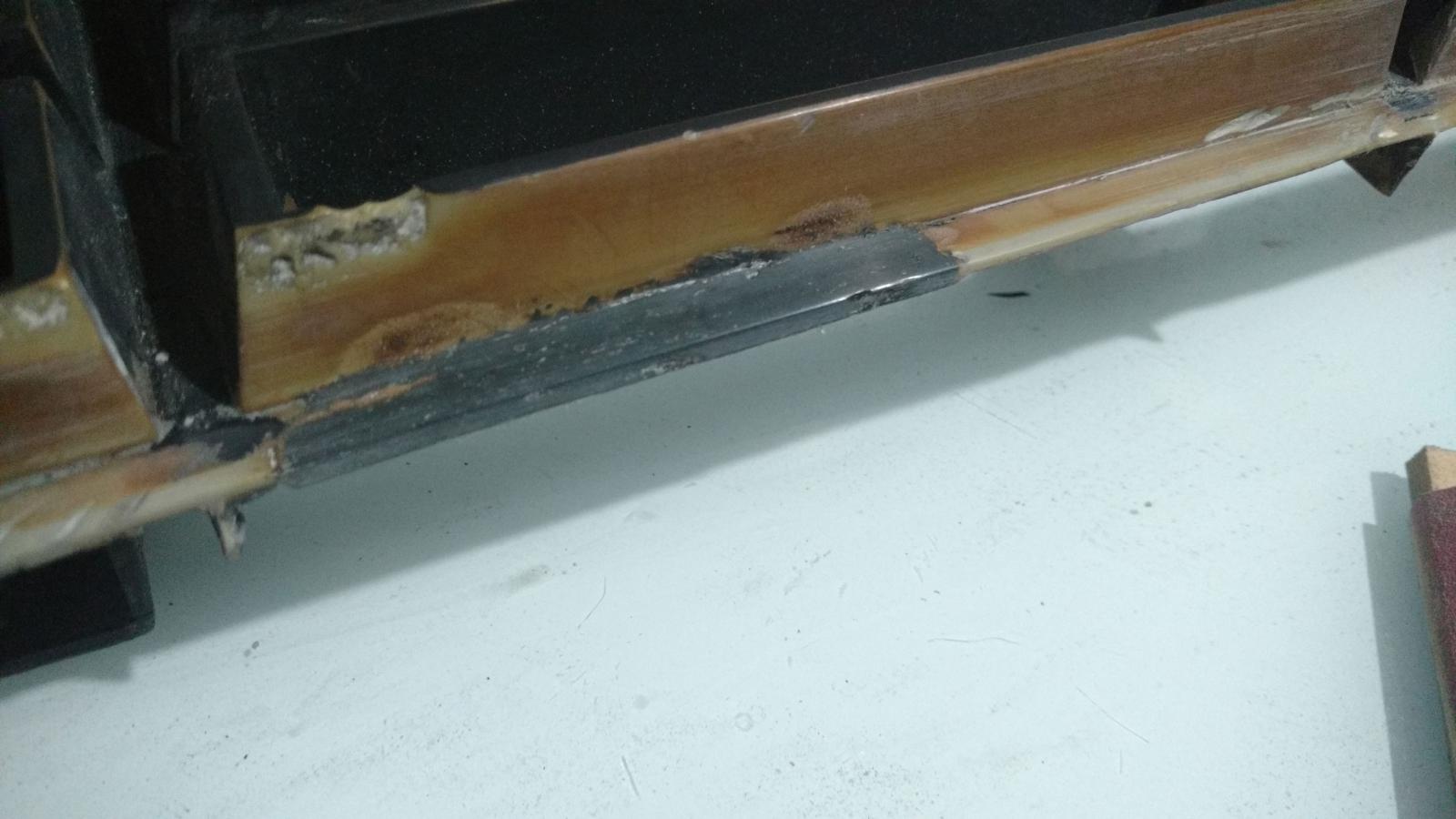

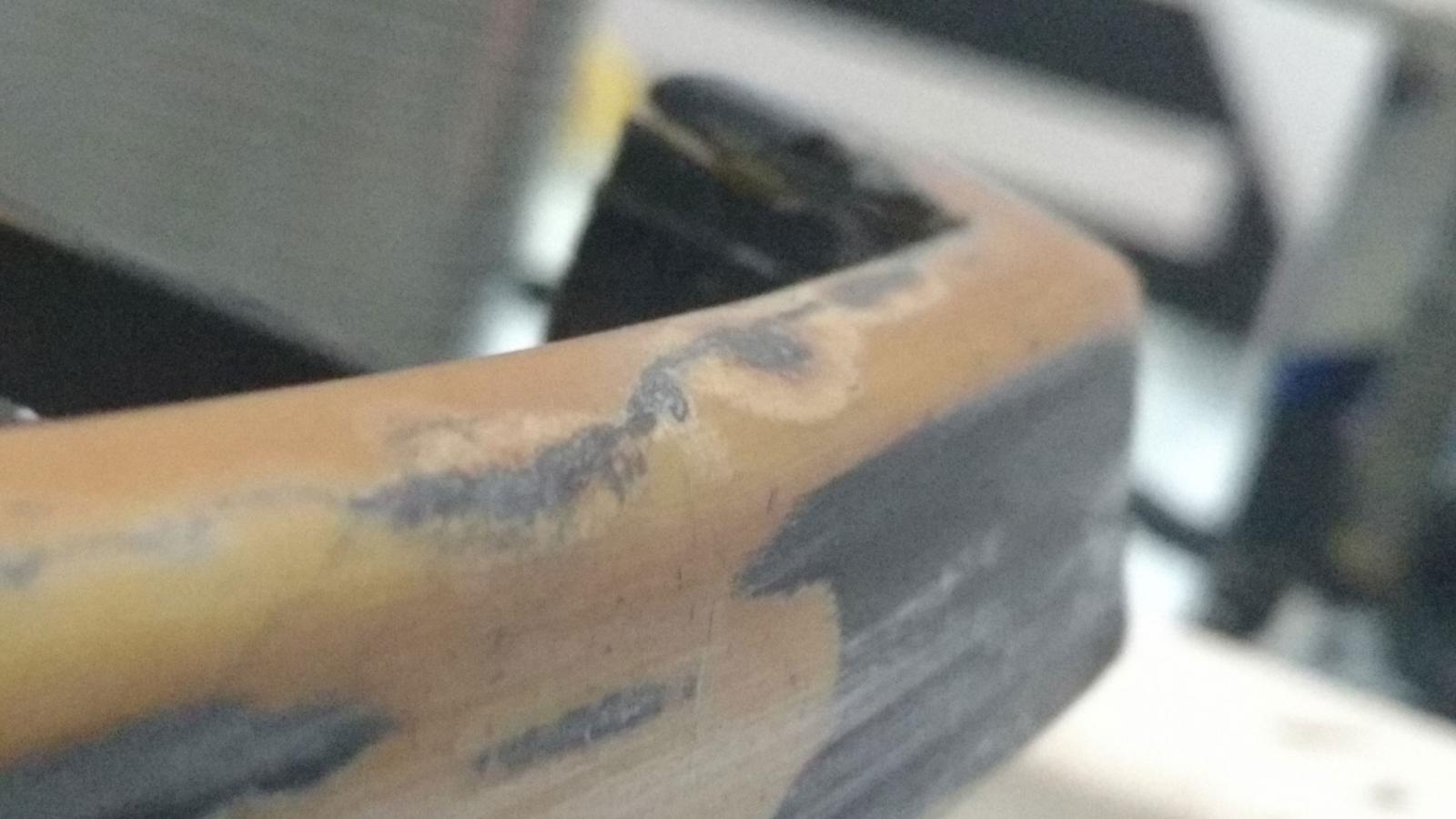

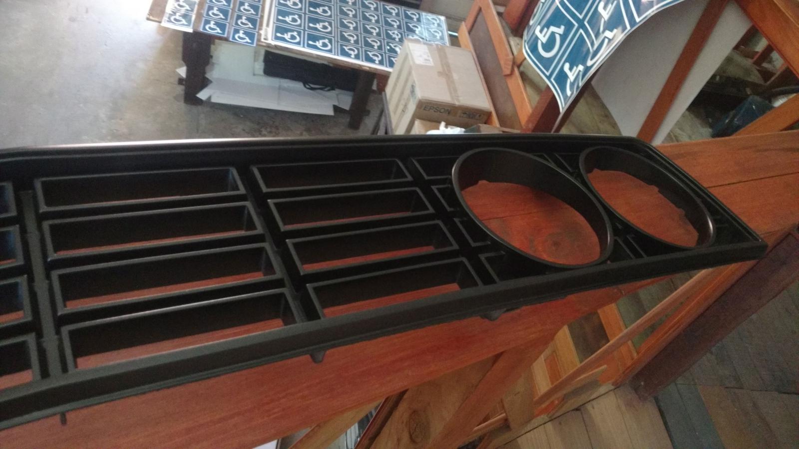

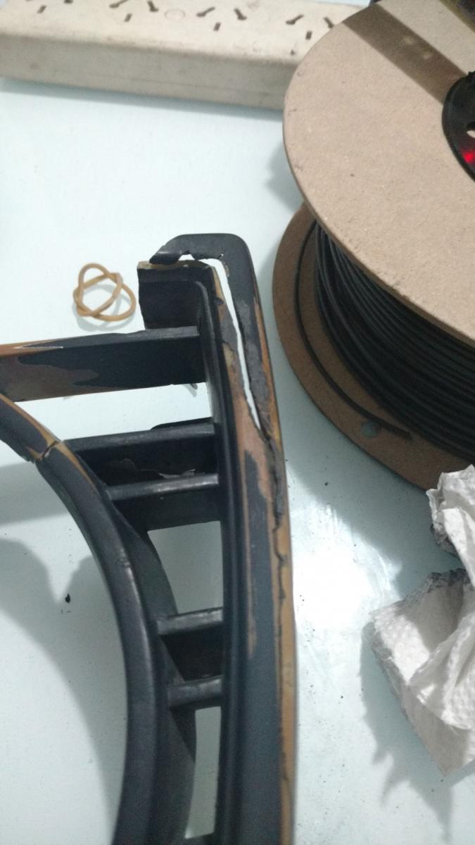

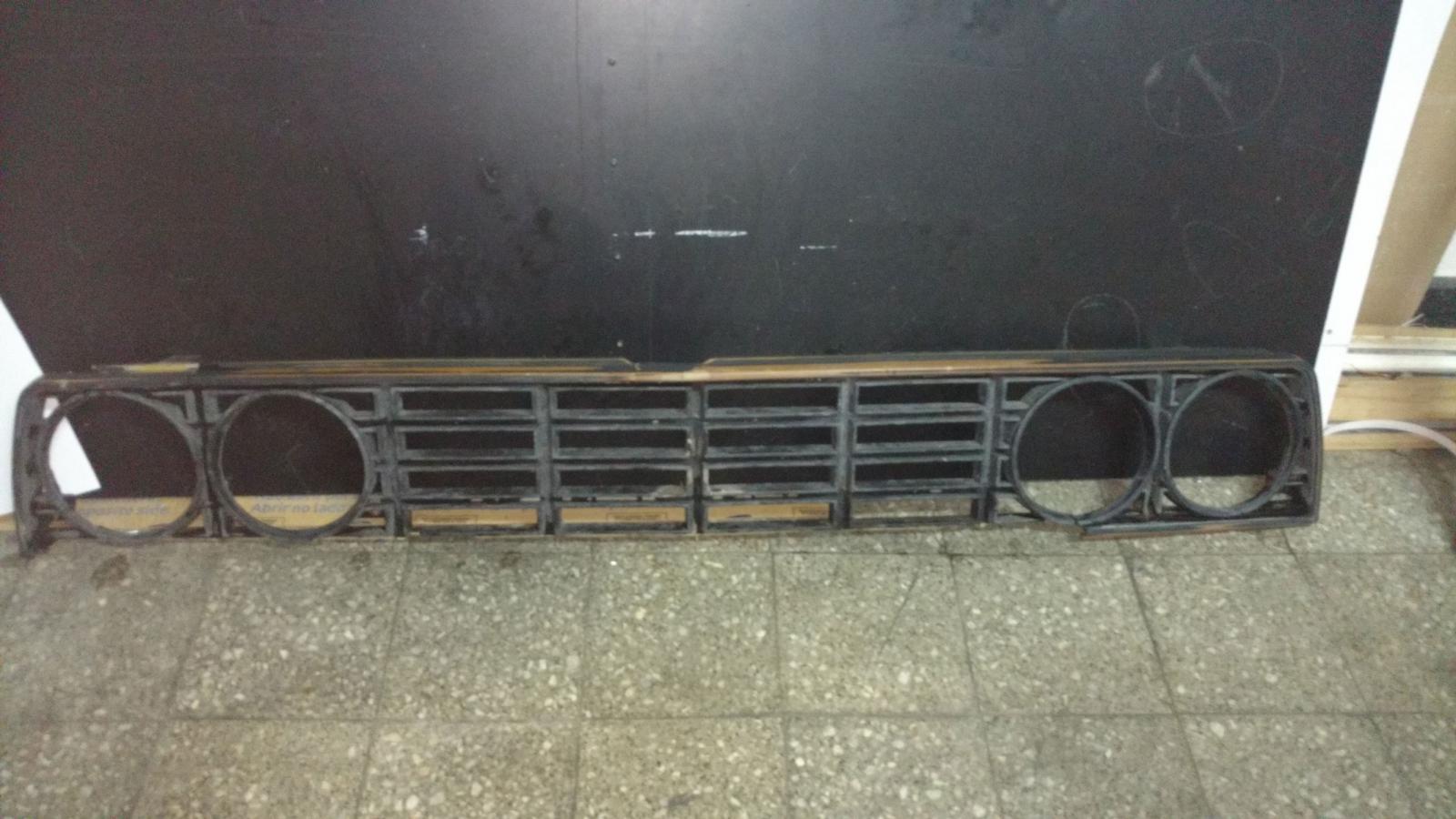

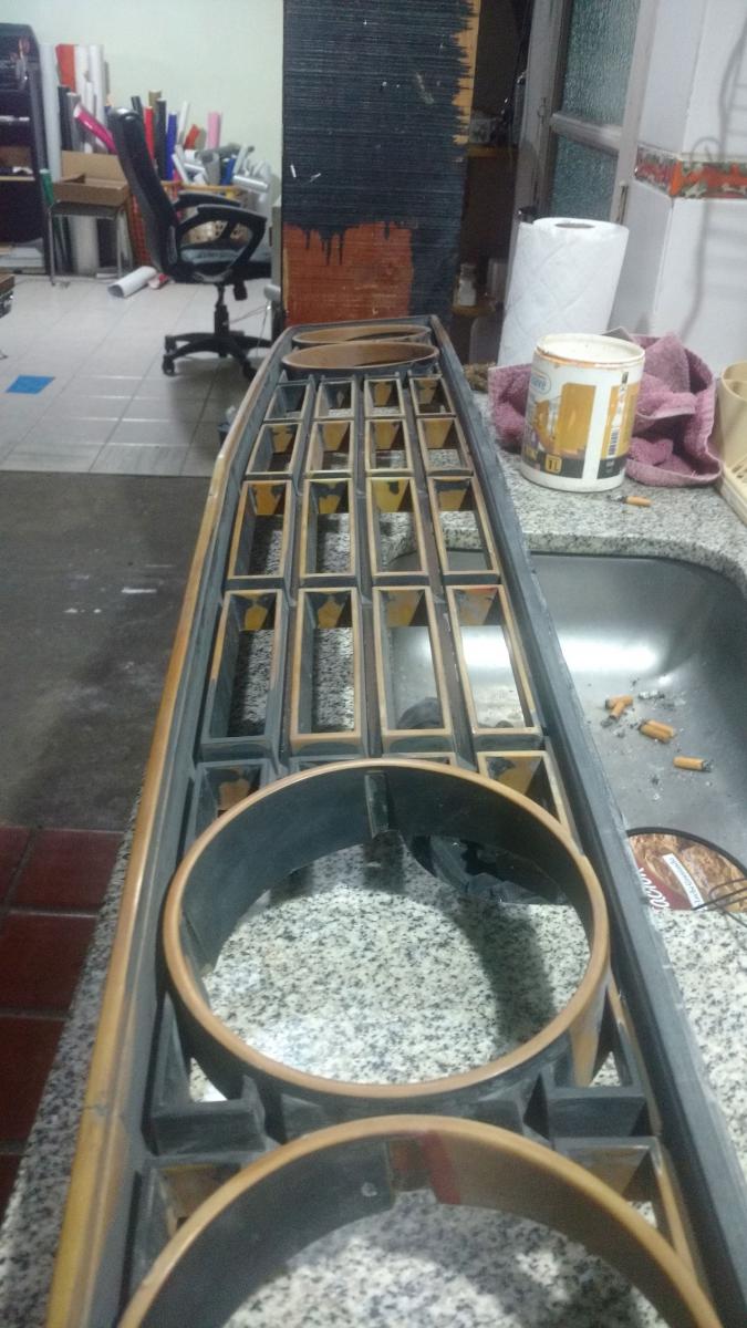

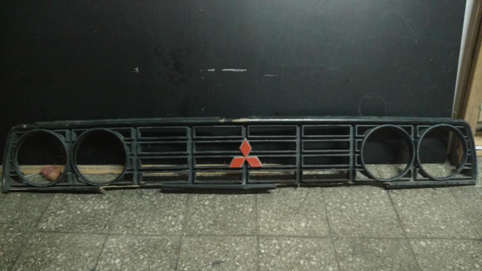

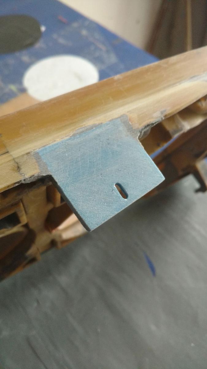

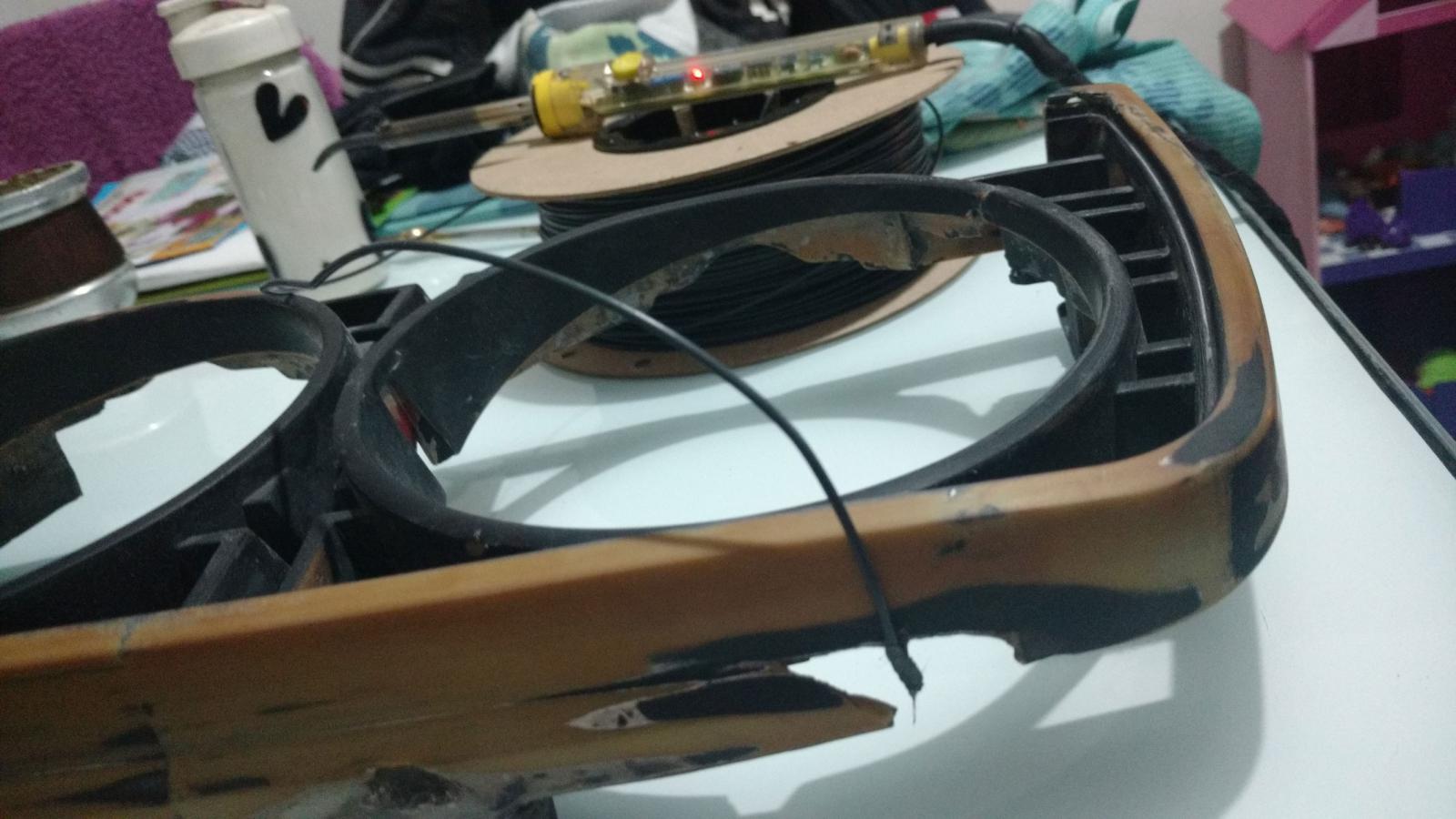

    Good night everyone! Today i recovered the data of my broken smarthphone so i have the grill's restoration process photos and i thought to share them with you, cool people.
    Maybe this could be helpful for those who has the same problem that i had, and is having trouble finding this important piece which almost represent the whole "face" of the truck.
    First with the help of friend who is industrial designer and specializes in 3D printing solutions, i made some tests to find wich kind of plastic i was dealing with.
    For that i had to cut a piece of the grill. We determine that it was ABS or some variety of it (it disolves in acetone, it doesn't float in water and makes an orange flame with really black smoke when you burn it).
    At first the grill was like this:
    As you can see, the lower lip was broken and twisted everywhere... So i cut it off with a dremel tool.
    It had cracks everywhere. This are just some of them.

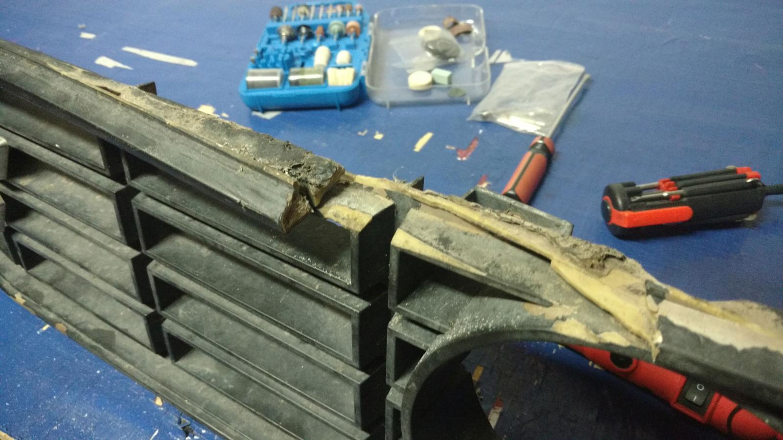

    I sanded all the cracks and cutted al the uneven surfices with the dremel.

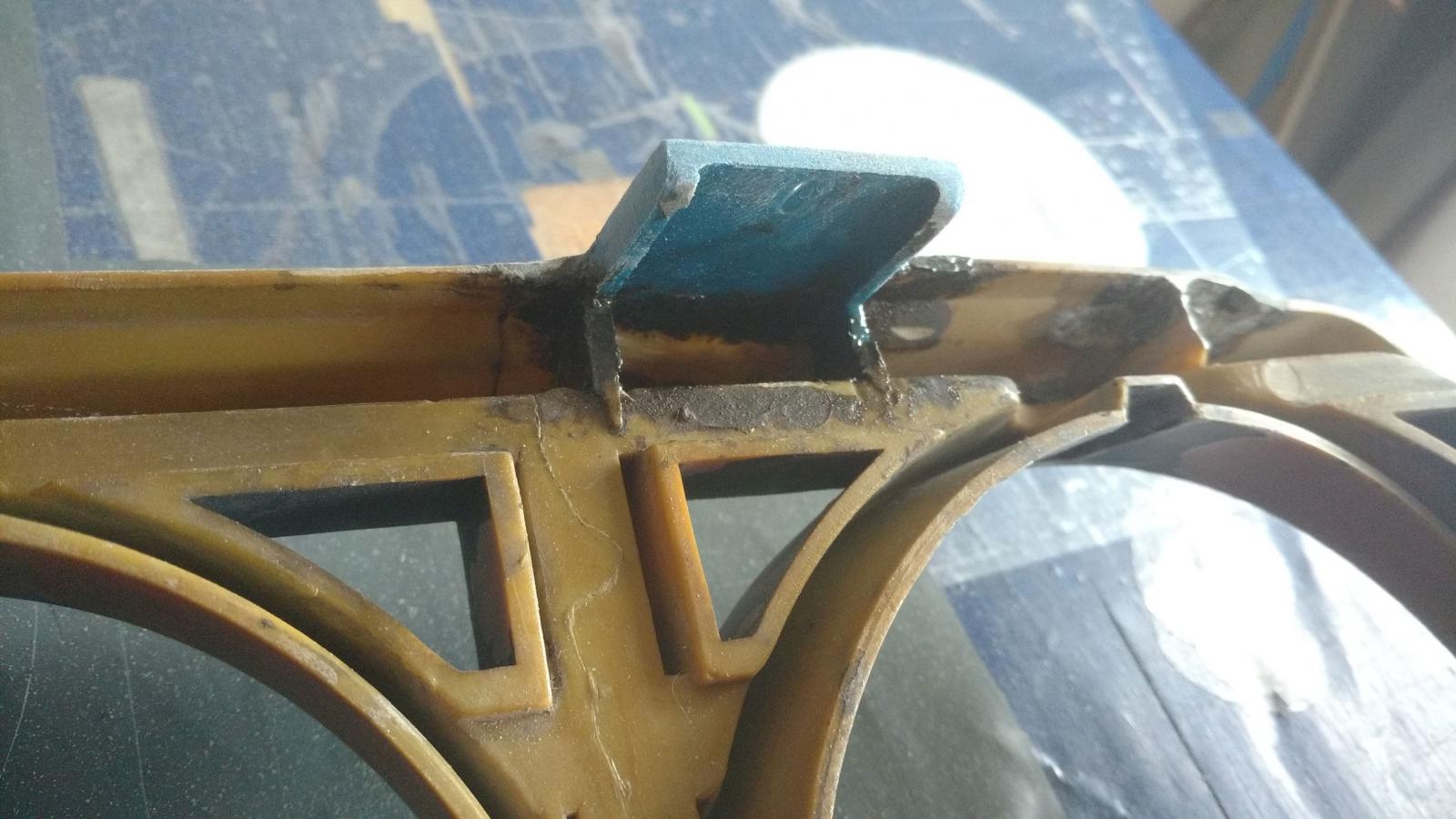

    Then i started soldering all the cracks and filling the smaller missing sections by melting ABS filament with a flat soldering iron.
    Since this is the same, or at least, a very similar material which the one that the grill was fabricated, it fixes really easy and gains great strength, keeping the same flexibility of the rest of the grill, avoiding future breakages.
    When done filling, dry sanded (400 grit), wet sanded (600 grit) to finish.
    More pics for other complicated sections:
    My friend copied, designed and printed the brackets and the lower lip that i'd cutted in the beginning. He did an awesome job.
    Since acetone disolves this plastic you can use as glue for presenting important parts before start welding. Once done, weld and sand.
    Maybe i should done the hole by measuring it in the truck instead of copying the original one... but the truck is 80 km (50 miles) from here so... I decided to take my chances... If it doesn't match i'll correct it later.
    Some of the lower lip:
    All in one piece, with no cracks and all sanded.
    Primer and wet sanded with a 1500 grit sandpaper:
    Painted with one coat of rust oleum trim and bumper matt black, re sanded and painted another coat.
    Well that's all, i hope you guys enjoyed it and find some of this info helpful.

    That is excellent restoration work. I hardly ever see the MA grille'd trucks but the funny thing is they were very popular with farmers and were way more common than the regular 4x6 twin headlight trucks where I am (South Australia). Can't wait to see the grille fitted to your truck

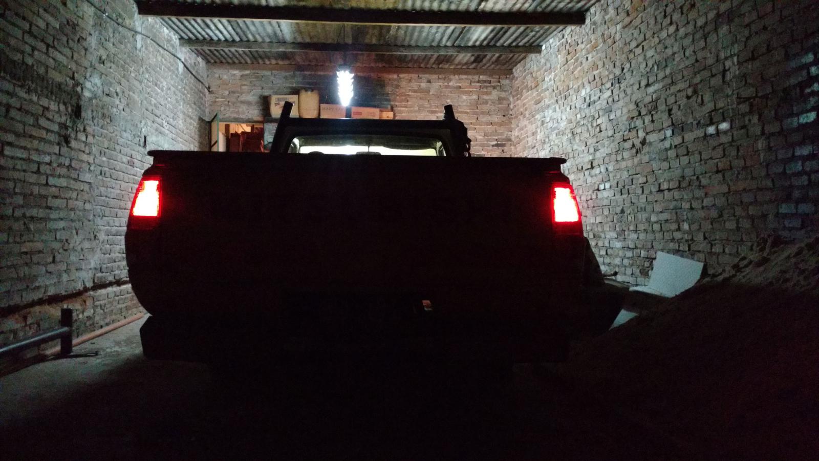

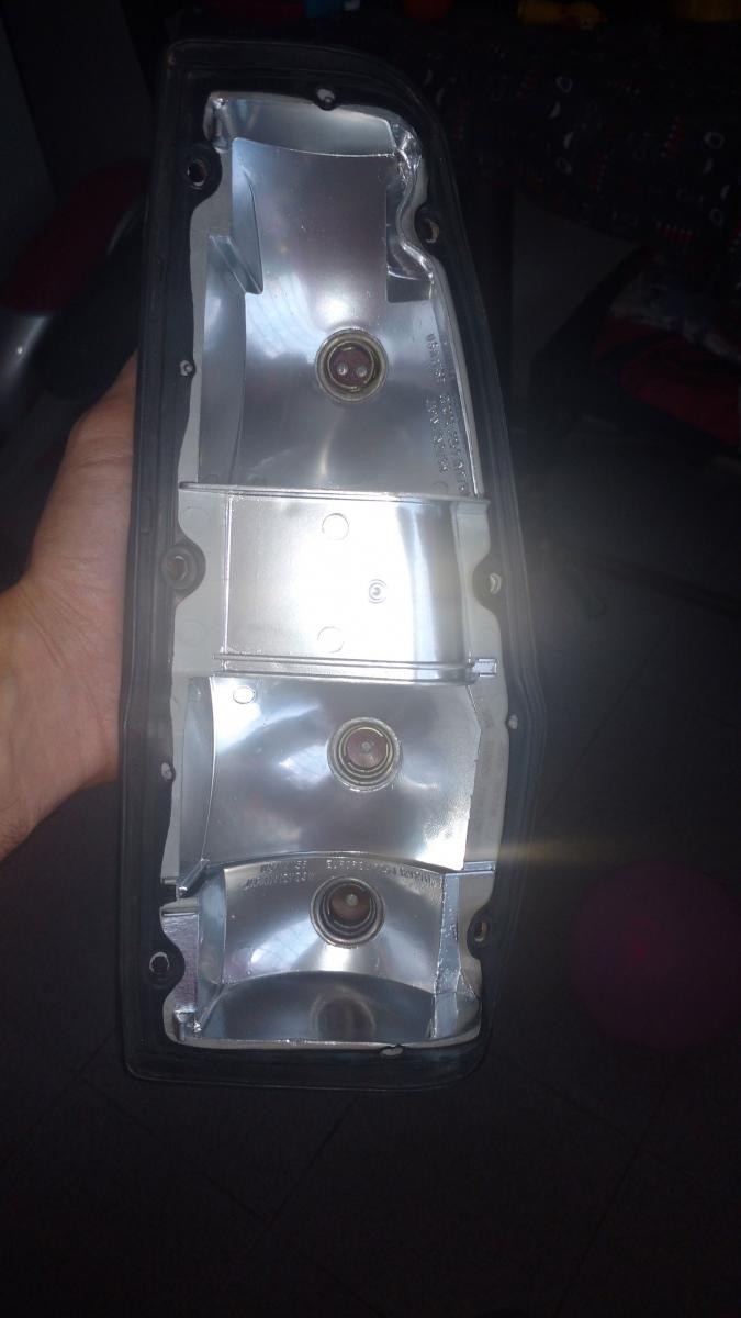

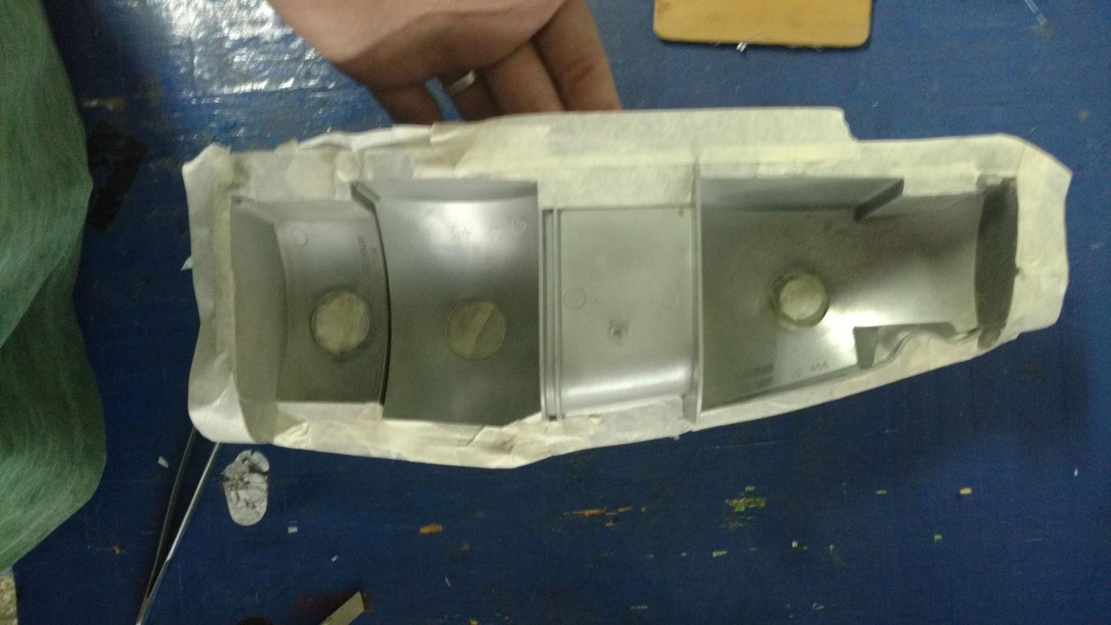

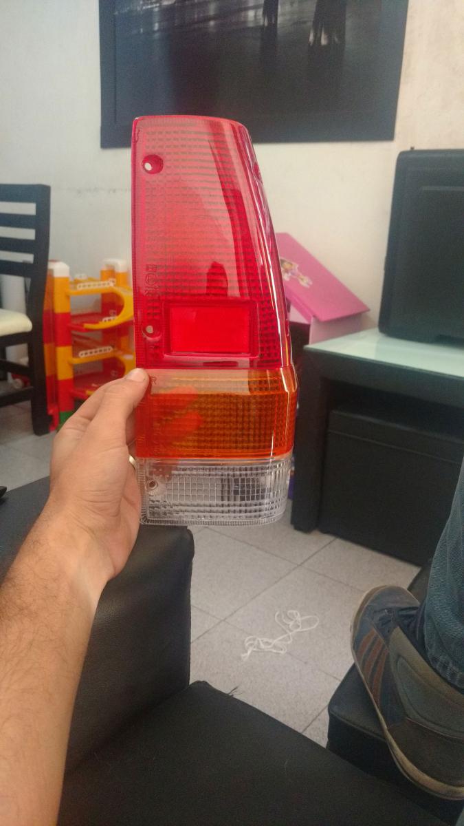

    So i have a little time between dutyes and thought about sharing some pics about the "renovation" of the tail lights....
    It was dark when i installed them so i dont have a better photo tha that one...
