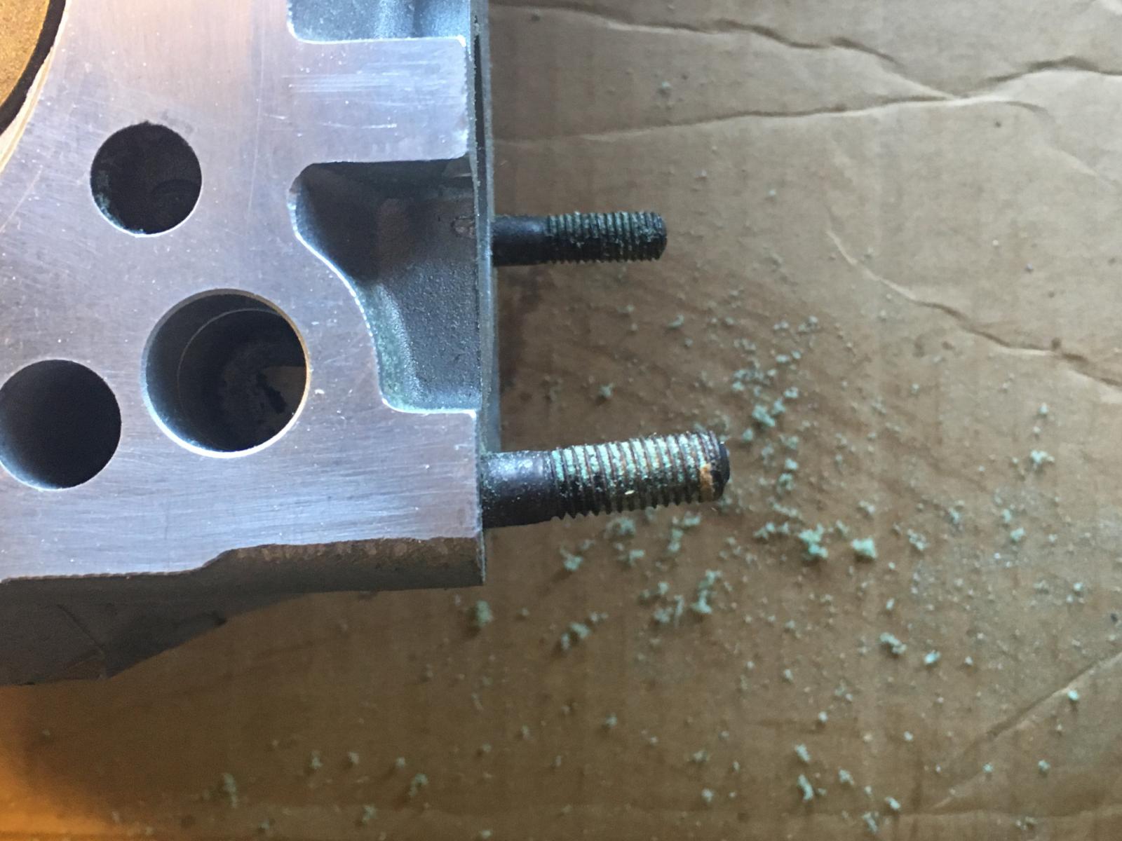

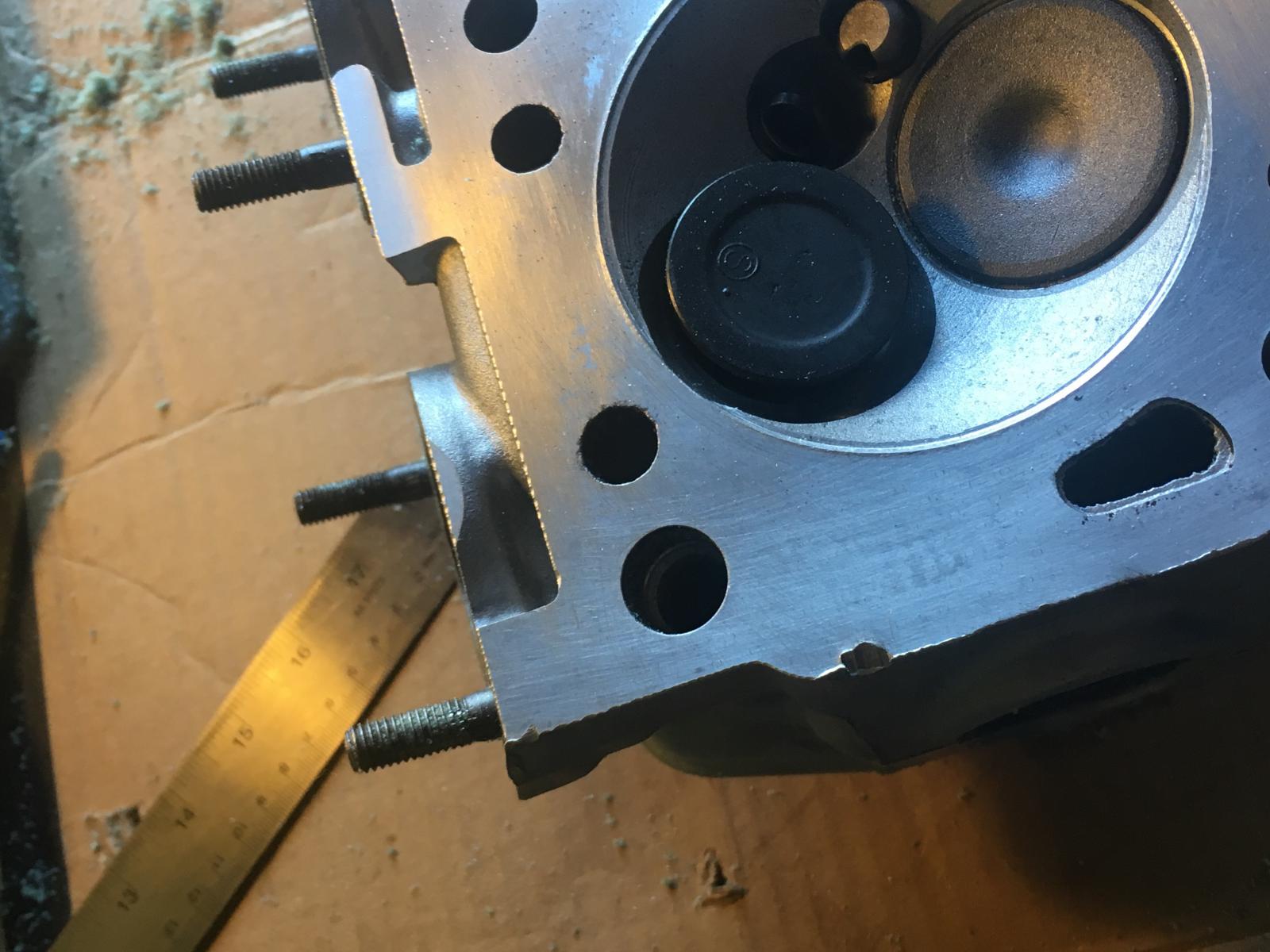

    Got the head first, and started to clean off all of the foam fragments from how it was packed. came across a bent stud and a few scuffs/dings on the bottom face of the head. Will these give me trouble during installation?

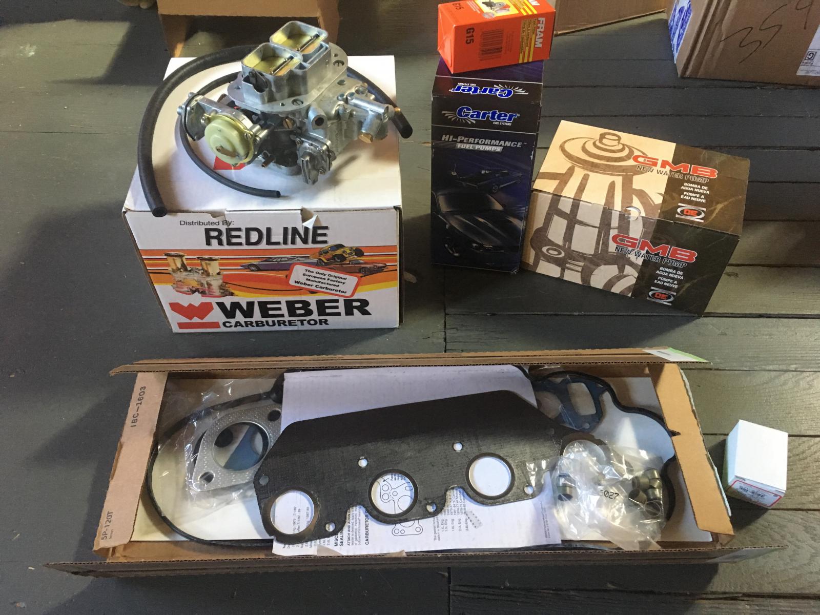

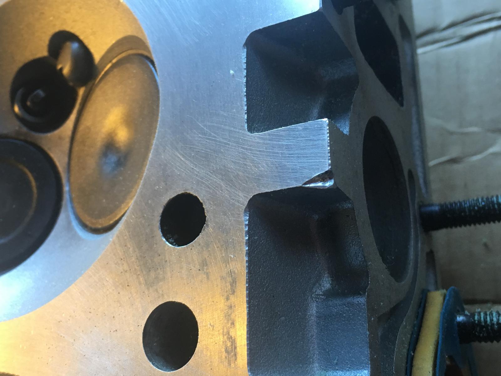

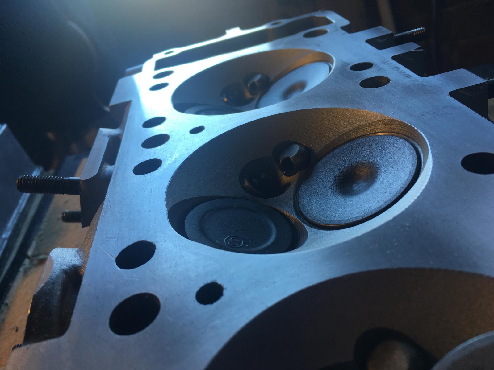

    In picture #4 in my above post, you can also see that my #4 combustion chamber has a lip around the edge, and a small raised lip on the surface of the head. Did i just buy a shittily machined head, or is that relatively normal? Sorry for the amount of questions- like I've said this is my first time diving into engine work.
    O.k. so this is a reman'd head? I would be concerned. The lip on #4 chamber and a few defects around the port indicate some problems not only with the machinework, but possibly with the head itself. I'm going off on a rant and there are a number of opinions on head reconditioning that X is right and Y is wrong. To me, it points towards the head originally being warped from overheating then having the galleries welded up and the whole thing refaced. It would explain why #4 chamber has that lip on it - the head hasn't been machined true (I can't see any other areas of the head, only the pics you've put up). And it's been dropped - a number of times (explaining the chips, dents and the bent stud...yay). I am of the opinion a head should be baked in an oven and pressed true before commencing welding and machining. Machining a warped head throws combustion chamber sizes out of whack, and also pulls the cam journals out of alignment due to the bed no longer being true. This then causes problems with the cam binding and wearing the journals out - not what I call 'quality work'. I might be wrong but I would get the head checked and if I'm on the money, send it back and flame them in the process.

    The chips and bent stud are from shipping- USPS is less than forgiving in my area, and they aren't present in the pictures he sent me before purchase. the lip in the #4 chamber is the only spot with that strange lip, i almost didn't even notice it at first. I guess i'll find a machine shop and see if they can check it out for me.

    If the head was warped when it was machined, there's no fixing it. If you decide to take it into a shop they should check the minimum thickness of the head to ensure there is still enough metal to mill the face down in worse case scenario. The dents on the outer edges aren't deal breakers, they won't affect the head gasket sealing against the block. You could run a flat file over the deformations just to take out the high spots and you'll be right. I would even go one step further and radius off all the sharp edges in the combustion chambers. There is definitely something weird going on with the machinework. Note that all the other combustion chamber edges are slightly overlapped by the valve recesses except for #4.
    Fel-pro makes a head saver shim that goes between the head and the block to restore the spacing lost due to over shaving the head past the maximum of .015. It won't solve the issue of a warped head shaved without straightening.

    took the head into the machine shop, and it's not warped, just machined strangely. the ring in the #4 chamber is from a piston impact, probably when he threw a rod after the rebuild. however, the valve in that chamber is bent. especially frustrating since I bought the head for the valve job.

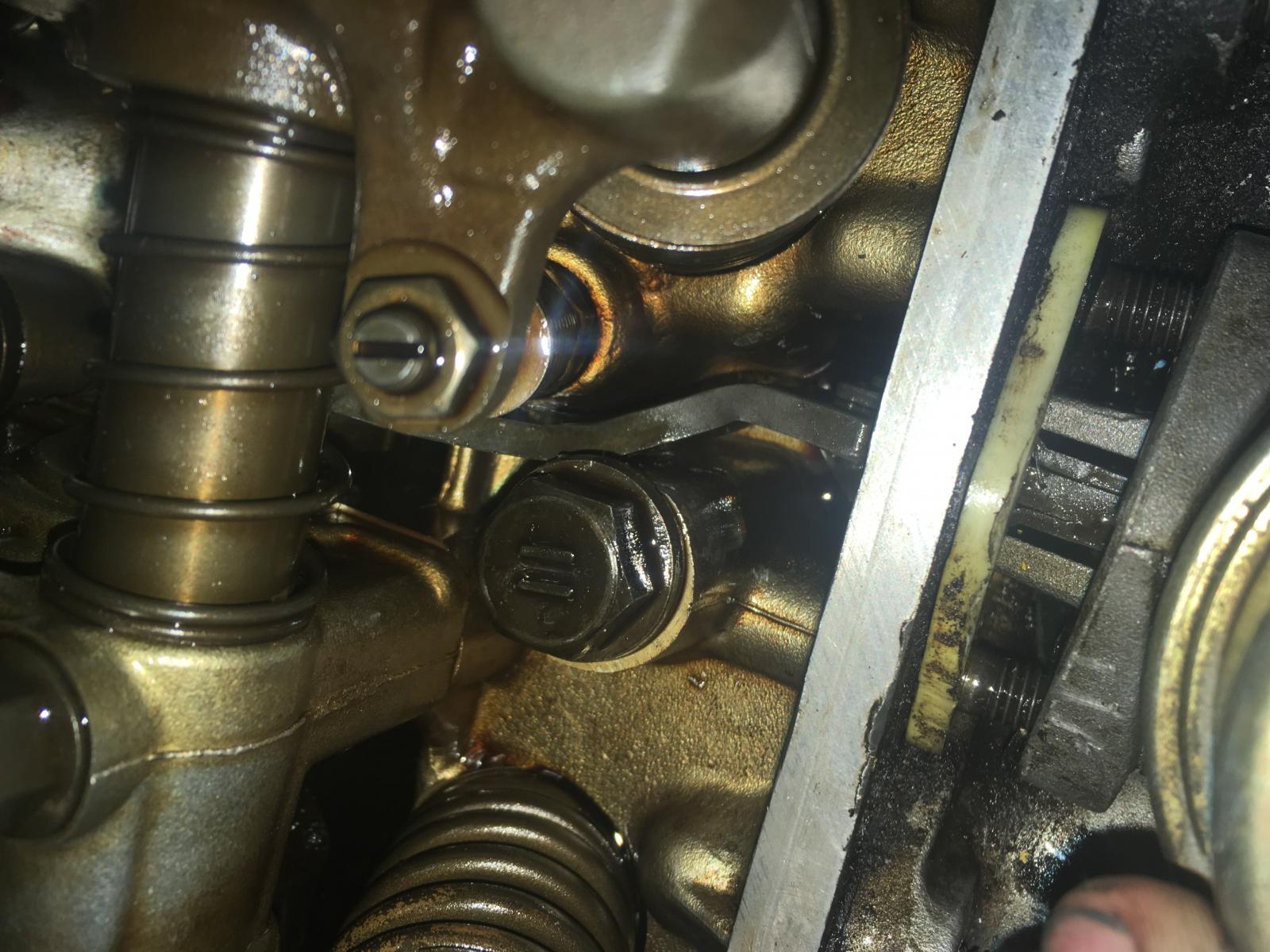

    decided to to pull my head and evaluate its condition to weigh my options. got most of the way through removing my intake manifold, and ran into a strange problem- one of my head bolt washers is off center, preventing the fuel pump "arm" on the camshaft from sliding out of the hole. tried to loosen up the head bolts, and I couldn't budge them with my ratchet... going to come back tomorrow with a breaker bar and see if I can't loosen them up to slide the pump out. hoping that this isn't indicative of my head being super warped. image.jpgimage.jpg
    I was going hedge a bet on piston impact but the rest of the machine work looked sketchy so I ran with option #1. Fuel pump rod being witheld by an off centre head bolt - that's a new one for me. The bolts are probably good, just well torqued up. Hopefully the head is sound and you'll only need to swap a valve out of #4 chamber.

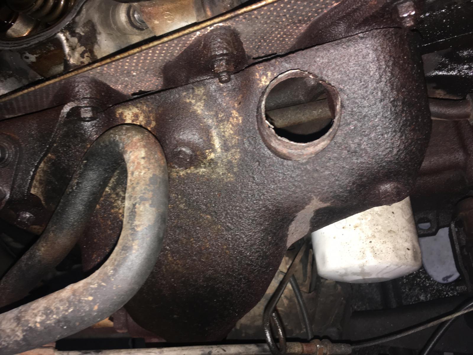

    loosened the head bolt a tad and pulled the fuel pump studs and it came right out. intake manifold OFF, but judging by the state of my exhaust manifold it's going to be a whole different story... image.jpg

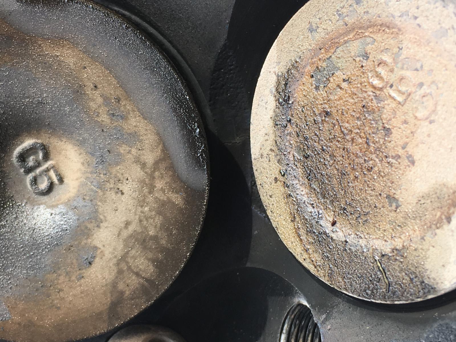

    Got the head off today. Found 2 cracked combustion chambers. Took my new head back to the machine shop to get the bent valve replaced, grind out the ring from the piston impact, and set my lifters and it should be as good as new. Also checked the minimum head thickness and i'm still about .02 over, so as soon as it's done i should be good to go.
    The original broken-plug chamber: IMG_7508.jpg
    The other cracked chamber (kind of hard to see): IMG_7509.jpg
    And the head in it's filthy, jet-valved glory: IMG_7506.jpg
