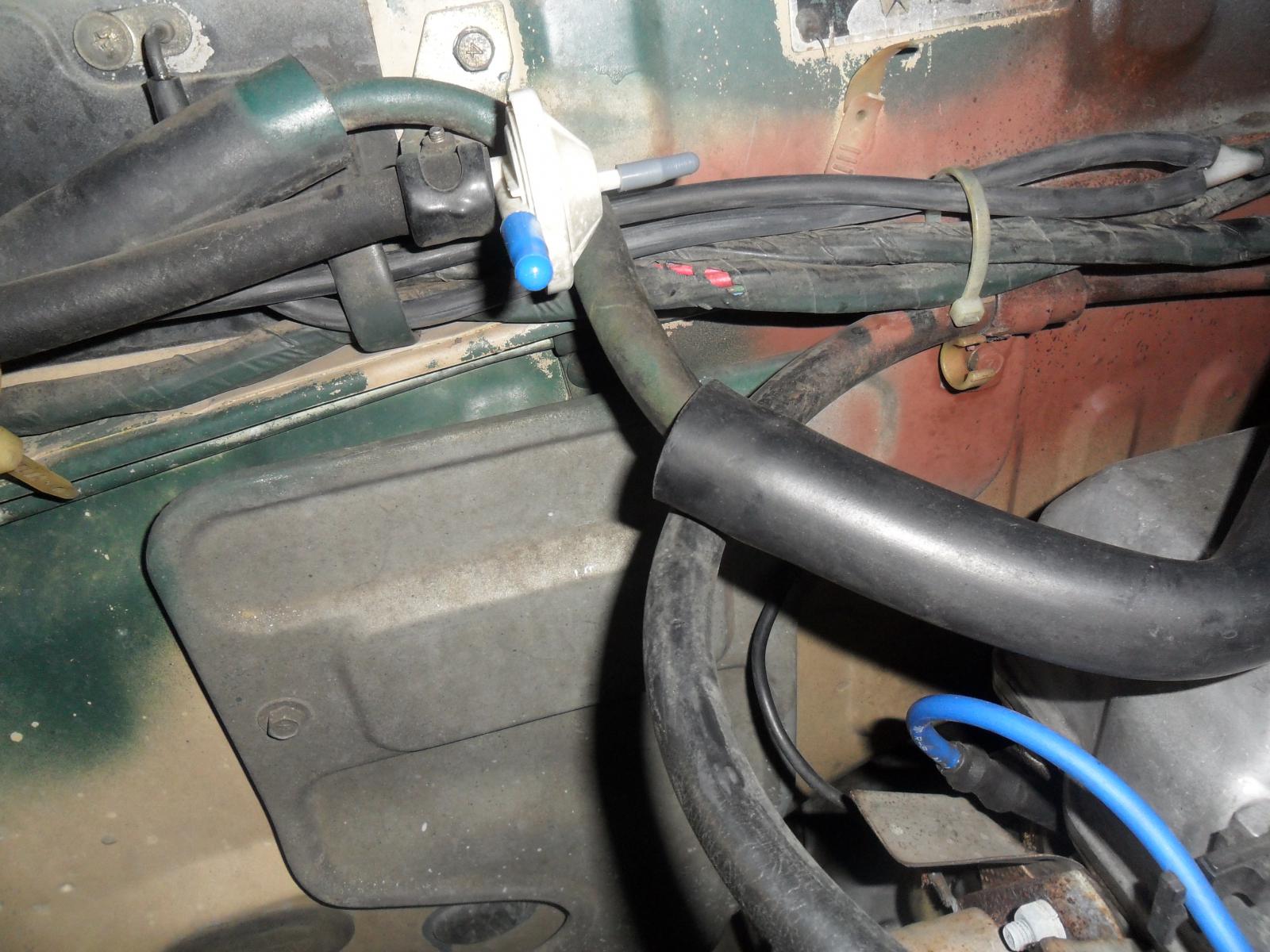

    Oh yea I paid more attention to what the carbon filter said on it.(I had my glasses) and the one that goes to a plastic diaphragm was to the AC so this must have had AC originally. I vacuum capped both outlets. One went to the carb and was hanging on the firewall so I stuffed it into that hose from the secondary air filter that has something to do with the emissions that was also removed from this thing. The last one goes to the gas tank connecting to a hard line just below the canister.
    Here is a picture of the two hoses. The white plastic is the end of the hose that says 'to AC" the other one looping over it and into that larger hose is the one that says "to carb". That hose its stuck in goes to the outside of the air cleaner.
