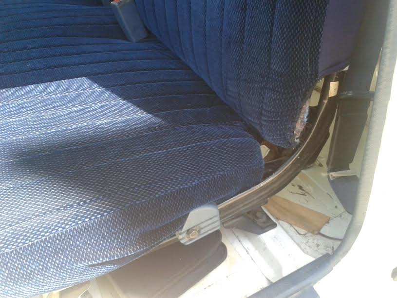

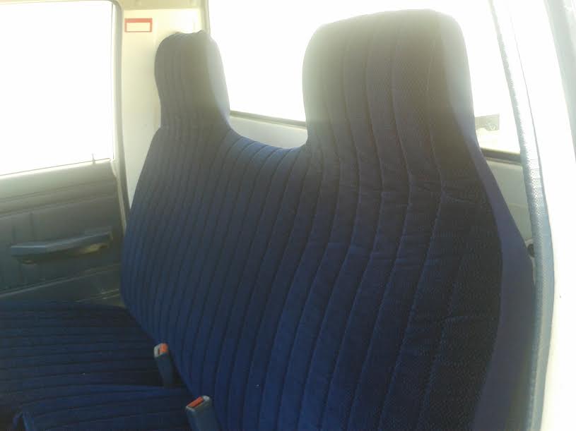

    I rolled the dice on my shitbox truck and got this replacement velour cover off Amazon. It actually fits pretty well. The key was pulling the bench out of the truck, disassembling the back from the lower bench, cutting off the old covers, removing the old hogrings and taking my time to stretch the cover over the foam pieces and smooth it out. I give the fitment a solid 7/10, maybe more if someone took even more time than I did.
    It turns out the foam for my bench was OK after I got rid of the ratty covers BUT I learned you can go to a foam store and buy a chunk of foam for a few bucks and then cut it down using razor blades and a hot wire. Not hard or expensive at all. Motorcyclist do this for custom saddles.

    They've held up well for 3 weeks. No shifting around. Stitching is holding up. The velour is padded and feels really nice, not like that shitty, paper thin tweed material from McAutoparts. These are not bad for the money at all.
