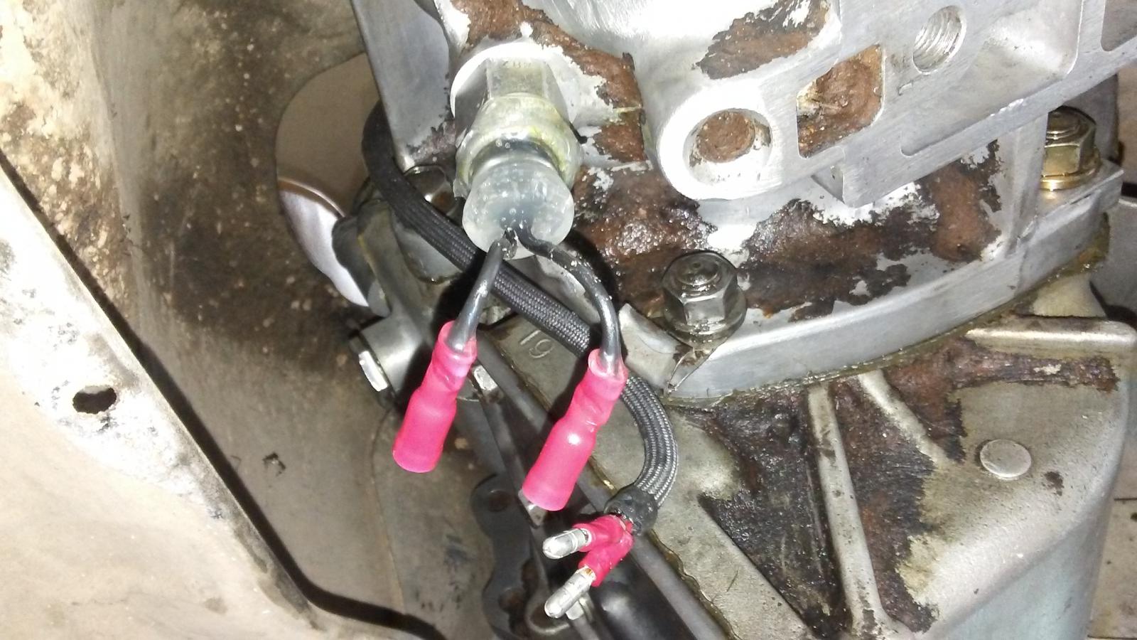

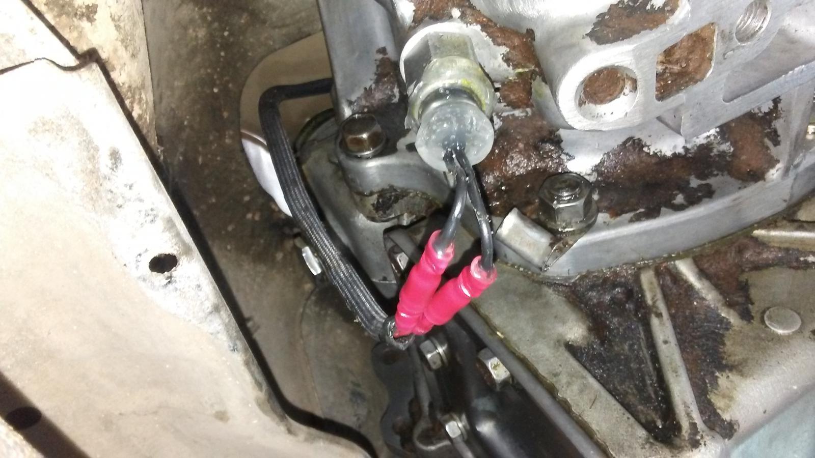

    Here is what I did to install the backup light switch with it's accompanying headache inducing steel ball(5/16 inch.).
    1. Put manual transmission in neutral.
    2. Insert steel ball into threaded transmission hole while at the same time threading in the backup light switch. (Be patient, this part is tricky)
    3. Tighten it with a 19mm wrench just snug enough. REMEMBER, IT IS TWENTY PLUS YEAR OLD ALUMINUM YOU ARE THREADING INTO.
    4. Reconnect wires and test. If backup light switch is not working as it should, it is most likely bad. Don't forget to add the crush washer before threading back in the back up light switch. I would also recommend adding sealant to the threads.
    Some other stuff related to the backup light switch:
    To make removing and installing the backup light switch easier, I modified it. Soldered on some new wires to the back up light switch with crimped on female insulated bullet connectors on the other end. For the other wire, I crimped on male insulated bullet connectors. This little modification makes working on the truck much better. I had ripped the wire so many times while removing and installing it that it just got on my nerves! Mitsubishi, you knew you could have done better!
    Disconnected:
    Connected:
