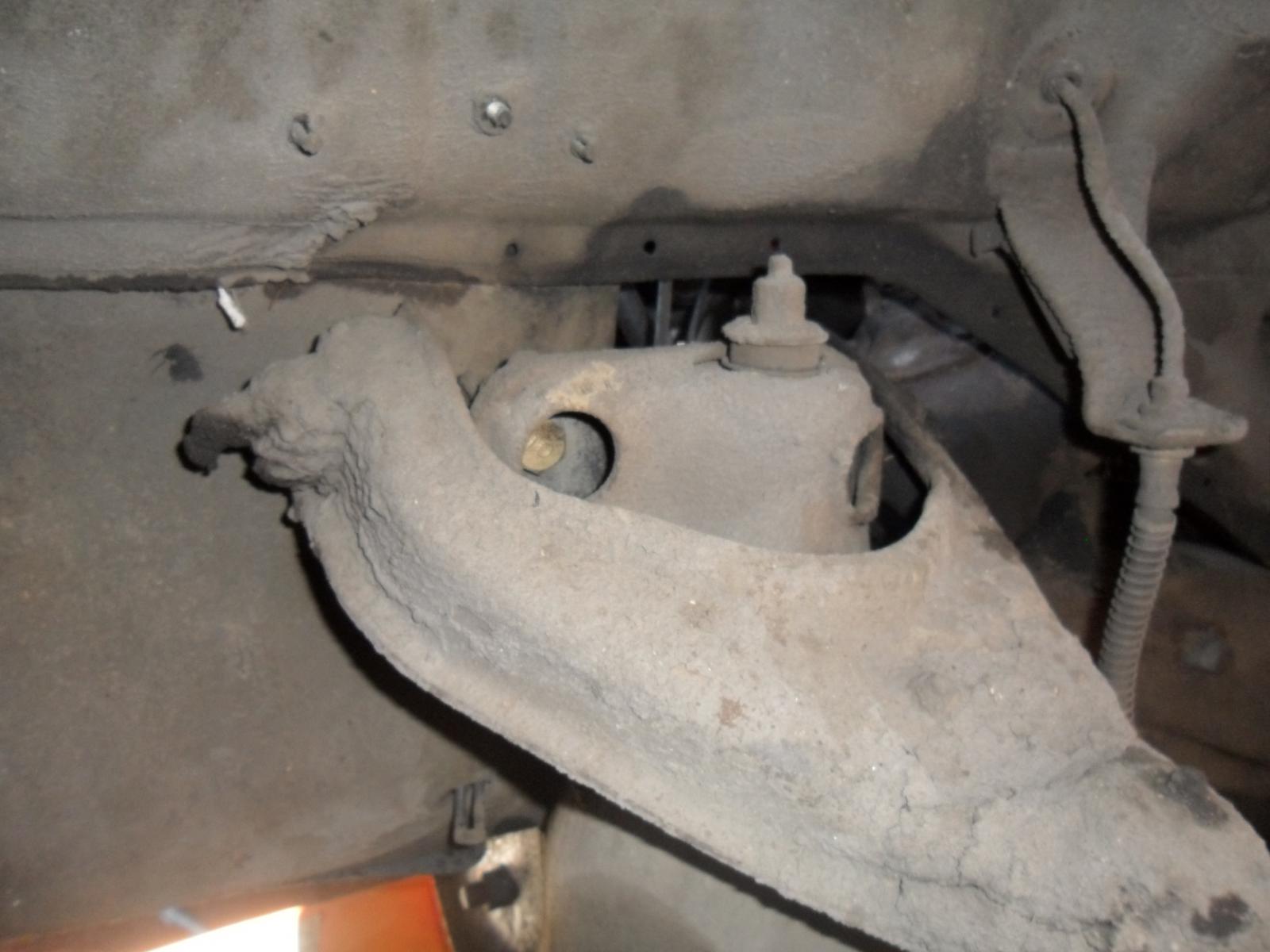

    I got it up on jacks and took the wheels off. It is filthy. I took some pics before and after a bit of scraping away 30 years of built up dirt and grease. I also opened up the lower fender on the pass side and sure enough it dumped a load of wet dirt. Well at least its clean now.
    I have scraped up and hosed down both sides of the suspension parts they both look like the dirty one I show. I removed the bumper and that splash guard thing. I'm reading the manual to be sure I do all I can right. What shocks fit here? They look a lot shorter than the spring assist Gabriel's I used on the back.n How hard is it to press these ball joints?
    Before cleaning- drver before clean.jpg drvr upper arm.jpg drvr lower arm.jpg

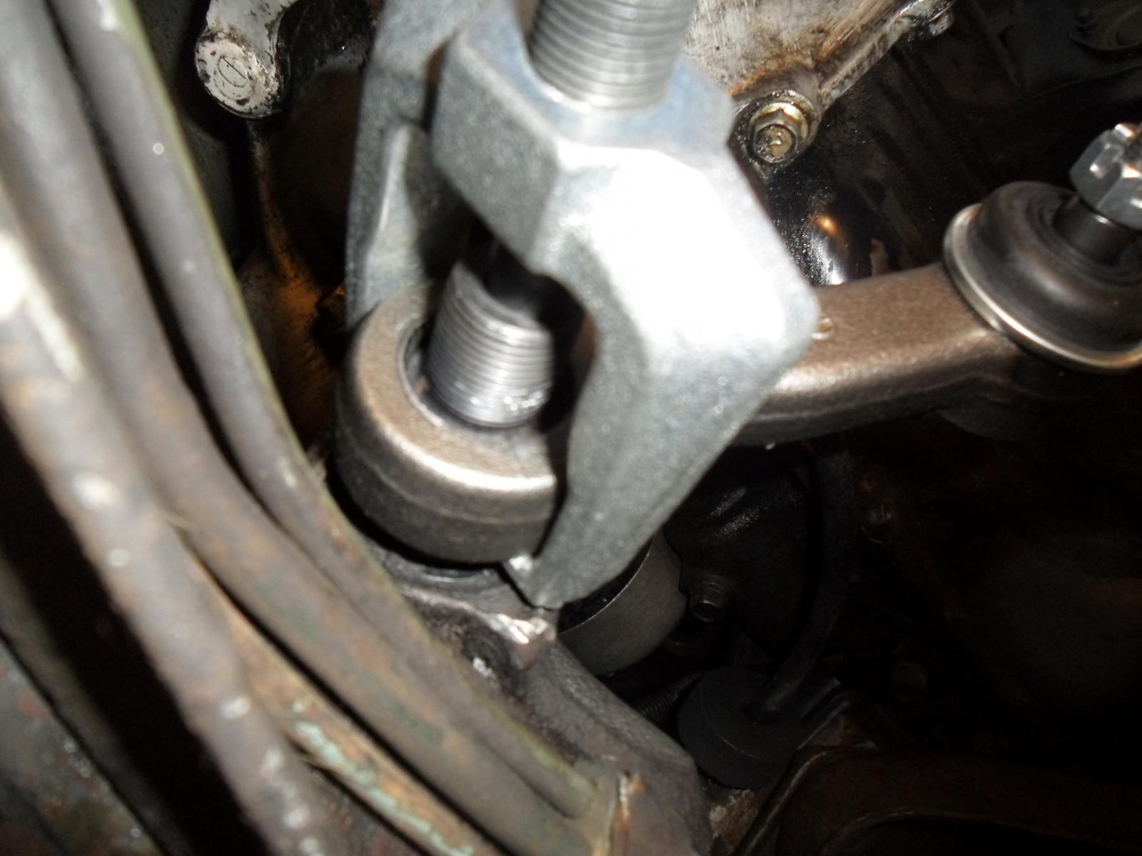

    Got the pickle fork and the lower ball joint gave way just as in that video. I didn't have the strut bar and bottom stop removed so the spring didn't fall out but once you are sure it is released of all tension you can push the lower control arm down and the coil will come out. The upper ball joint hung onto the top of the spindle. I did some research and the best way after wasting a lot of energy with the pickle fork and pitman arm puller is to smack the outer section of the spindle right where the ball joint goes through with a big hammer. I use a 4lb with a short handle. Two smacks and each dropped right out. Now I need to figure out the exact size of the nut that holds the pitman arm in as my 14" adjustable is too short and too fat to fit on at a safe angle for me. The 1 1/8th wrench I have is just a hair too small.
    EDIT-The nut is 30mm the oreillys pitman arm puller would not fit because the grabbers were too fat to get the puller on fully centered. It went on to where I could get the push pin to connect but that push pin is too narrow and it has a button on top that prevents using a socket and breaker bar.
    Edit2- got it off had to get a kit at harbor freight with a pulled the right size. Then I realized I did not mark the location to replace the new pitman in!! Any help with setting the pitman arm in the right position would be appreciated. I will be using the ties rods as is to set the length of the new ones.
    there is a line on the shaft that you line up with the mark on the pitman arm

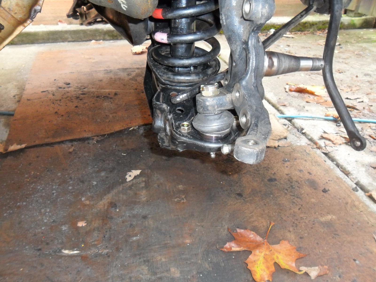

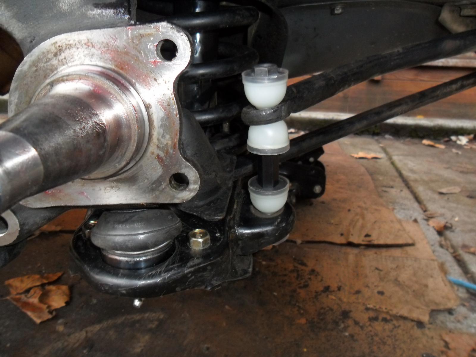

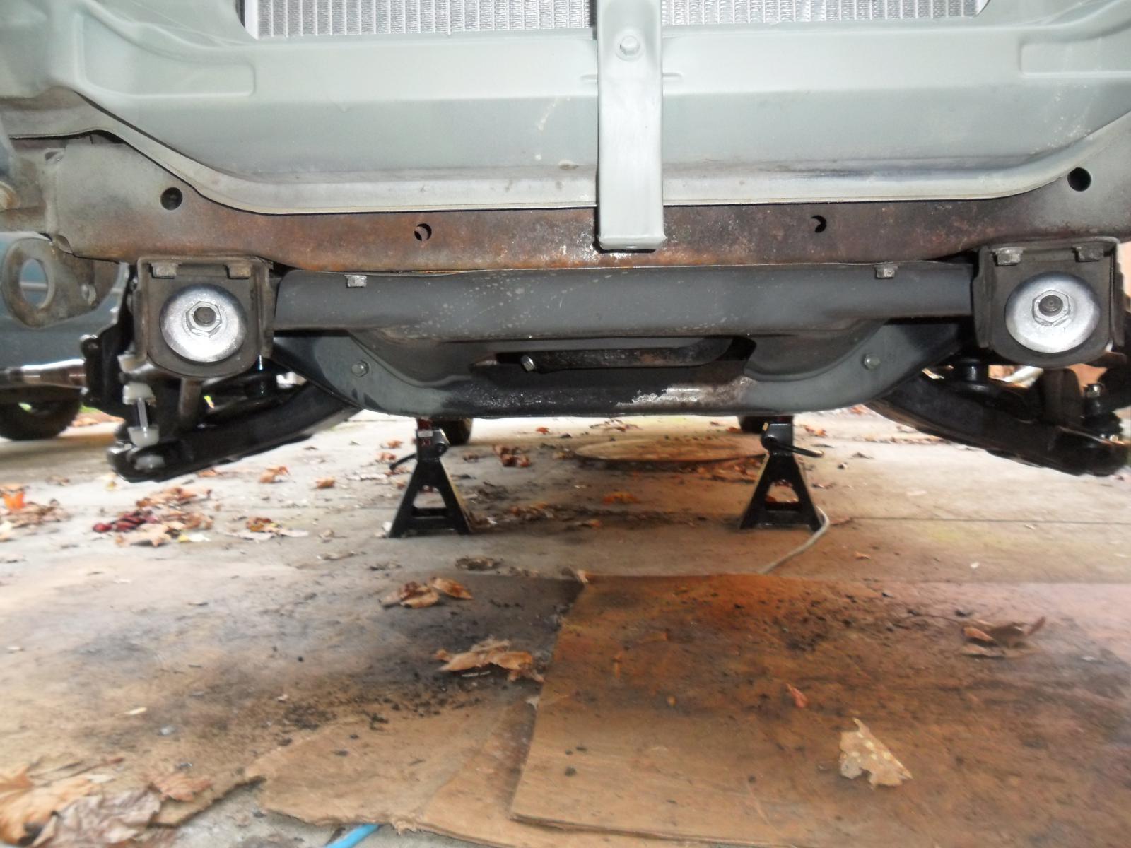

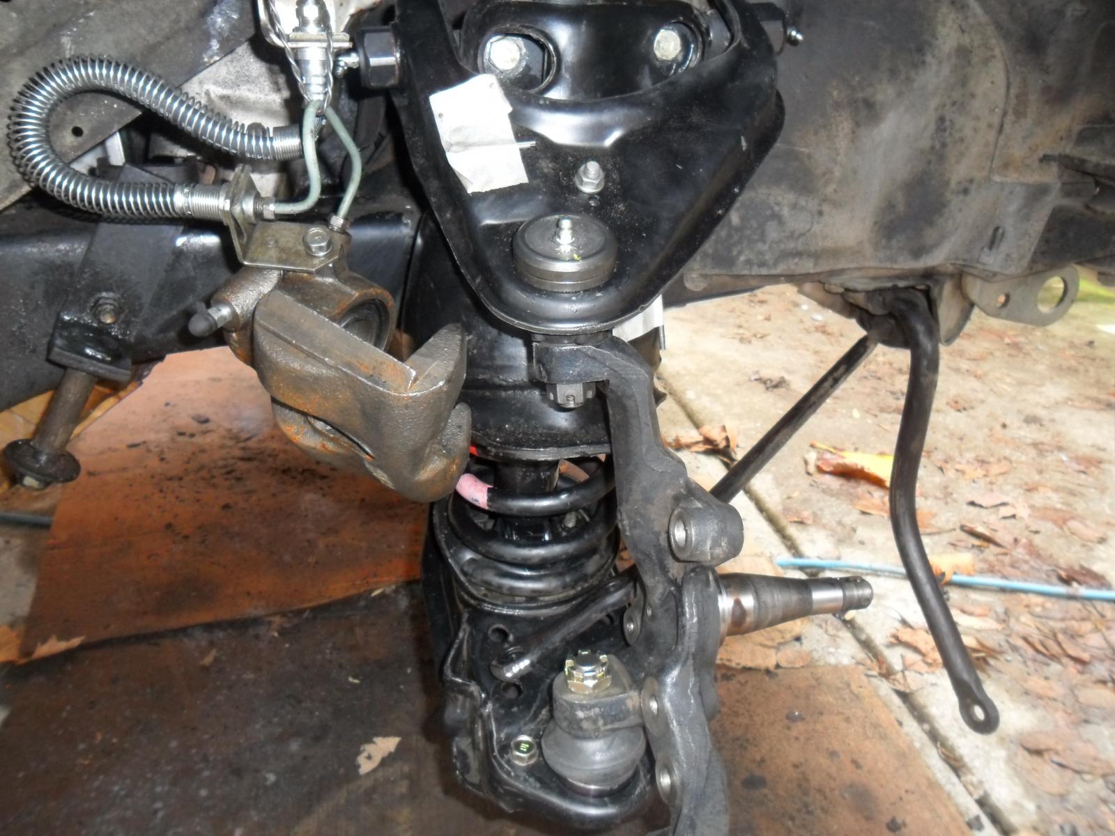

    This disc job turned into a front end rebuild. In the first pic I have temp installed the Moog stablizer bar link. I am unsure if that is the correct way. Please let me know. is this right.jpg

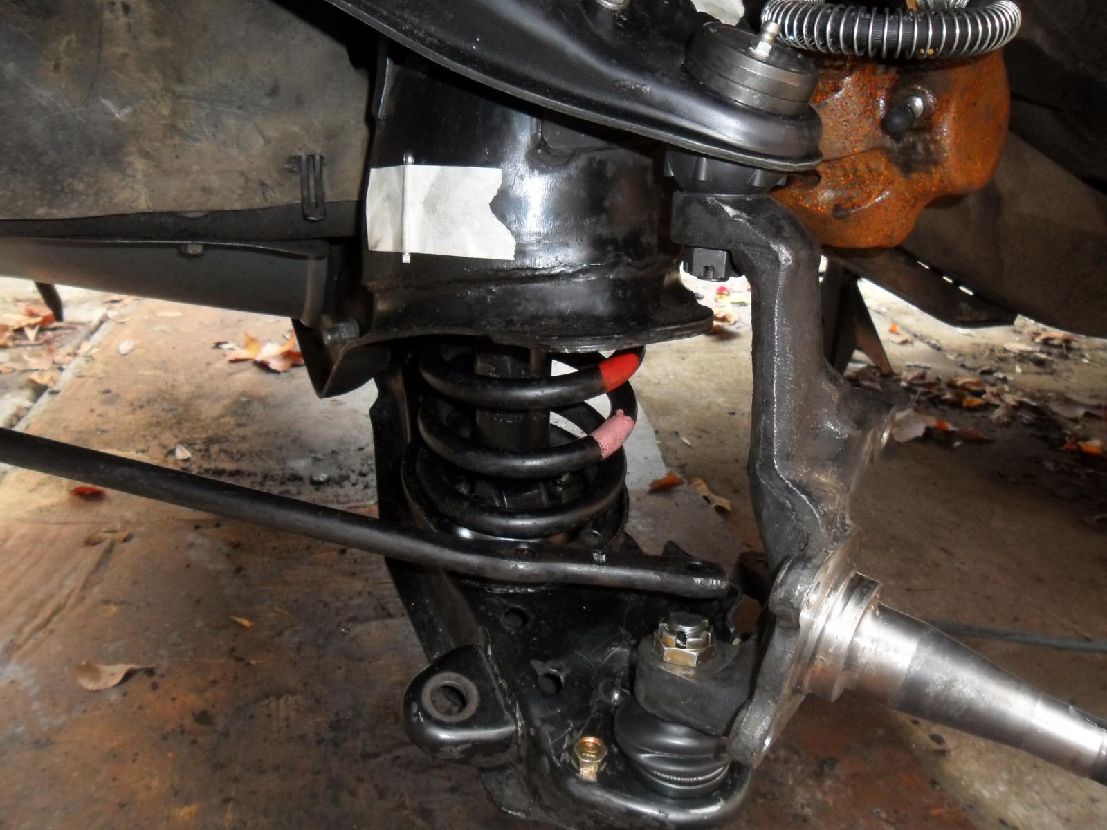

    OK I have the spindles back on and all the new stuff on the control arms and the sway/strut bars. Let me know if anything looks wrong please. This is the first time I have done this.
    After this I have to install the new steering parts. What is that red/Pink color code on my coils? The FSM does not have a red on the color code list. I have the cotter pins taped up in case I did something wrong it will be easier to take things apart.
    Pictures pass CA 's on.jpg whats that color code.jpg new strut bushing.jpg DVR spring spindle on.jpg DVR spindle other way.jpg dvr UCA.jpg
    The first thing I did was to put in the new brake line and new calipers. They rusted because I was messy with the brake fluid.
    where is the lower bump stop? If you run with no lower stop you will hyper extend the ball joints and blow them out. I run Geronimo with the stock ones cut in half - that is the most to shorten them without ball joint damage, unless you convert to Uni-ball joints like 4 wheelers use.

    Sorry I guess I wasn't as clear as I thought I was. I put new bushings on the struts and sway bar and connected the bump stop after I took these pics. They are on bolted through the struts as per OE. Edit- Actually you can see the drivers side bump stop in the new strut bushing pic
    just keeping you safe - most people don't think about the way the suspension moves and misses that the stops are there to limit travel of the ball joints.

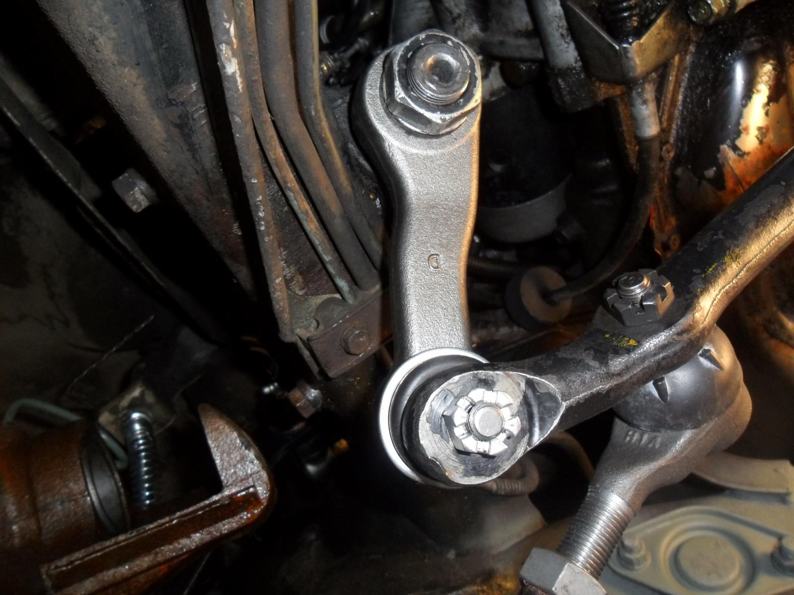

    Hopefully this gets seen fast as weather is coming.
    OK I have run into a problem. I set the idler arm then connected the tie rods on each side so I figured the pitman should line up with the other end of the relay bar. The relay bar did not line up with the pitman arm with the steering wheel set straight and the front wheel on the driver side where I was working set straight.
    Here's what I did. I removed the pitman then realized I could turn it so I set the pitman with the marks again and turned it to make it meet the relay bar. So far so good. I have the tie rods connected with the castle nuts screwed until I met resistance by hand. So I went into the cab to set the steering wheel and turned it to set the front driver wheel hub/rotor straight. Took off the cover and went to check the pass side to be sure and I see it is turned in while the driver is straight. !?!?!?!?!?
    When I set the tie rods yesterday I copied the existing rods length exactly. I laid them side by side and they were in the same alignment and length. Clearly I missed something, maybe one of the little balls was tilted and gave me an optical illusion.
    Anyway I assume this means I need to adjust it. Please let me know how to get it right asap. I understand the point of the lock nut and the left handed threads I just don't know enough to feel safe just making it look straight. I intend to take it in for an alignment when I am done.
    This is how it looked when I first installed it. as is first try.jpg Just to show the removal tool.remove to do over.jpg
    This is it installed as installed.jpg Not sure you can see the pass side is turning in, pass side turning in.jpg

    So I messed about with things and tightened up the castle nuts on the steering from the driver side toward the passenger. I removed the tie rod end on the passenger side and held the rotor straight and it seems like tightening things up fixed things as the tie rod end lined up with the hole so I figured it was close enough to drive it to the shop for an alignment.
    I painted the new calipers to inhibit any more rust. I have the brakes back on the passenger side and am at a standstill as I lost two of the pins for the driver side. I ordered all 8 from Napa. It will be two days before they get here.
    I jacked up the lower control arms and torqued the ball joints and all castle nuts are tight. Everything is tight I'm down to just that brake caliper and bleeding the system. Seems like I over greased the idler arm as a lot came out at the base of the boot while I tightened it. I just wiped it off and everything seems fine. Oh the sway bar link doesn't get tightened until I have it sitting on its wheels. There is a torque spec in the manual.
