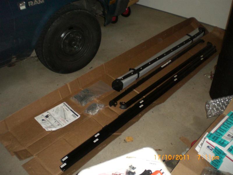

    Bottom row;Kit as received.

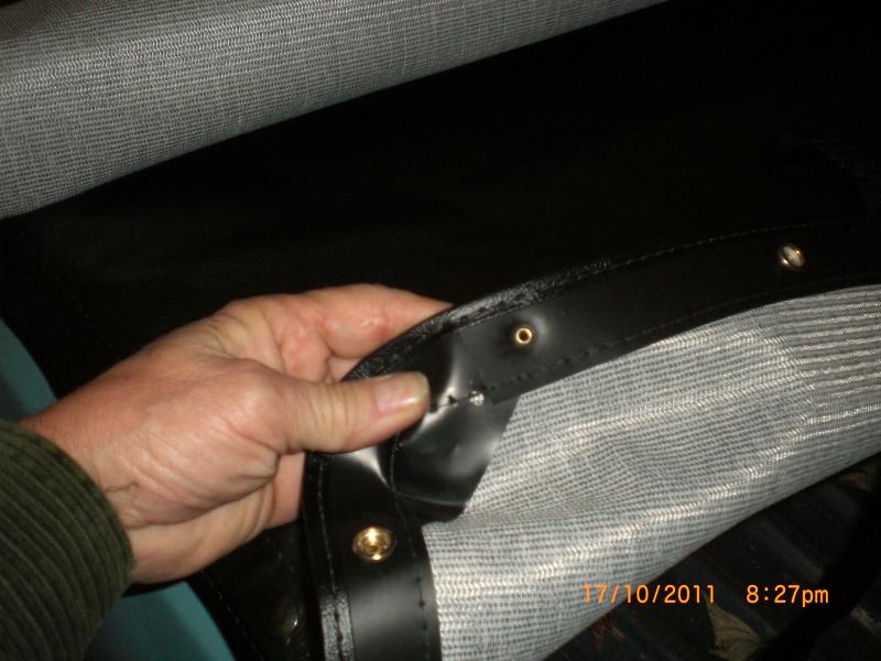

    Third row up, right; Shows quality stitching which I will have to equal someday, and a missing snap.
