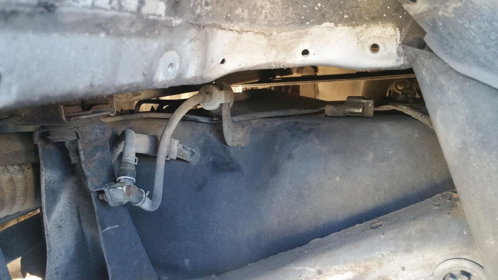

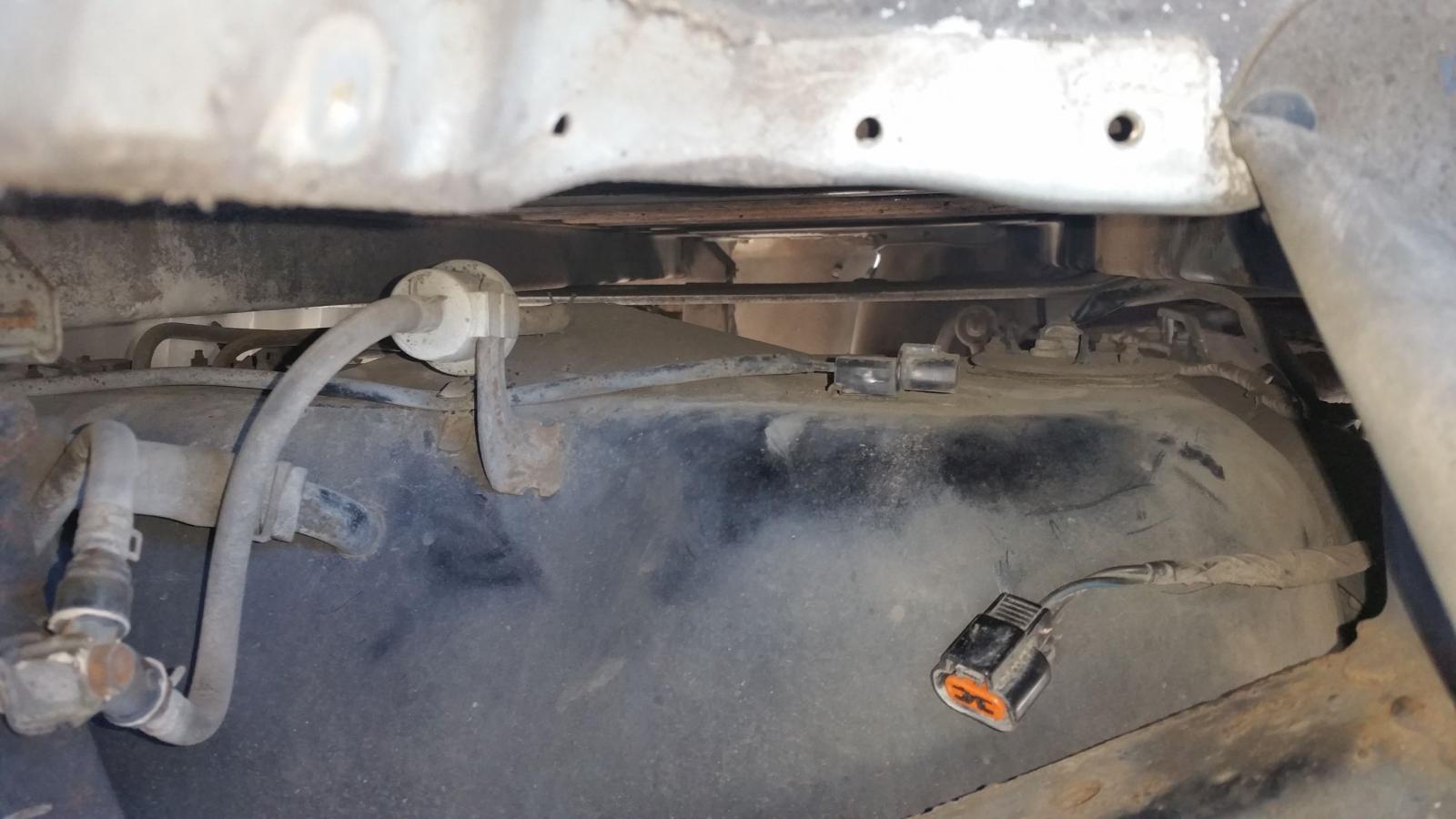

Thanks for the answers to the how to get to disconnect the fuel pump power. I took some pics and will upload them so anyone who has this question can easily see what we are talking about.
Pics as I said, I'd share.
1st is wheel-well-fender-shroud
Then shroud off. You can see the pump power connector.
Pump power wire disconnected.
