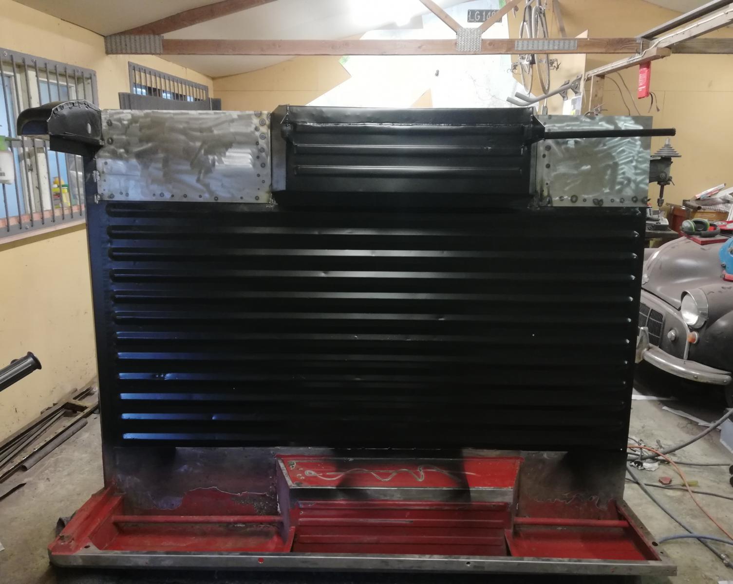

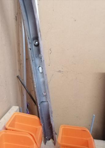

    1st gen tray cab end
    Panel unbolt, has a 3mm or so flat bar as a spacer, that could be replaced with a C channel to make a headache bar.
    2nd gen factory headache bar (nz market at least) is held to cab end panel by factory bolts and was welded on in the corners.
  19. #319
    1,222
    Spot welds, And by the 3 upright bars which were drilled through and welded into the end panel
    Some the 2nd gen end panel is wider than the 1st gen, so could cut a little out of the middle and weld it to fit. Or make a whole new one using some C channel uprights
  20. #320
    1,582
    Thank you tortron for all these details ~ I thought the headache rack was made from square tube but it is actually "c" channel ~
