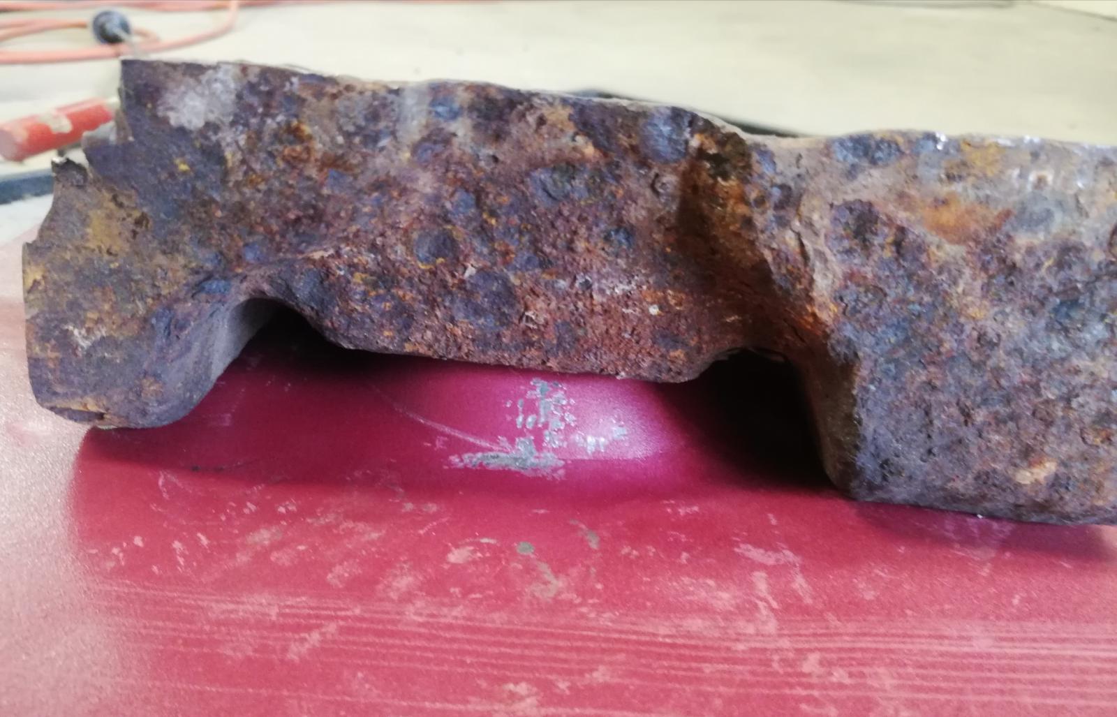

So we start with our rusted out, but largely in shape cab mount.
I picked it apart and took some measurements. Can gladly confirm the dimple die I made prior is a perfect match

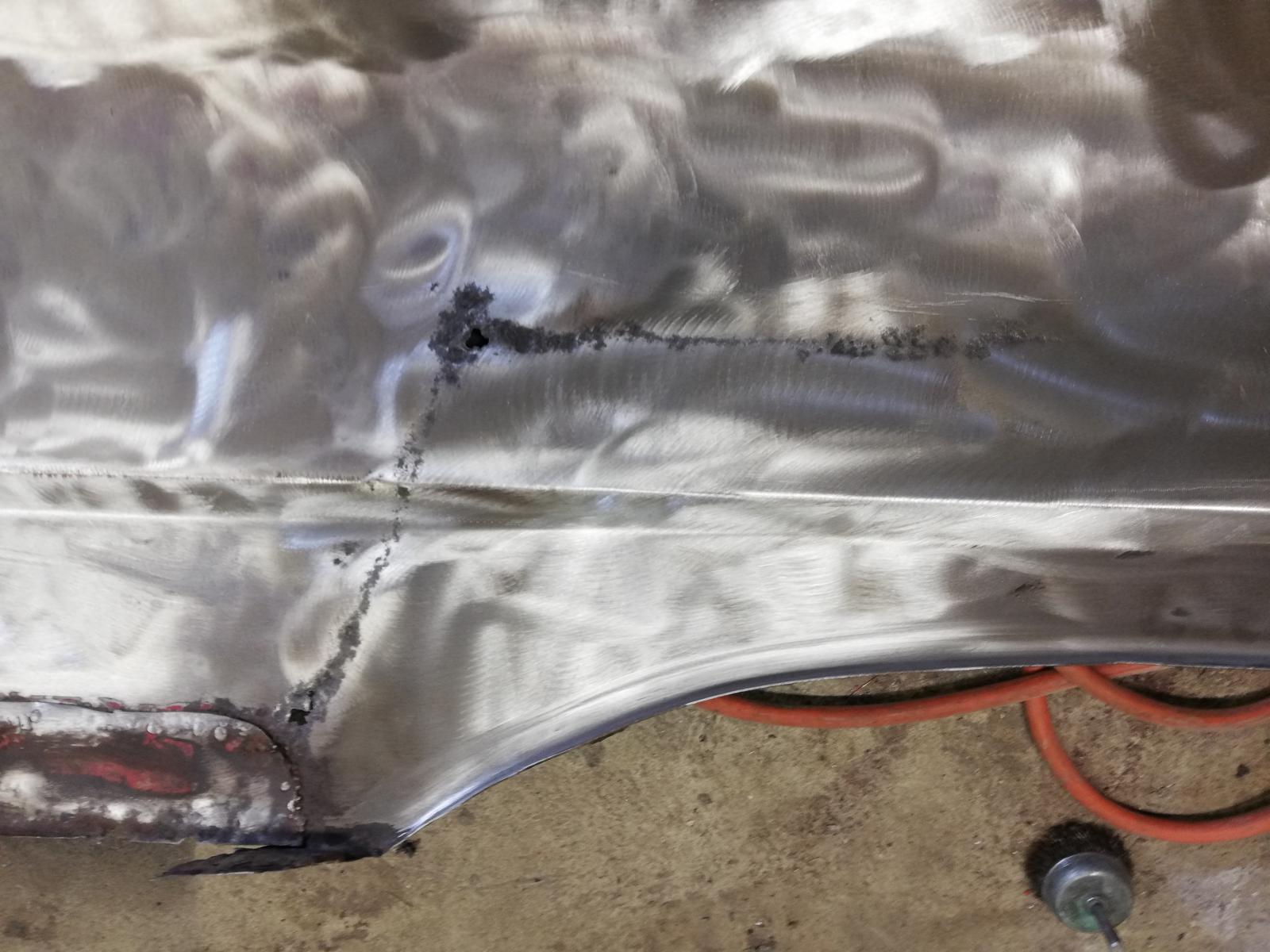

Luckily the passenger side was in better shape than the driver's, so I was able to get some good measurements and a better idea of the shape details. Like the kick in the upper strengthening plate at the B pillar.

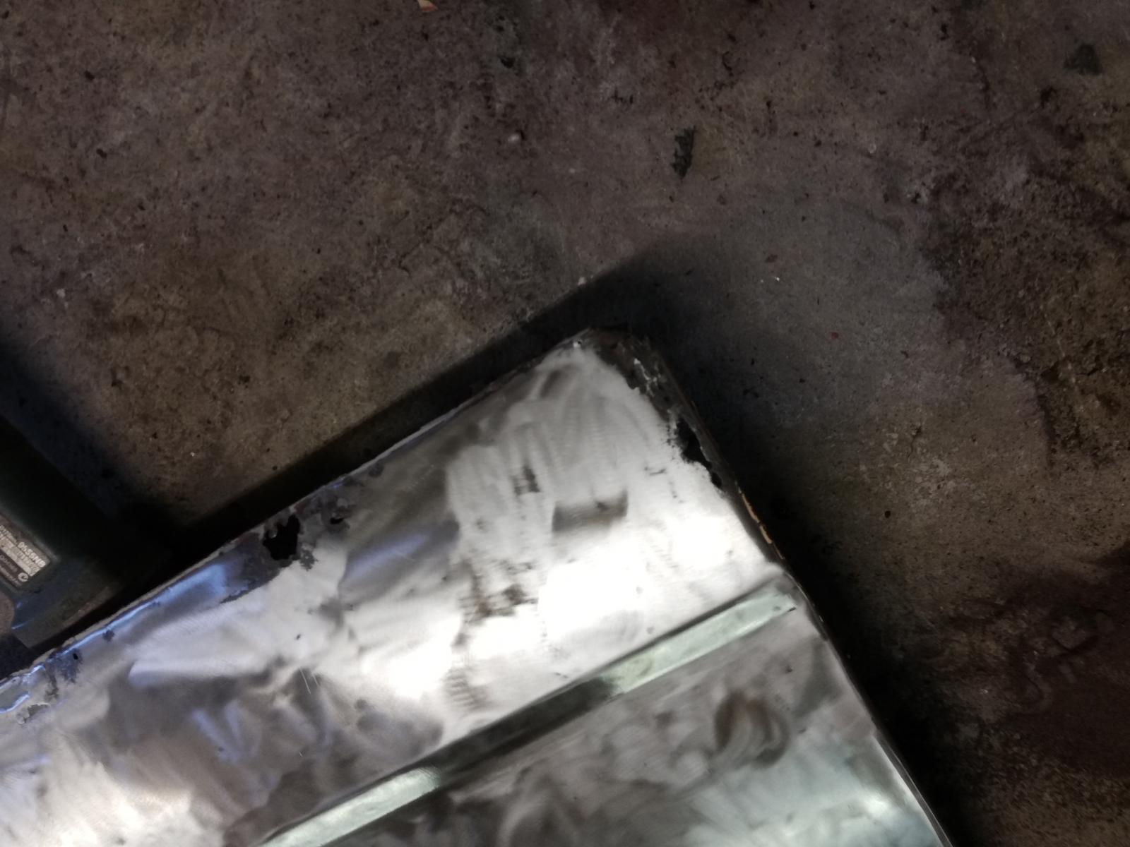

So I marked and cut out the upper plate
I opted to cut and weld to get the kick this time, I'm short on steel stock. It doesn't take much time but I could also make something to press it in.
I radiused the corner and welded the cab back corner and hammered in the raised bead (I will probably make a tool to press this in next time, it would be quite basic and take 30 seconds instead of 5 mins)
