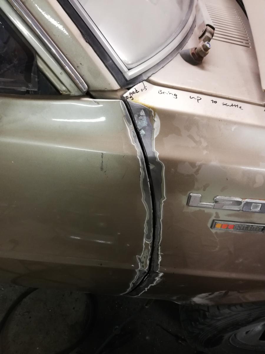

    Bottom of the door bows out by about 1 cm in the middle!...
    The sill I out in is dead straight.
    Oh well, il paint that too while I'm at it.....
  6. #256
    1,222
    Yup, so the door had been bent out to fit the will
    I ended up totally reshaping the lower body line of the door. It was different between the b pillar, door, and guard.
    Once I hung the door, I lined the rear edge up with the B pillar frame.
    With some tapping I got the lower edge parallel and inline with the sill.
    But now I couldn't open or close the door....
    Panel gap at the guard edge was all over the place. I ended up redoing the whole rear of the guard. An old Taiwanese reproduction. In some places out by 5mm + or -. And the rear mount had been welded on crooked.
    It's pretty good now.
    Some fine finishing and I can prime it up and get this back on its wheels

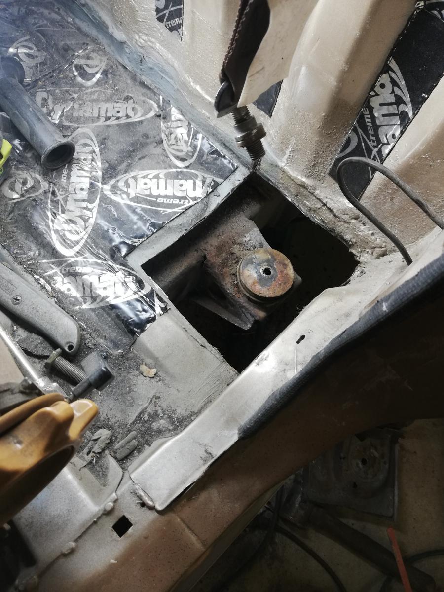

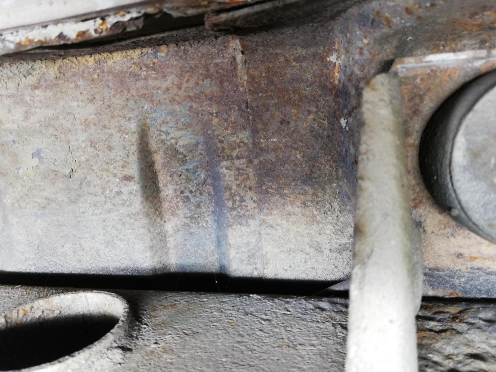

    Thought about putting the Ute through its inspection next week, but there was a tiny rust hole on the opposite side cab mount. Figured I'd just knock it out beforehand. Got a replacement sill and the jigs for the mounts and floor ready to go, so should be straight forward.
    Same story, the drain hole was blocked totally with bog, so the body mount is rusting out. Looks like the inner sill has been messed with as it doesn't sit nice either.
    This looks worse in the photo than I believe it is. I have had a good look over the frame and this is the only pitted area, so I don't know what's going on. Some holes in the cab mount bracket itself but I think I can handle it. Plan on filling those pits and grinding flat, seems to work on hotrod frames, I don't think the frame will suffer in any way.
    And... More of the same
    Crappy repairs, lots of bog, bottom of the sill badly pitted and just bogged over. Won't bother digging any deeper, just going to cut it off and replace it

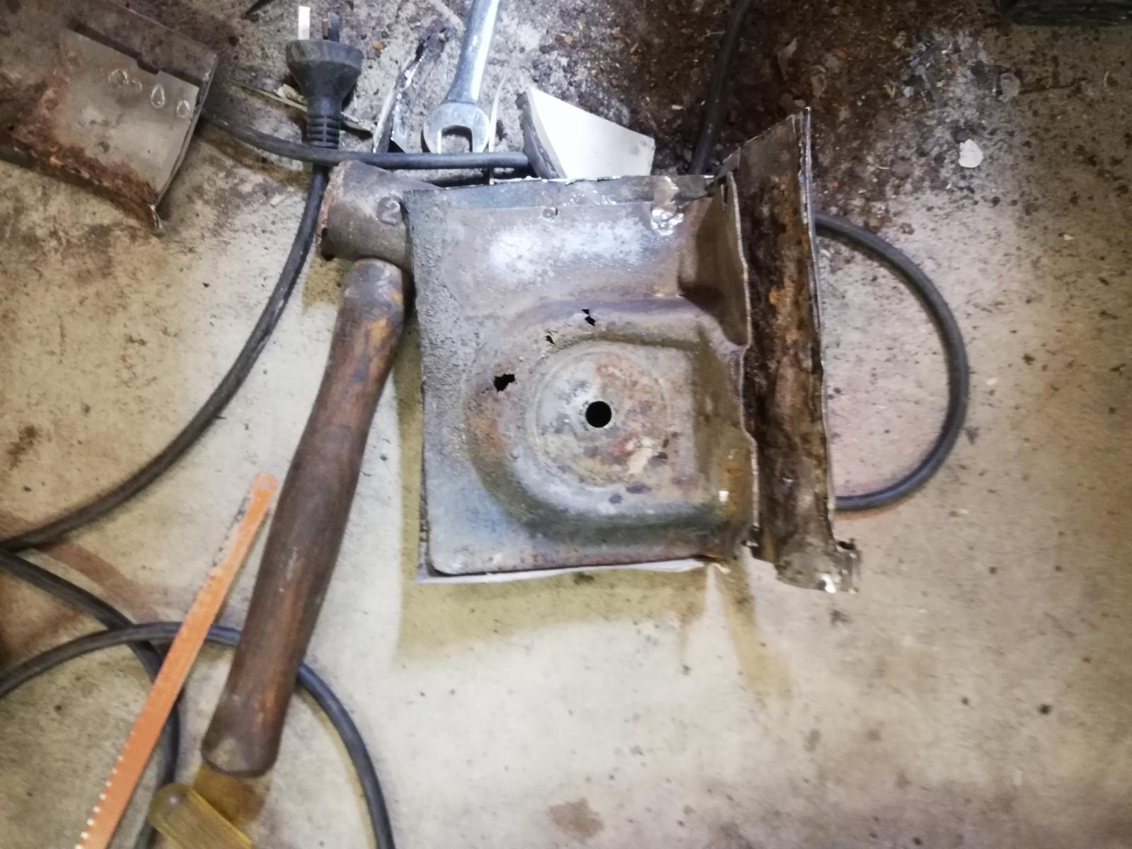

  23. #273
    1,222
    Chop it up. Again with a replacement sill over the original, hammered in, bogged together.
    Figured the floor/body mount would be rusting out between kayers, more the same as the other side.
    Chop it all out
