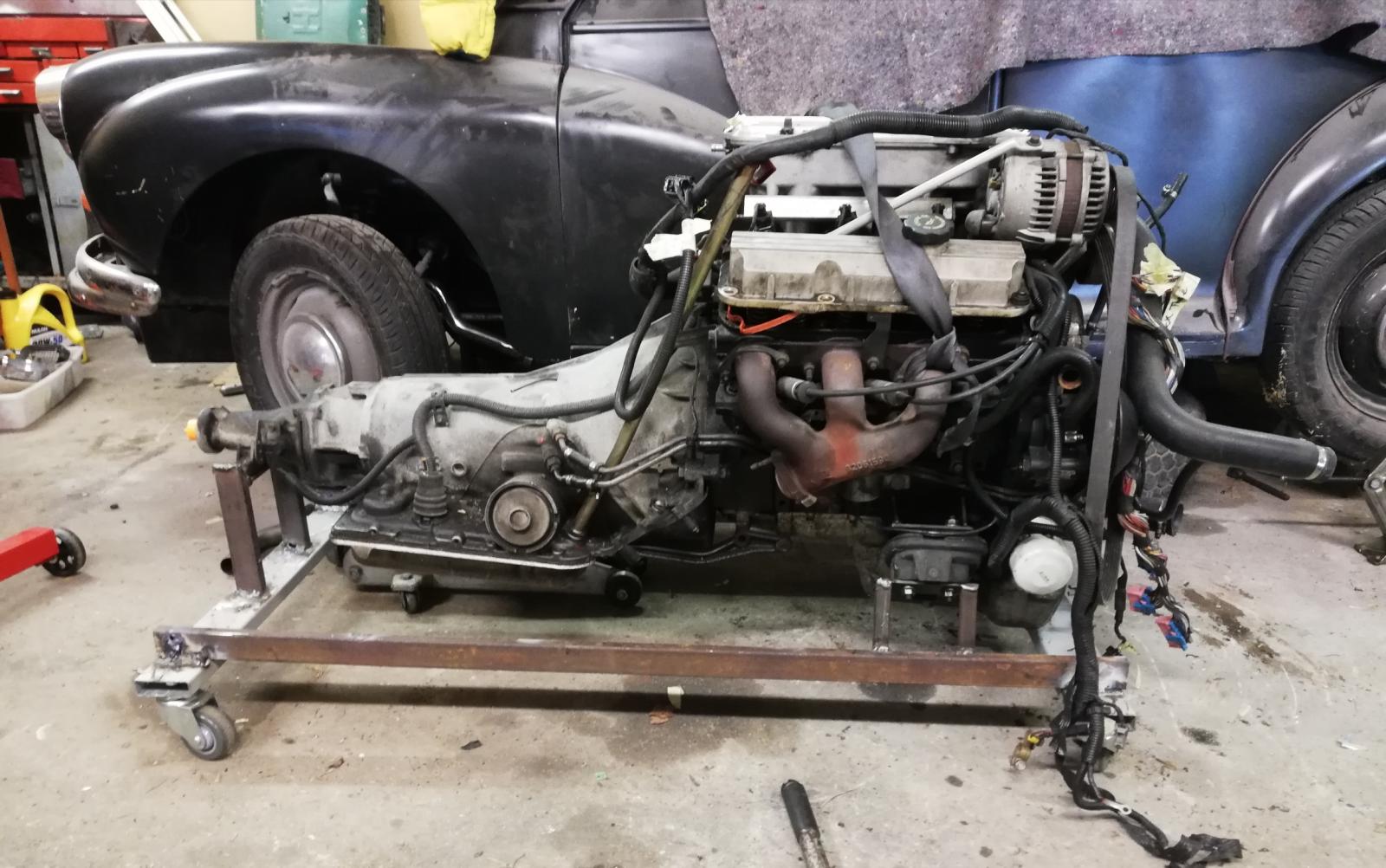

    New engine keeps getting in the way. So knocked up a sled to move it about.
    With the rain this week I might do some more work in the tray

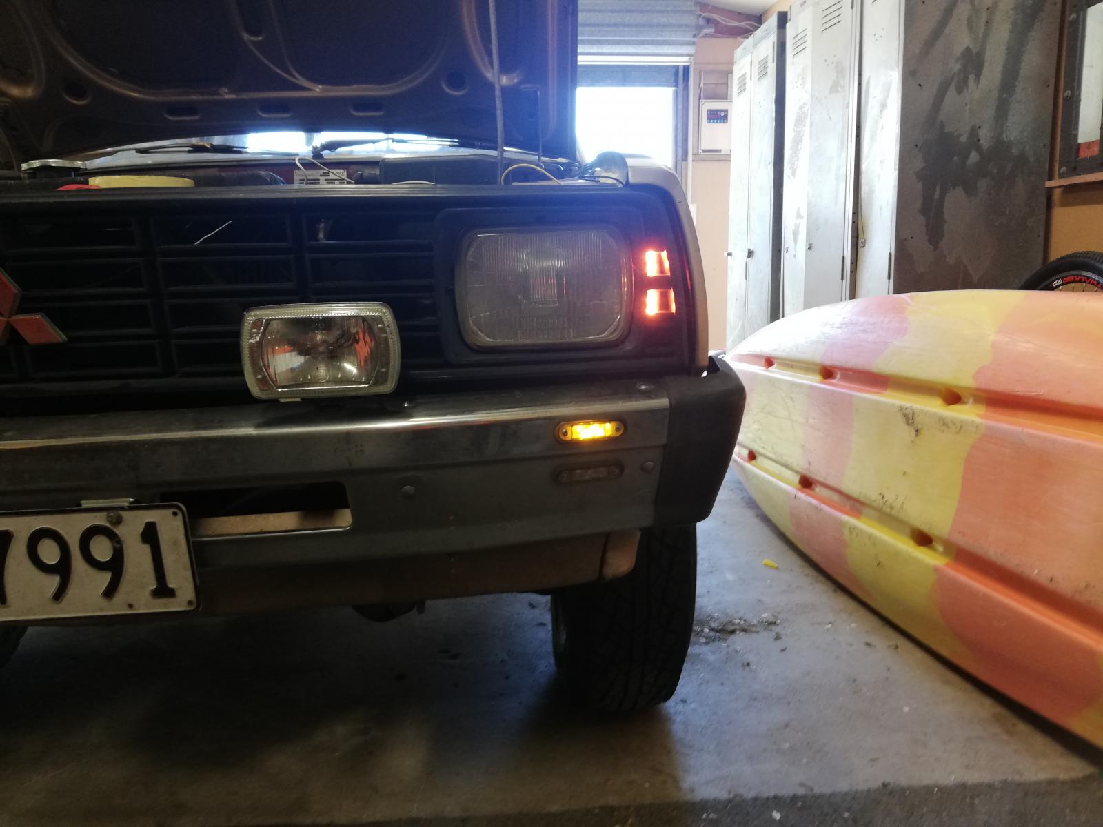

    My front indicators are some sort of Hella led unit. Not really designed for indicators I think (the ones they used as park lamps are twice as bright).
    My bumper is also not designed to take a lamp housing. If this is original I don't know. The brackets used are home made it appears.
    Anyway.
    I have felt they were not really good enough for a daily driver, and I would quite like to not get t boned. So I set about putting some behind the grill.
    I settled on some basic slim led units. I'm going to slather them in silicon to keep any water out.
    I drilled two small holes in the grill for mountings, which will be hidden with some black painted bolts.
    My loom is a little hacked in this area, so some new plugs for both the new indicators and side flashers were needed.
    Current set up
    And in place
    And all going ( oops, my hazard relay wasn't working either)
  7. #207
    Hmm, nice and discreet. Geezer approves That front bumper is weird. No cut outs for parking/indicator combo lights. I bought a big kit of replacement harness sockets cheap from the land o' ebay. Just going through all of the connections and fixing them up while doing mods to the harness. It doesn't cover all the plugs but will do the majority of them.
  8. #208
    1,222
    I'm going for deutsch connectors for water protection where possible. The factory Holden engine loom uses something very similar, so I also have a bunch left over from stuff I won't use. The bumper was factory, but maybe not for this truck

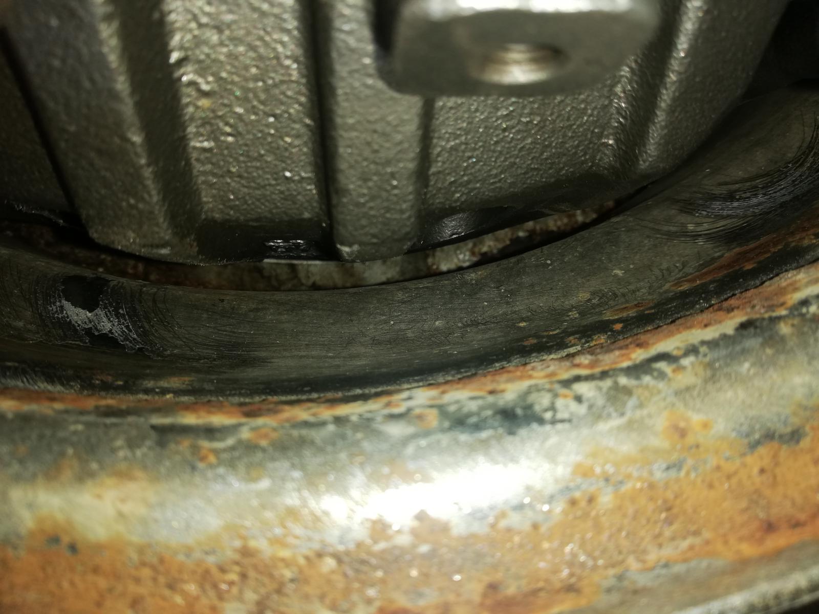

    OH BOY
    Ok i knew this was there and actually ment to fix it way back when i did the firewall, but ran out of time and forgot about it, until the suspicious blob of bog fell out of the sill last week. I can get a whole new sill made locally, which would save me some time. Am going to pop a usb endoscope inside and see how bad it is on each side. If i can just patch it then thats fine. If its too bad, i will replace the whole thing (and hopefully have enough of the old one to patch the otherside if im lucky).
    This one is a little worse
    right up behind the cab mount. The drain hole had been bogged closed............
    Might have to get creative with some jacks and engine hoist to get in there.
    At least once the sills are done i can fill all the cavities with waxoil or fish oil and not worry about it catching on fire because it needs further welding. Which i have been putting off for that very reason

    what is that black car in the background of the engine photo, post #203 ? Looks Morris Minor-ish
    Cool engine-tranny dolly. Do you still have it sittng like that ?
    Is it possible to get a similar photo of the front, and the other side ?

    Too many hours for an old Ute really. But I'm stuck in the trap of being able to fix pretty much anything so it always seems like a good idea.
    Yup that's my 51 Morris minor, there's a small thread in the other projects thread.
    About to strip the ecotec down. So I'll take a bunch of photos

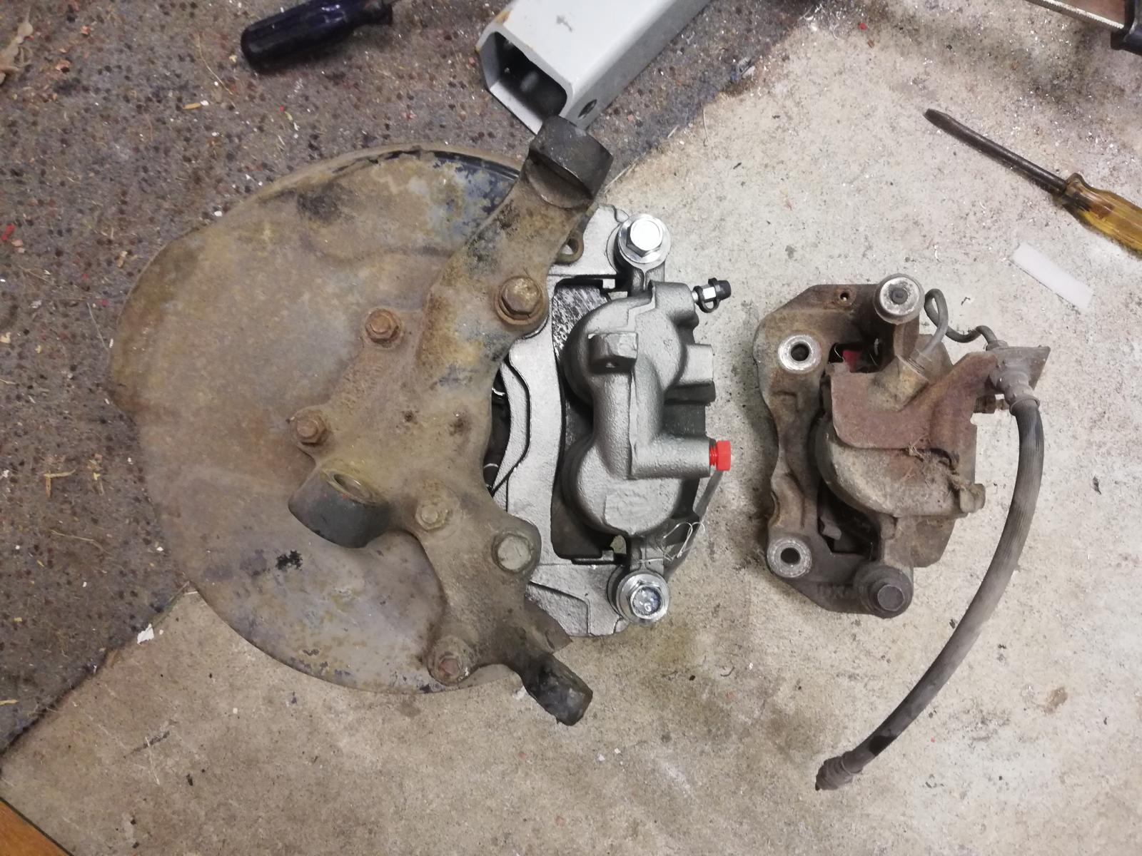

    And to go with the few extra hp
    A few extra brake pistons
    For those playing at home
    These are 2nd gen knuckles (same truck I got my diff from)
    With front calipers for a 1997 Mitsubishi Montero sport 2.4L L4
    I just bought some refurb units instead of pulling some at a junkyard yard (none around right now plus I'd rebuild them anyway. This saves me a few hours cleaning) so I'll take the hit on no core to return. Better option than the reproduction ones I see I think
