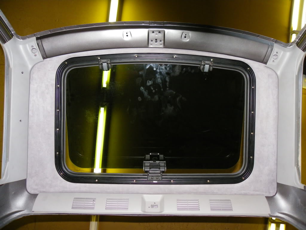

    Your roof liner looks pretty good tortron - what is holding it in? As for Fordubishi, the tilt out sunroof rocks.

    The plywood panel is larger than the opening. So it holds itself in place. I.e its wider and longer than the 4 edges of the door, and windscreen inner panels, you slide it right in towards the back and sort of work it in place like a bicycle tyre, then centre it. The 3mm was a good fit, add the foam and vinyl and it's tight in there

    I used poster board, then thin foam padding and velour cloth and slid it in like yours. I also have the plastic trim from a later 1st gen - perfect fit - pics of it in Geronimo's gallery.

    Geronimo's gallery is pretty cool pennyman, love your truck top to bottom... I see these nice headliners but wonder how they actually get installed..? Think I understand how their slightly larger size keeps them from falling... The interior metal trim has some screws, does this mean some of it gets removed to slide in a headliner panel..? Happy Truckin

    If the screws are likely to be in the way, but I don't think any would be at the right length and angle. What I did was start at a rear corner and push the panel in as far as I could both back and to one side, until I could get it in far enough to have room for the other two sides to slot in. Then manuver the panel central.

    Thank you for that tip tortron ~ seems you & pennyman got this figured out... Am thinking the panel edges need to be almost an exact shape of the hole it gets put into (?) Maybe I should read more of the forum posts BUT it would also be nice to know approximately how much bigger the panel can be than the overhead hole it goes into (and still fit)... Am also assuming no support is needed in the headliner's center to hold it from sagging or moving... So, the finished product rests on the cab sheet metal border & NOT attached to the cab roof..? Do you think the original headliner was attached to the roof; if so, this would allow more headroom... Those Japanese did some puzzles & magic tricks making these little trucks, ya think..?

    I believe any trucks that came with a headliner had them glued to the roof skin.
    I didn't like the idea of foam glued to my roof and rusting away. Mine was zinc painted, sound deadened, then the panel. Which is 3mm ply and supports itself. Maybe 1cm is overlapping on each side. Mines also quite thick, so it holds itself in place so it won't rattle out.
    I'm 6ft and have plenty of headroom
  9. #159
    +1. If your truck had a headliner, it was spray bonded to the roof turret (and not a lot of it either). The foam will eventually decay and the headliner vinyl will flap in your face. The paint under the factory headliner is sparse but IDK if poses that much of a rust risk (more likely around the edges of the cab but not so much in the middle where they didn't hit it with the topcoat colour) The roof turrets really need a sound barrier/dynamat on them so it stops the cab from feeling the pointy ends of weather and soak up cab vibration/road noise.
