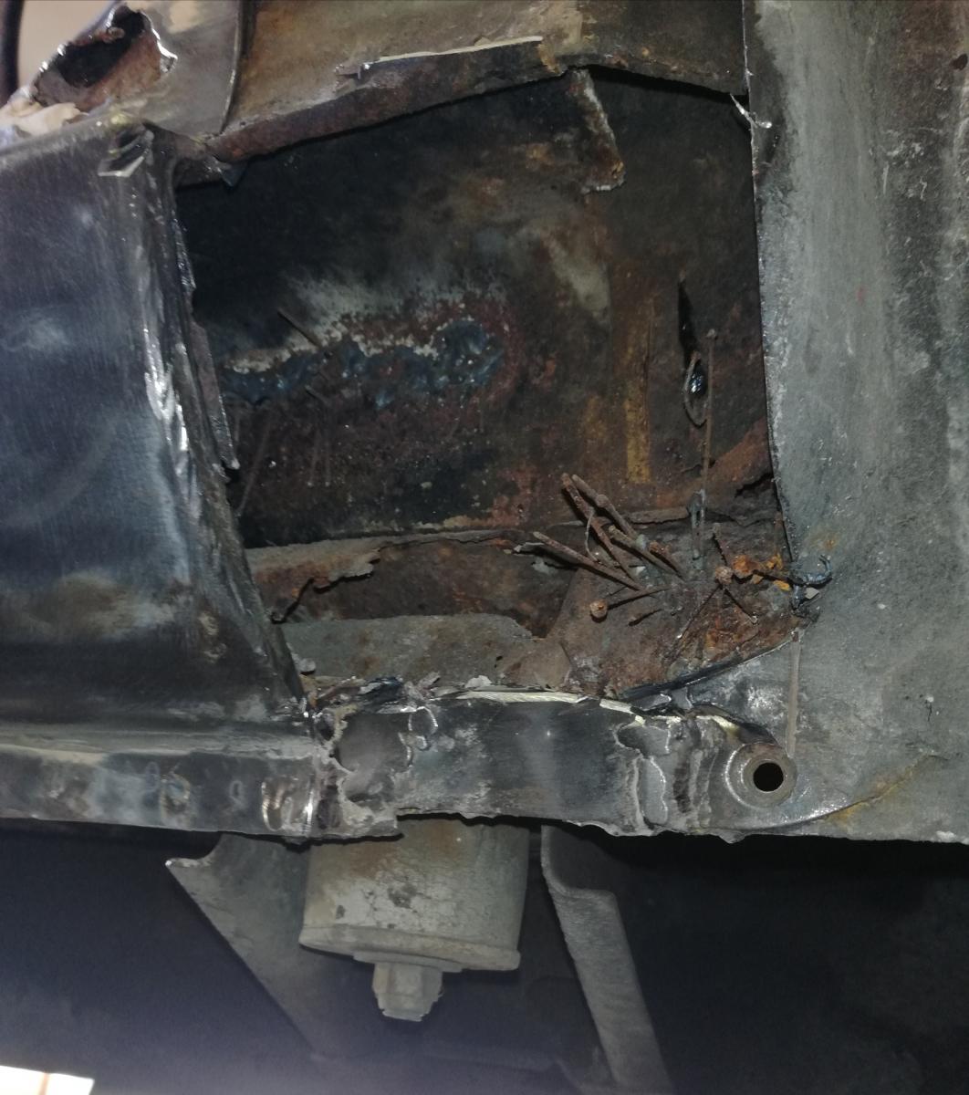

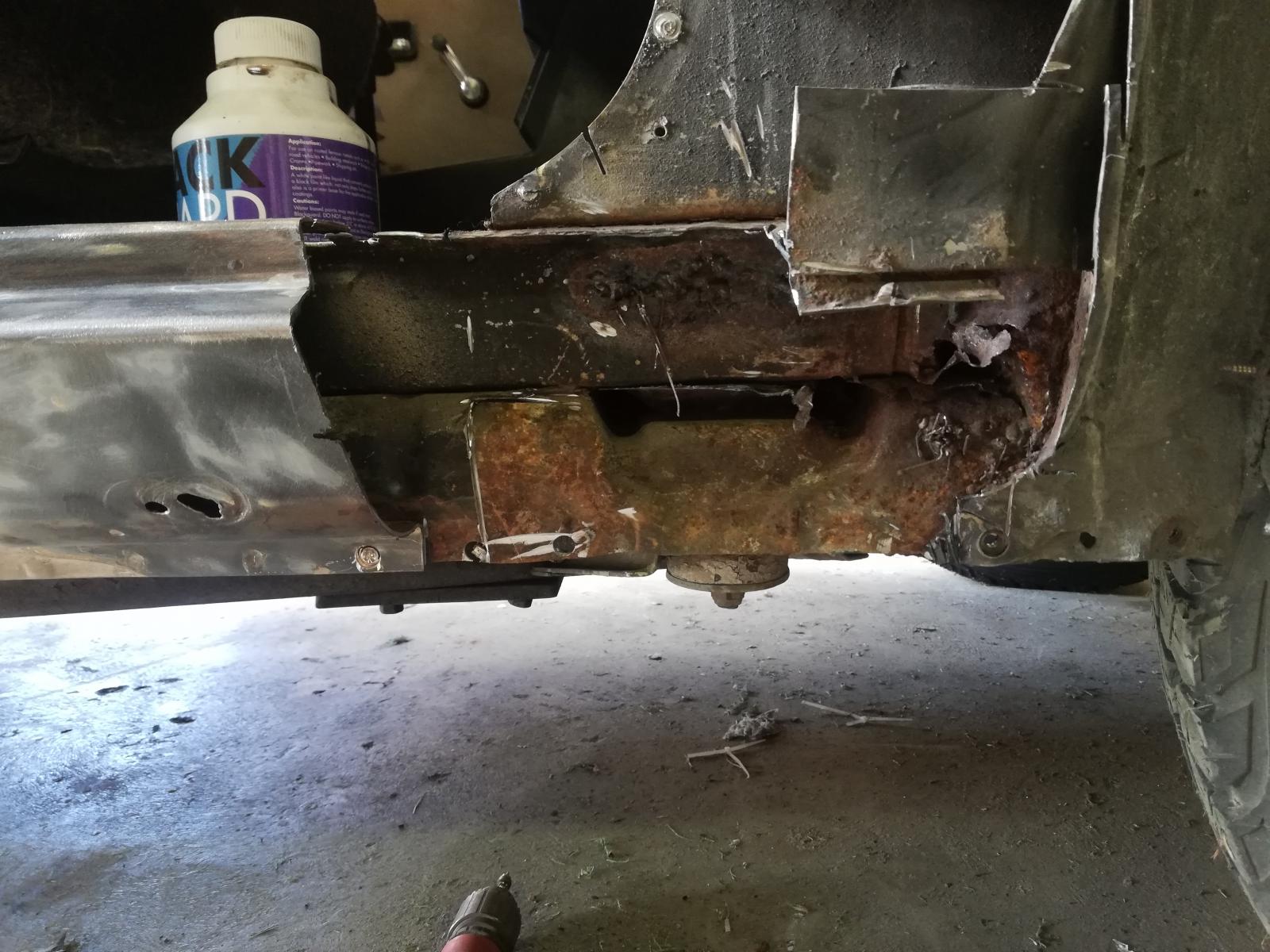

    Have to cut some sections of the lower door frame out to get access.
    This is the most of it cut out
    Its pretty extensive. Also today I learned that the front cab mounts are 3 layered. Guess which one is rusted through...
    There's some crusty repairs in there, so il tidy up what I can. Not too worried about how the floor looks inside but il make it solid again. To get access to the inner layer of the cab mount I have to either cut out the footwell floor, or unstitch the thicker underside plate. I don't have time to do either right now, so I'm going to leave a nice flange on my patch to tie into when I do. (I'm probably going to have to take the cab off as there's rust in one of the rear ones too.)
    Otherwise there's several inner sill sections that need totally remaking.
    Coffee break now, into the fab soon

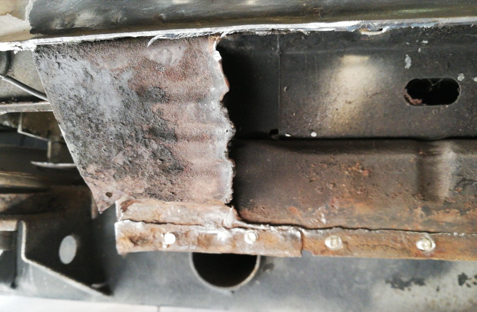

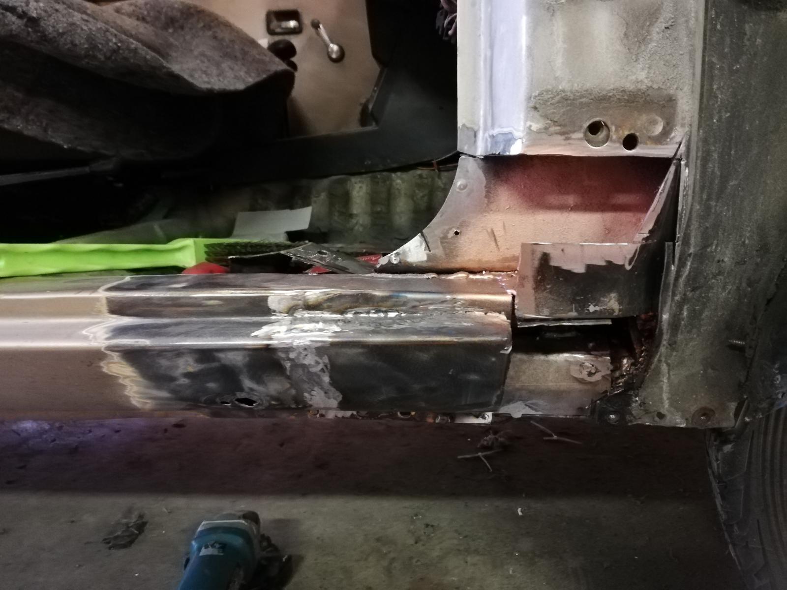

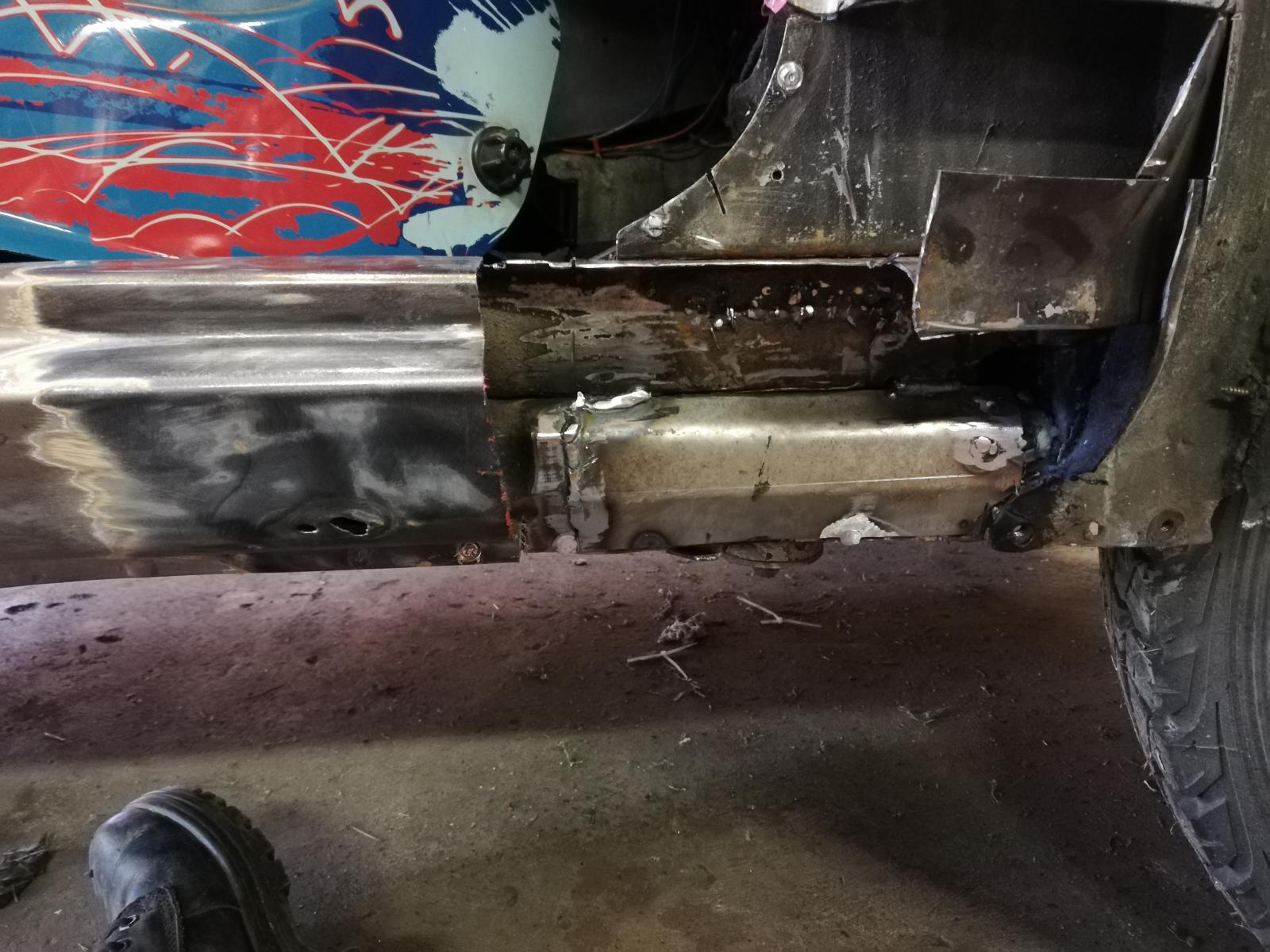

  6. #231
    1,222

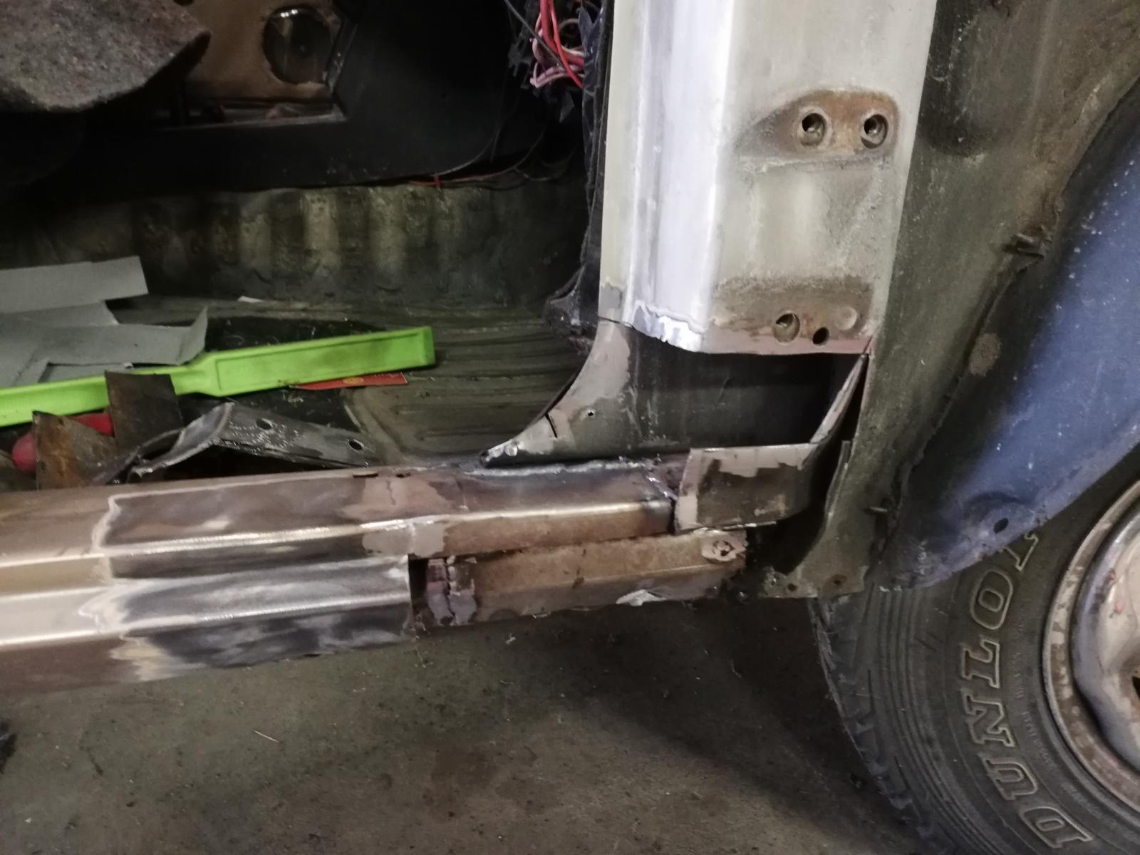

    Ground out all the blobs
    Made a new inner piece
    Made a new upper sill section
    Reattached the bit of sill I cut out.
    Have also reattached the bit of lower hinge panel I cut out.
    Need to now make up the step down bit of sill that goes at the front, reattach the section of door frame I removed. Make up some bits to replace the rusted out bits of door frame I have removed

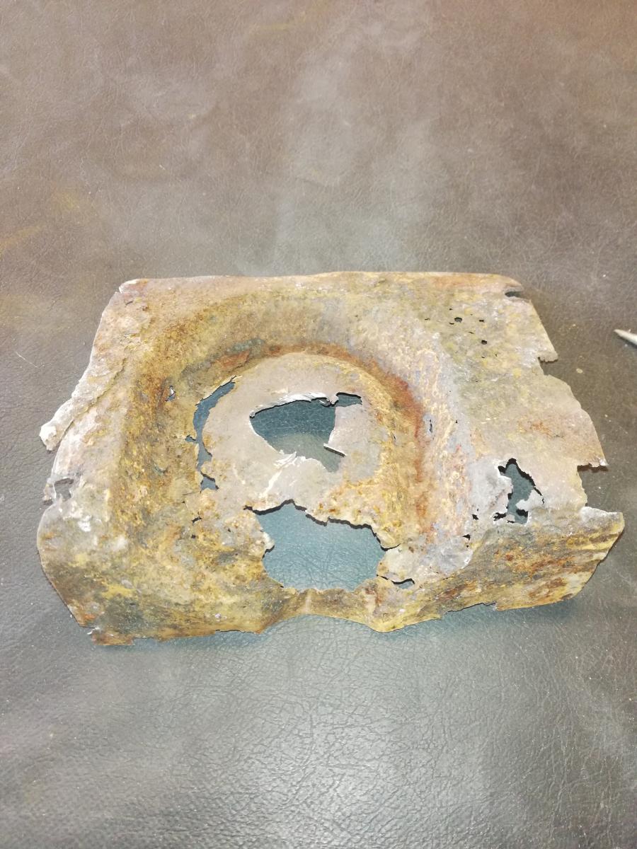

    1,222

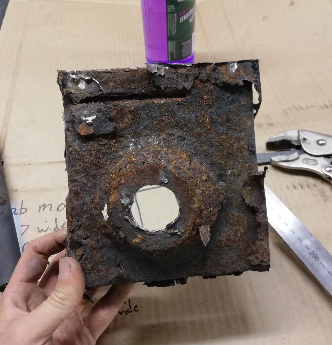

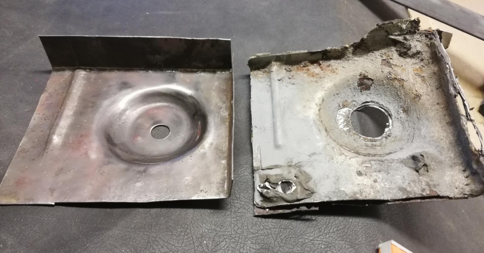

    So. Small issue
    This is not the floor. This is the inside cab mount doubler plate. The floor here is totally gone.
    Just 2 spot welds and some tar holding this corner to the chassis.
    No good, more and more fell off it as I handled it. Have to make a new one.

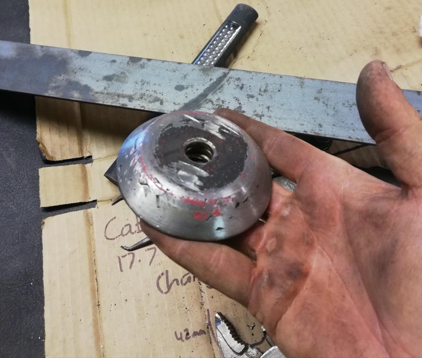

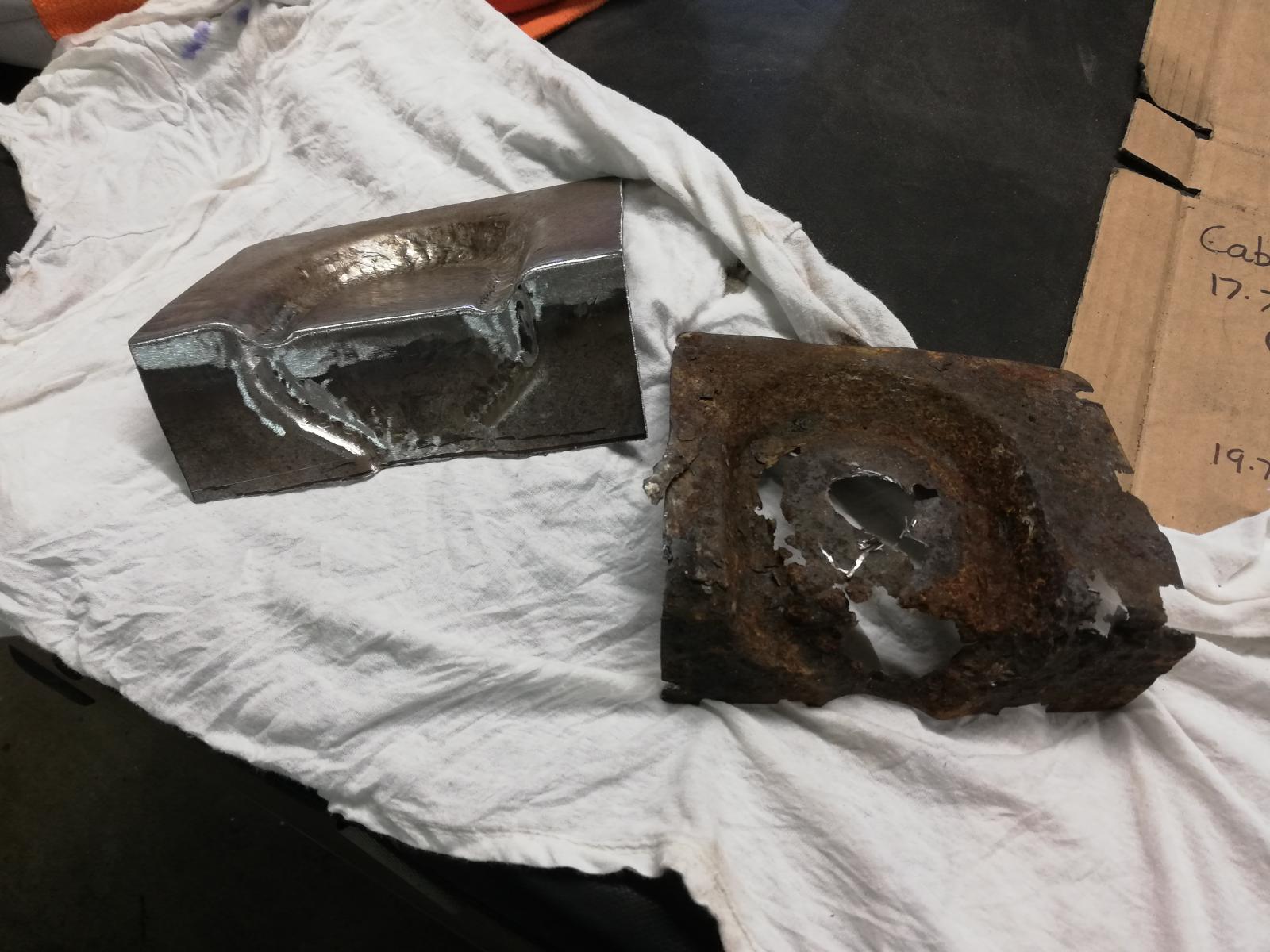

    So i made a dimple die
    I needed 15mm thickness. I have 5mm flat bar and a welder.
    I also don't have a lathe, I did unspeakable things to my drill press and bench grinder. Some 17mm ply made the female side.
    I then put in the small ridge with the edge of some 5mm flat and my bench vice, and bent up the edges. Will trim to fit later on

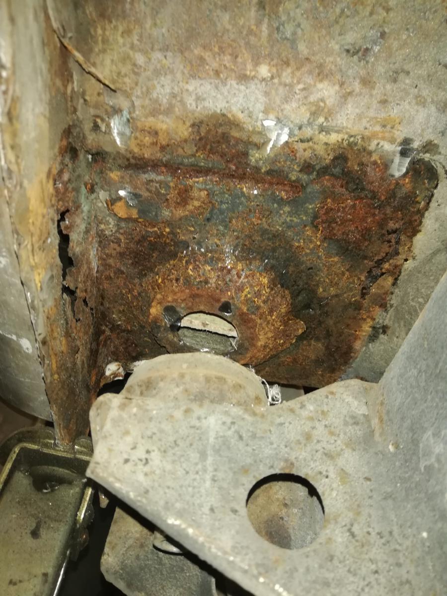

    1,222
    This is why it's a rust trap
    If anyone knows if the floor section is more than just a flat piece with a dimple for the mount please let me know

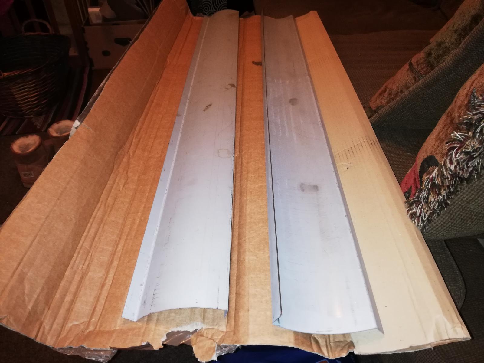

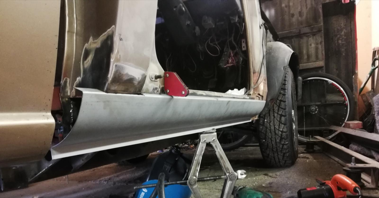

    Got to work away from home for the rest of the year. So instead of making or patching the sills I bought new ones from a bloke in the South Island
    He makes 2nd gen ones too. Will mate them up to my originals and check how good they are

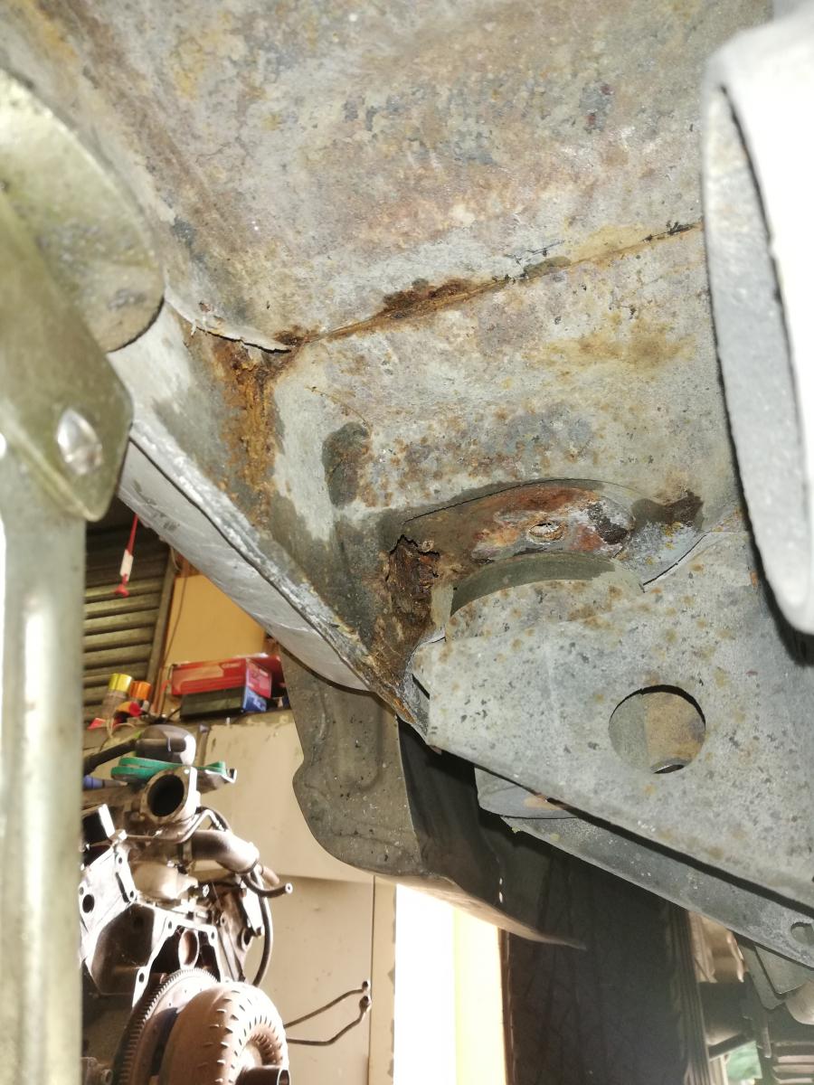

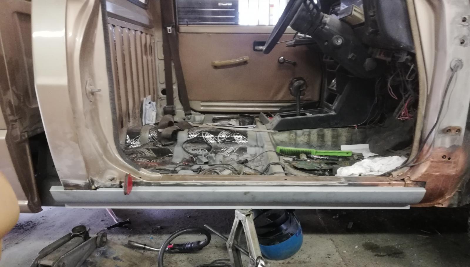

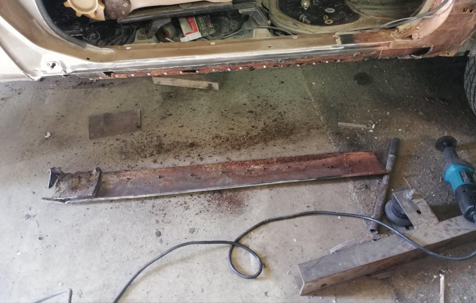

  21. #246
    1,222

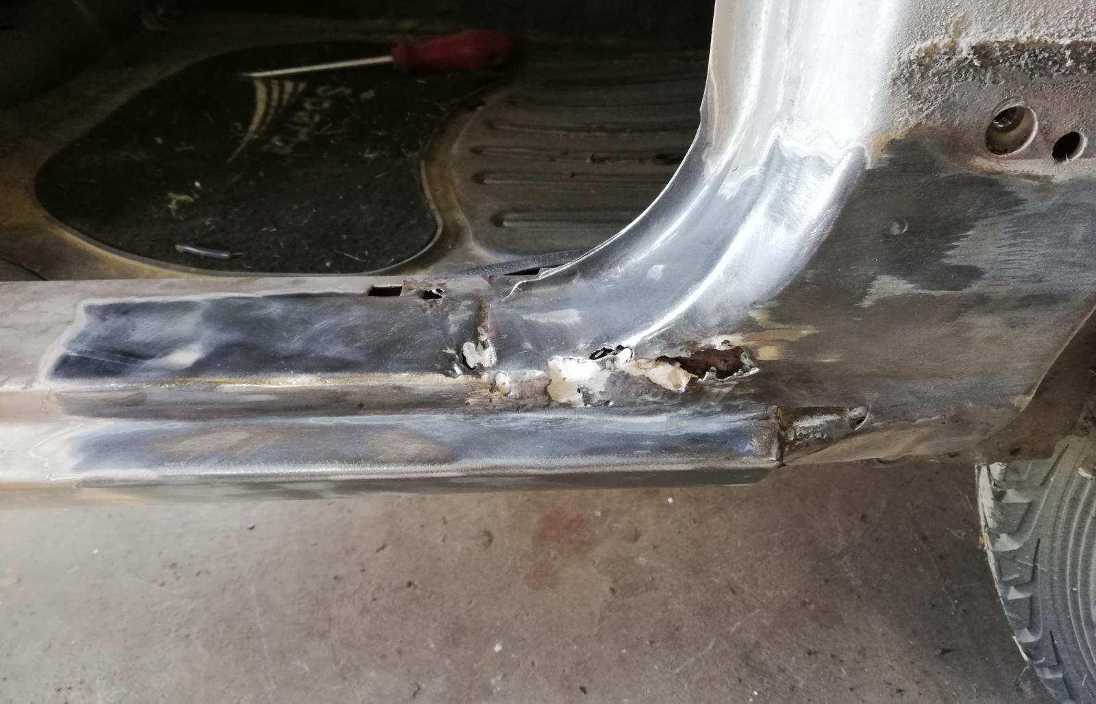

    Ended up cuttting the whole sill off
    Very wierd. I guess it has been replaced before?

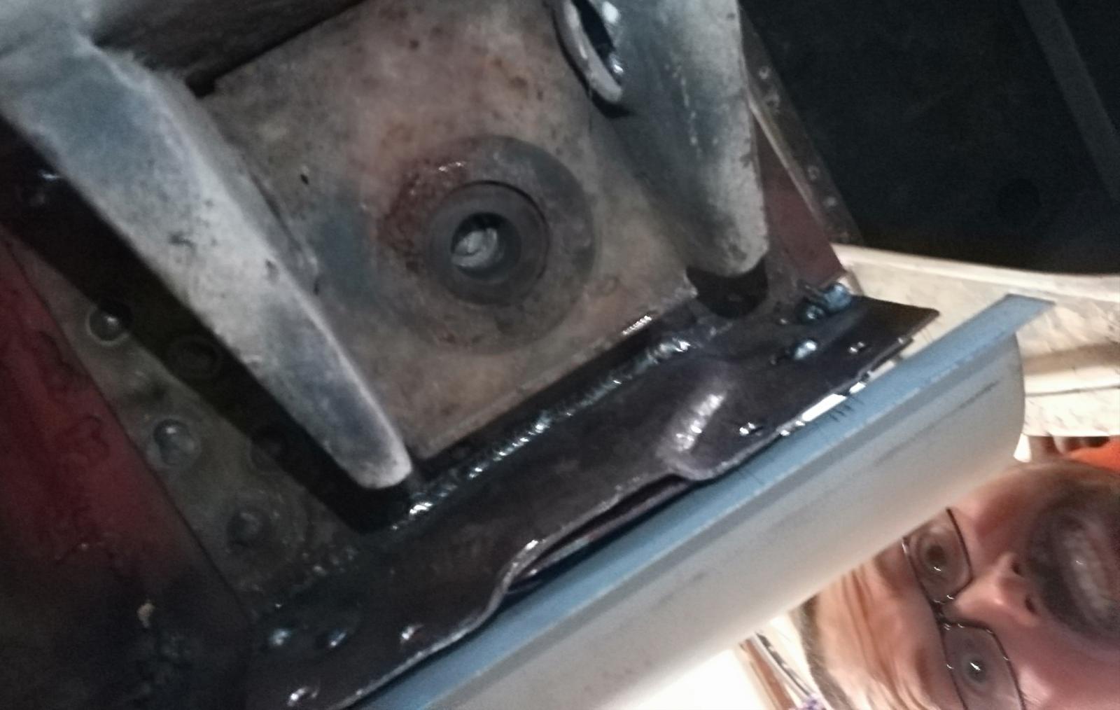

    Have now repaired the inner sill at the rear mount, and gone ahead and cut out the corner and part of the cab back/floor. It's just garbage previous repairs
    Most of it is coated with this tar sealant junk which keeps setting alight and is pretty hard to remove. Just let it burn to the ground I think
    Anyway. Floor is now in and I can line up the mounts and git er dun

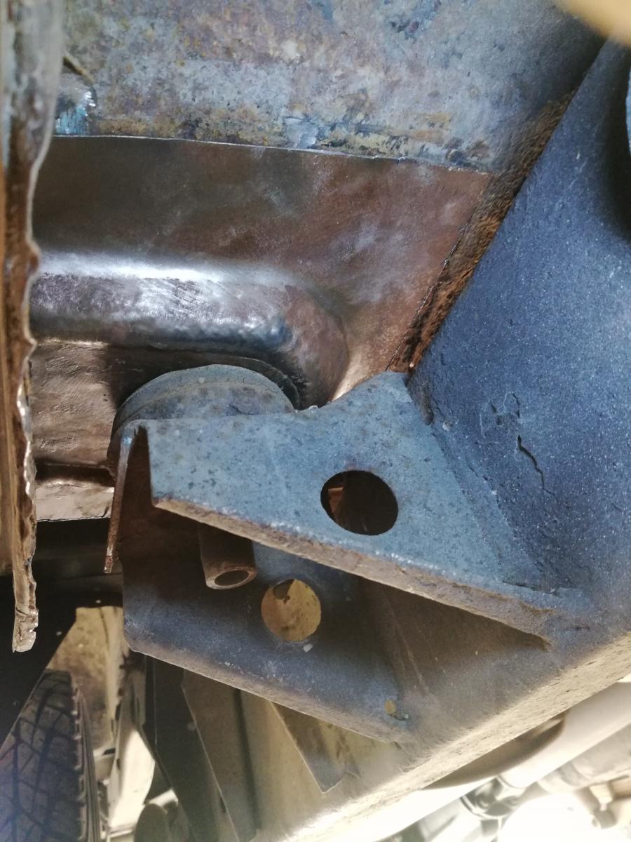

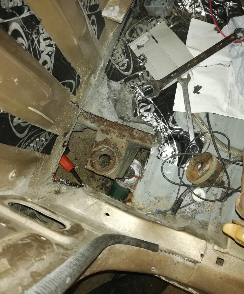

  25. #250
    1,222
    Hell of a job getting it all back in. But I'm making progress now
