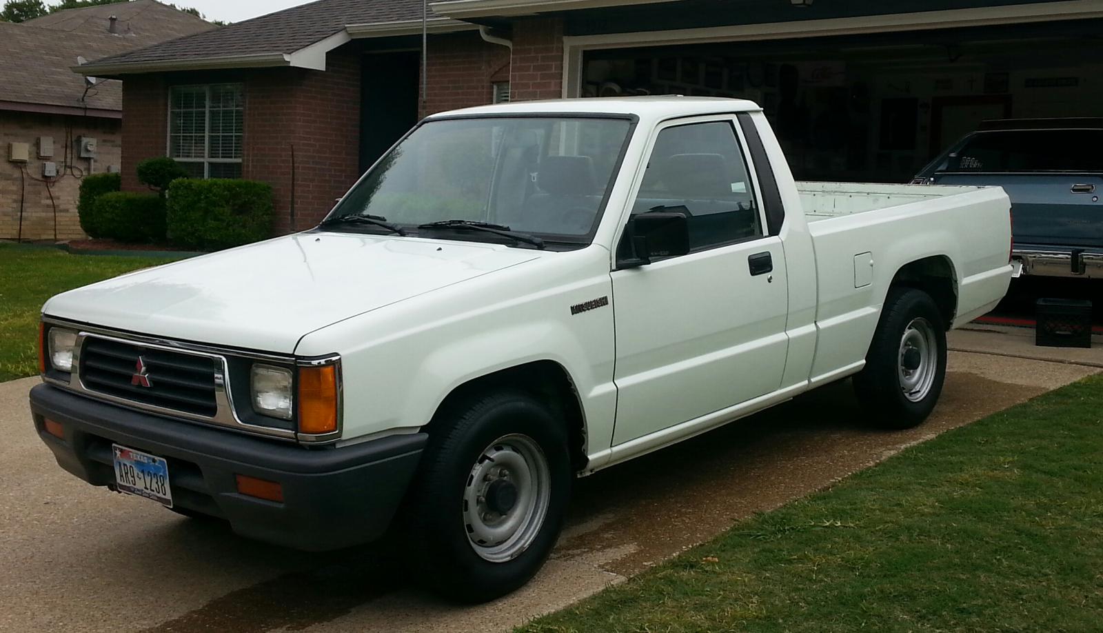

    Here are a few photos of the truck after a good cleaning. I also removed the back bumper, one because it was bent and two because when my Dad bought it didn't come with one. It's really funny how plain-jane this little truck really is. Bare bones transportation to say the least.

    What a beautiful specimen! There's much to be said about simplicity. This truck is a wonderful treasure, and you have no where to go but up, from here!

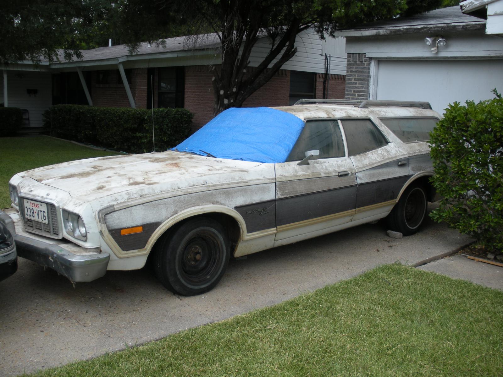

    Is that a circa '72 Torino wagon in the garage? Looks like you take good care of classics.

    Good eye, Yes it's a 1973 Ford Torino wagon "replica" of the one my Dad bought brand new in 1973 from McAnary Ford in Gary, Indiana.
    It took me about 3 1/2 years to restore her, but we LOVE it!

    BEFORE photo:
    1,271
    Wow, what a transformation! If you did THAT to a Ford, your little truck is going to be show-room sweet!
    Nice work and welcome to the forum. I use to like the Vista Cruiser for their curved roof glass. My parents owned a Dodge Sierra wagon with a push button Automatic.

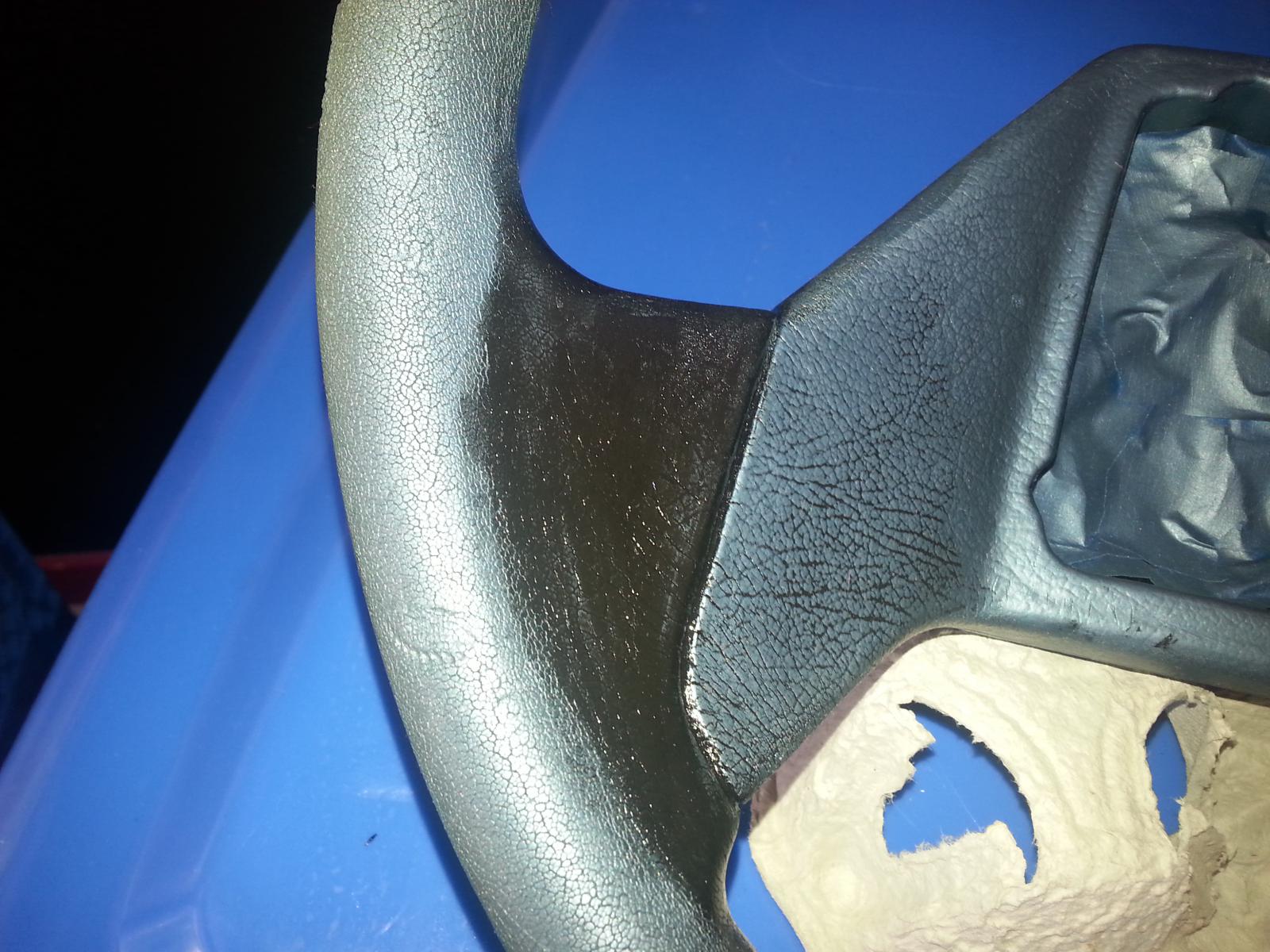

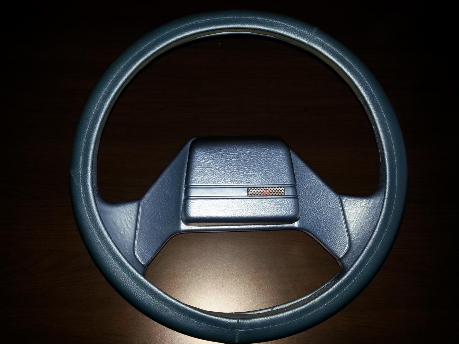

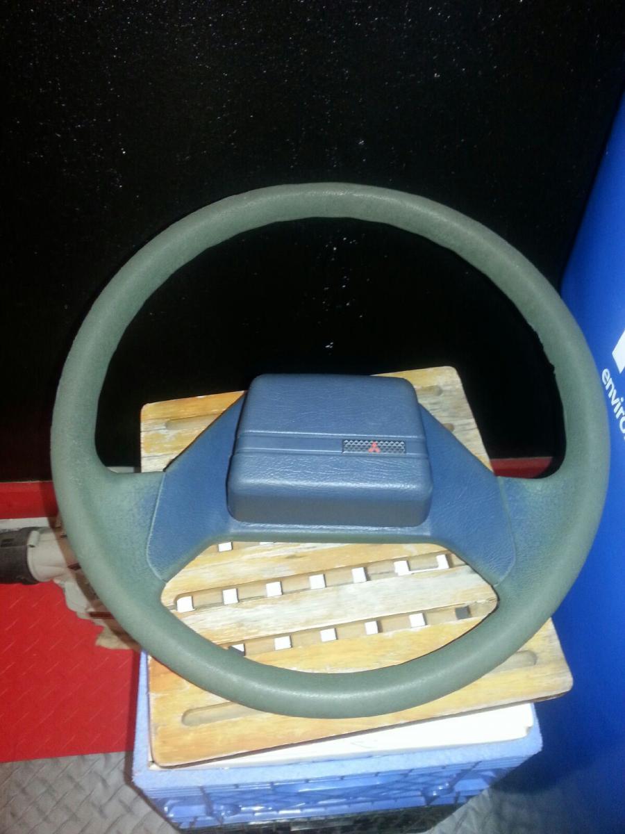

    I've been working on the steering wheel this week and it was more sun damaged than I hoped. I took it all apart and cleaned it up really good using POR-15 products. I used Marine Clean-Degreaser then let it dry over night before I masked it off and filled in the cracks with POR-15 filler putty/epoxy. After that, I let dry over night again and then used Klean-Strip Bull Dog paint adhesion promoter before I painted it with some vinyl dye. I then used some vinyl to construct a steering wheel cover, which I still have to sew on the steering wheel in a baseball stitch pattern before it goes back on the truck. What do you guys think?
    Instructional video from YOUTUBE (not mine): https://www.youtube.com/watch?v=sStxk4mv_DY
    Here are a few photos of the repaired wheel itself and a new clock I found at a local salvage yard.
    Most of these products were left over from my wagon restoration so I am not out very much money.
    1,222
    wow, great job on that
    Outstanding You even went the extra mile and made a wheel cover to match.

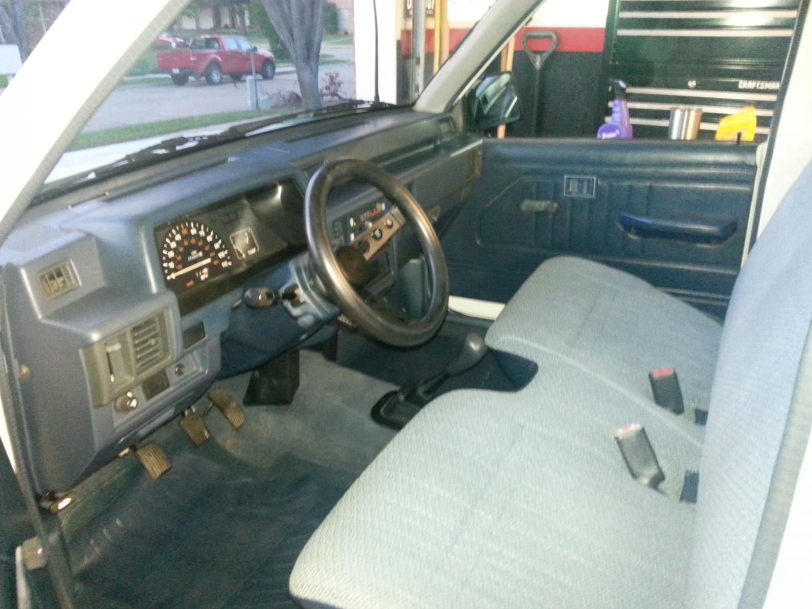

    Finally got the wheel back on...I like it!
    1,271
    WOO HOO! Nice job, and the whole cab looks great!
