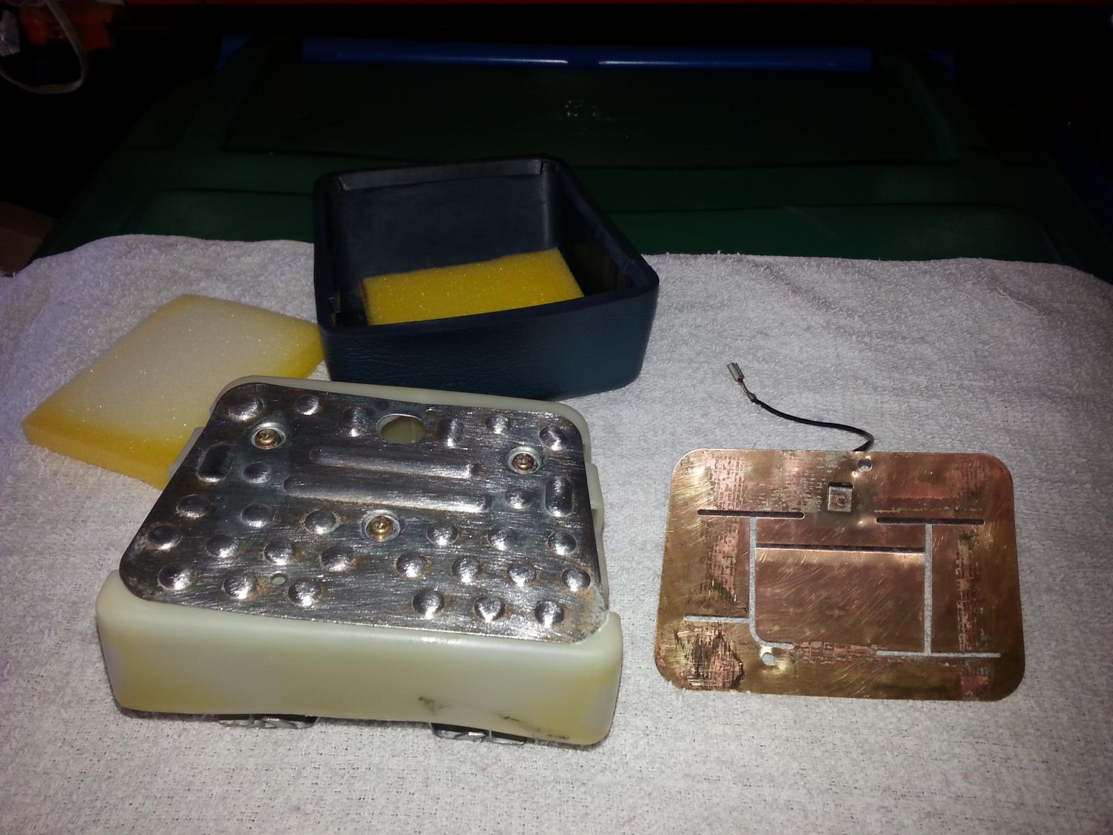

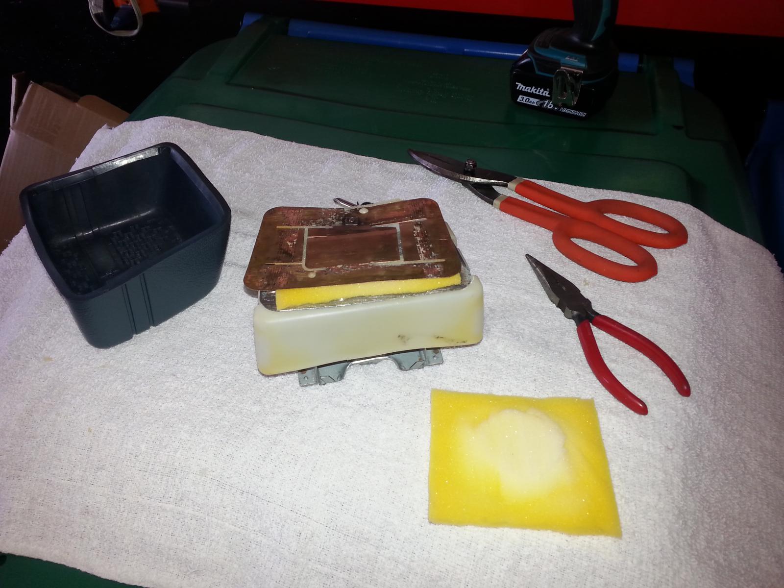

    This is what was under the horn pad when I got started. An old T-shirt with duct tape. Apparently either my brother or my Dad attempted a repair in the past that didn't quite work either. LOL!
    The copper contact was pretty dirty/corroded as was the metal base. I took a stripper wheel to the metal base and went online to see about cleaning the copper contact. Low and behold Ketchup was suggested as a cleaning agent. After about 30 mins of soaking it came out pretty nice.
    I had some leftover seat foam out in the garage that I used for the repair. I cut two pieces making sure only the middle portion of the copper contact made contact with the metal base when pressed.
    I ended up shaving the top piece of foam slightly thinner than shown because it made the cover bulge more than I liked, but it felt pretty good when pressing the horn pad. Unfortunately I still have an issue, but hopefully in the coming weeks I'll get a chance to track down the issue.

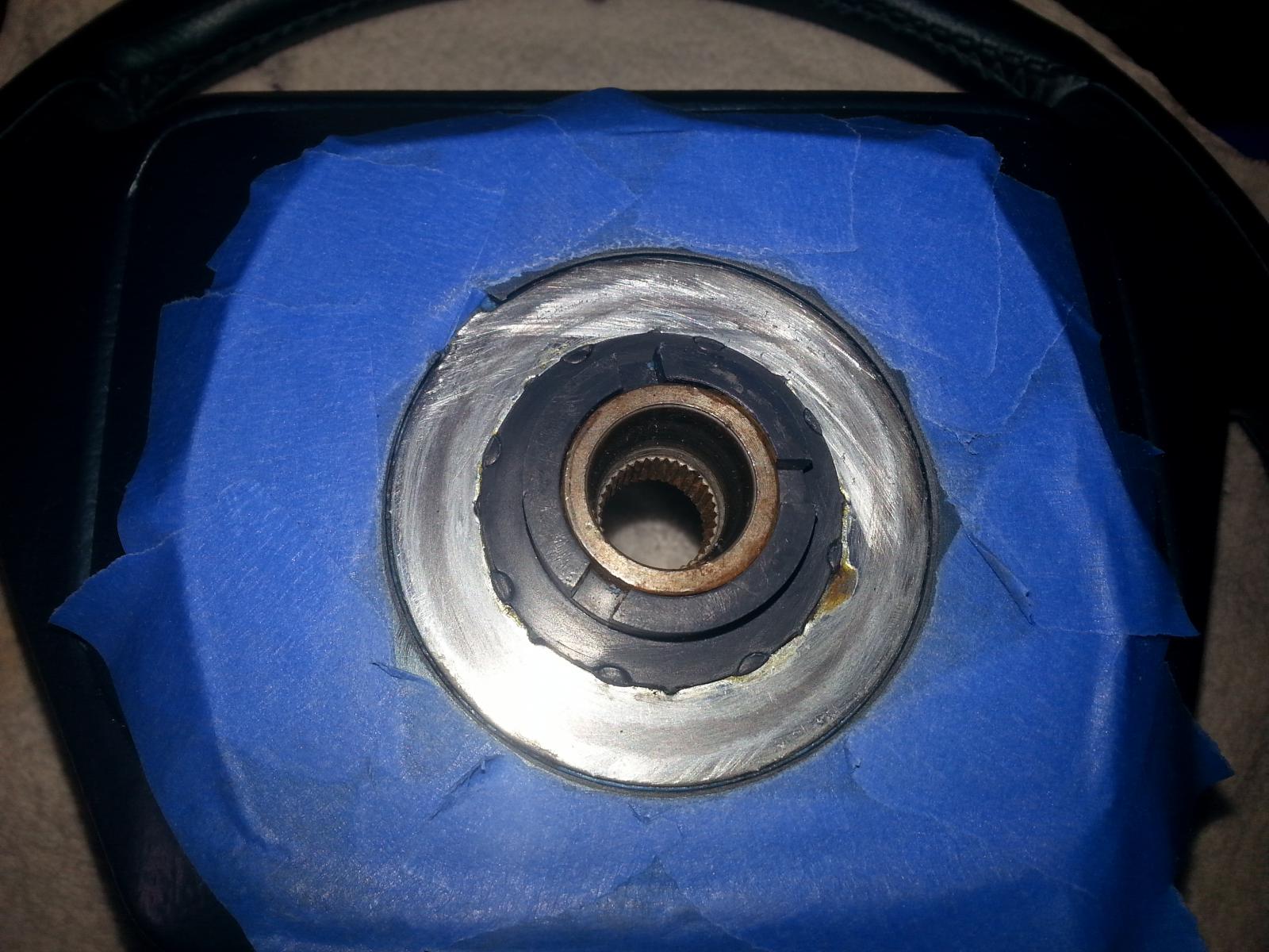

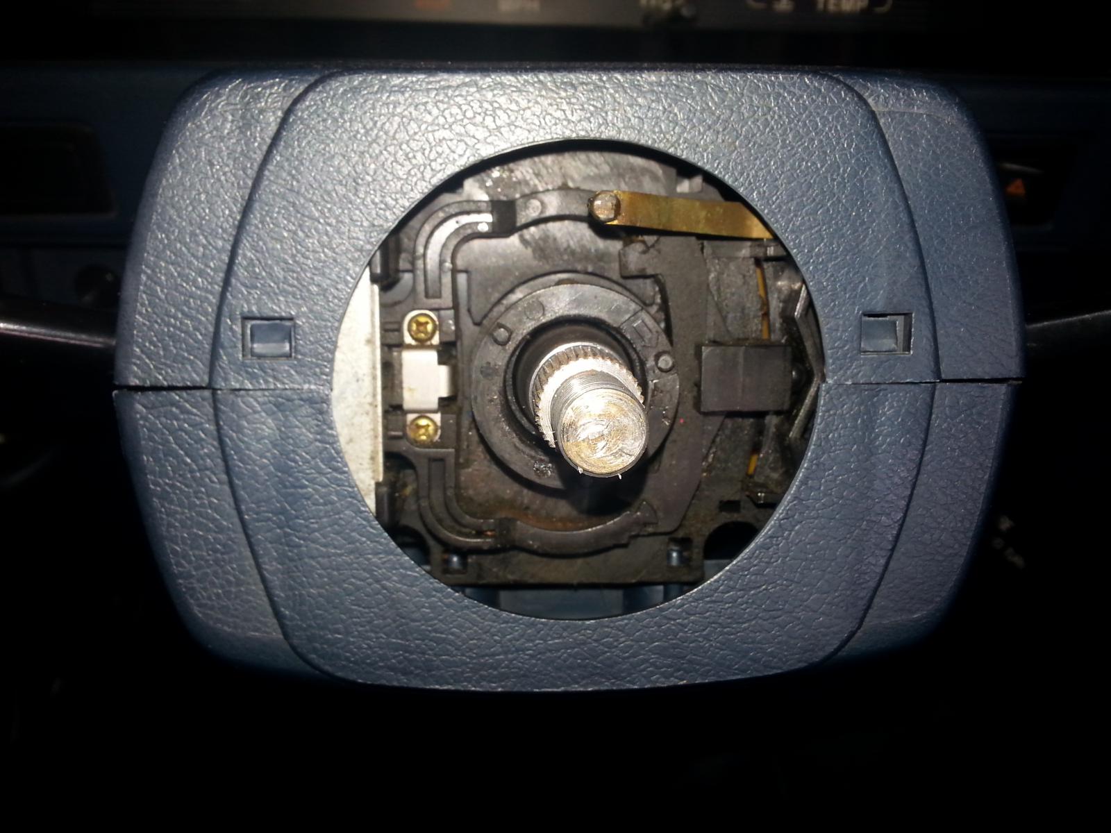

    Well attempt #2...I removed the horn pad, steering wheel, and disassembled everything for a good cleaning. Since I didn't take any of this apart, my brother did when he added the smaller aftermarket steering wheel, I'm assuming I have my wiring wrong maybe?
    This is how it was wired before
    This is how I re-wired it, but it still didn't work. (I did attach that little tab seen here to the wire and this is where the wire from the horn pad attaches.
    There is no copper ring behind the steering wheel like explained in the other post. http://www.mightyram50.net/vbulletin...ns-of-Colorado There is metal ring with a wire attached which is part of the steering wheel itself. A thin yellowish metal tab rubs against this metal ring making contact at all times. I cleaned all these contact points. If something is missing please let me know. This is getting a little frustrating.

    I did clean all the contacts and even played with the wiring behind the steering pad to no avail.

    It's fixed...
    I'm VICTORIOUS!!!!!! Guess who has been annoying the neighbors just driving around the block HONKING that DAM HORN? LOL!
    Apparently I was making contact at the metal base and copper contact where the wire is attached on top of the horn pad. I used tacky "home door frame" weatherstripping instead of the seat foam because it doesn't move. It stays in place so it doesn't cause the unwanted contact.
