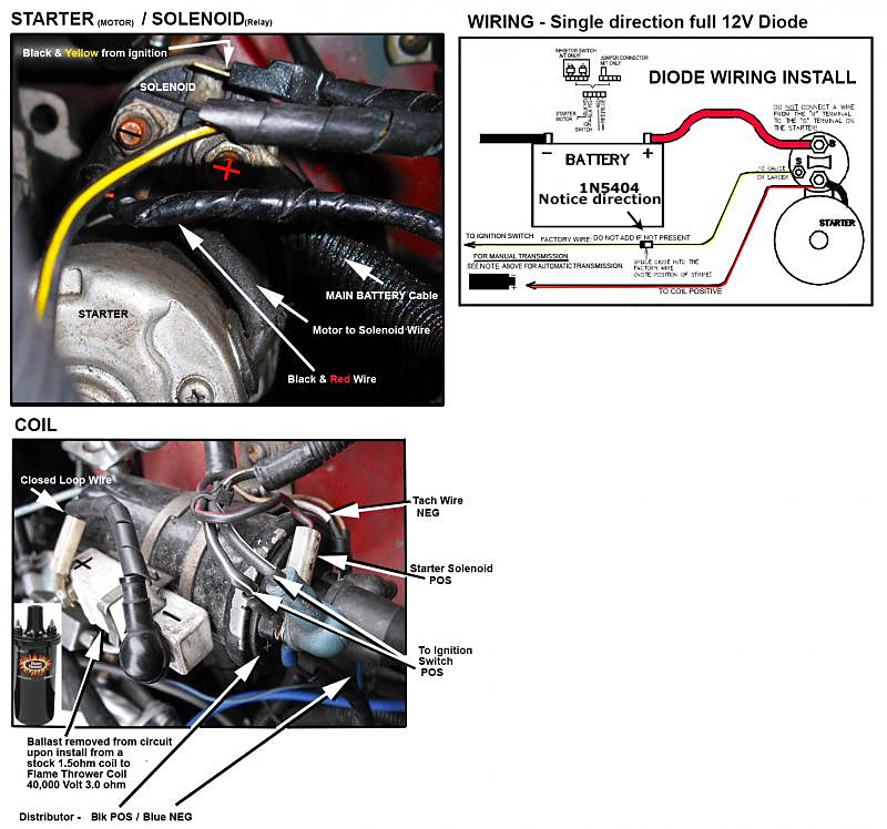

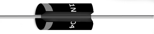

    Back tracing the electrical short and I found one exploded diode I used to protect the starter from a reverse polarity and to increase the voltage during the cranking start to a full 12 volts. I will replace the diode and wire and keep tracing until completed. This diode looks to be the culprit of a grounded power source and i hope it is the problem with starter pre-spinning in ACC. Should find out tomorrow after installing new wiring.
    1N5404 One Way Barrel diode
    Max forward 3 amp
    Peak inverse 400v
    Peak forward surge 200amp
    The diode cracked strangely like this image below
    That will do it if it is shorted - surprised it didn't fail open.
