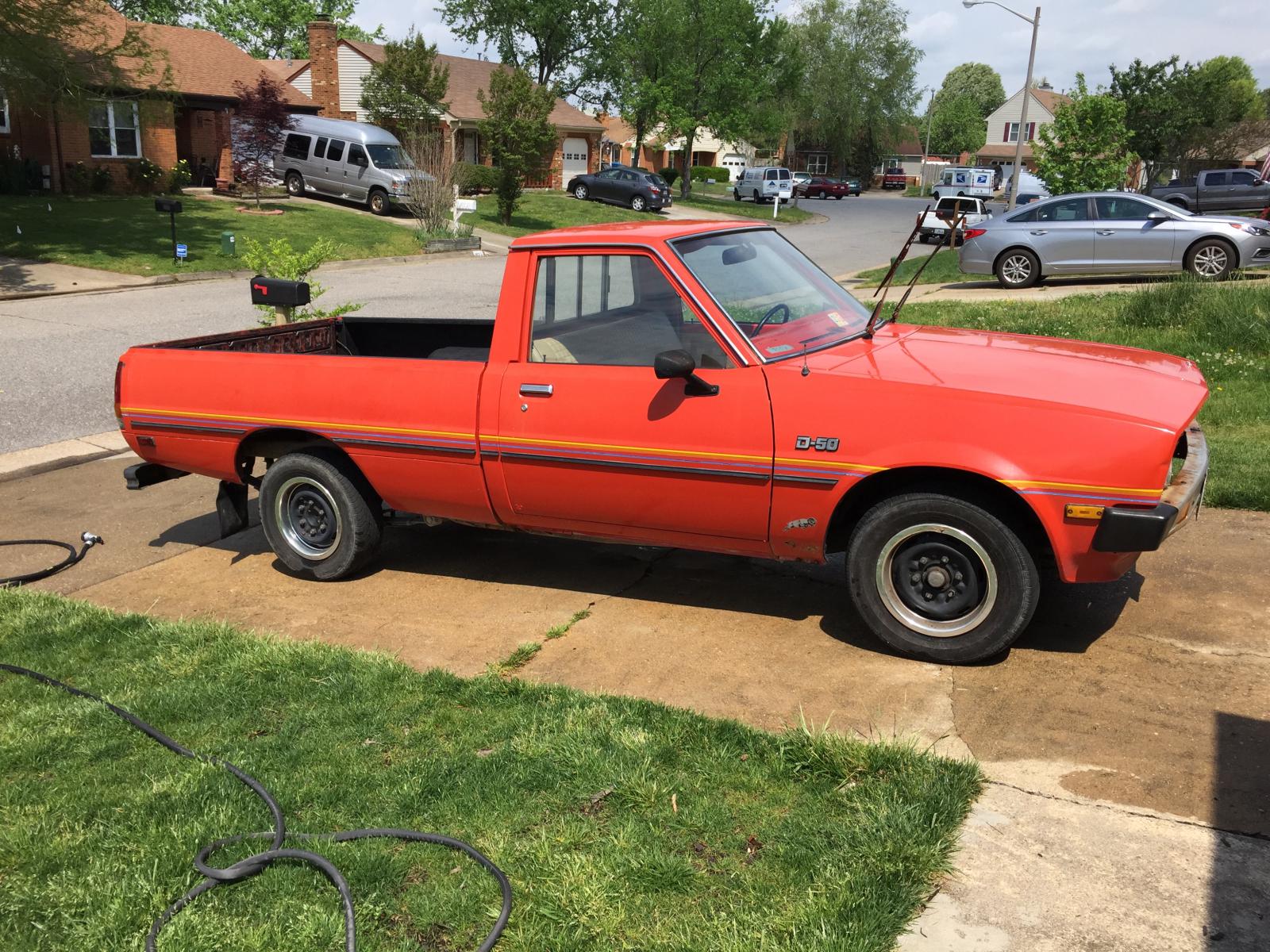

    Shes coming along nicely
    Seems to be the time of year where stuff happens in a mostly productive way. Looks tidy KC!
