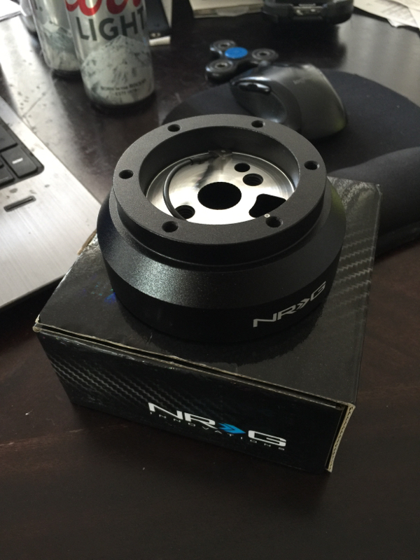

    Heres the hub. After lots of searching and finding different answers I emailed the manufacturer and went with what they said. Ill install it this weekend and hope it goes together with no problems.

    Hub doesn't fit. The splines are to big. This one is going back and I'm going to try out one for an eclipse.

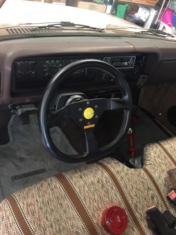

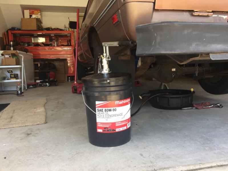

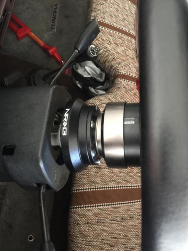

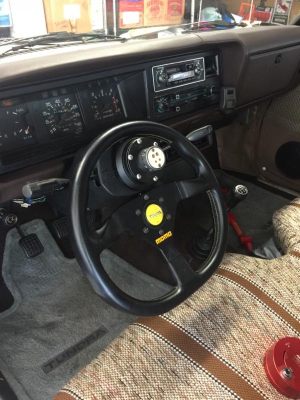

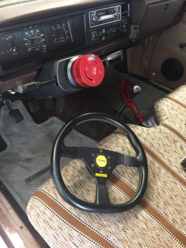

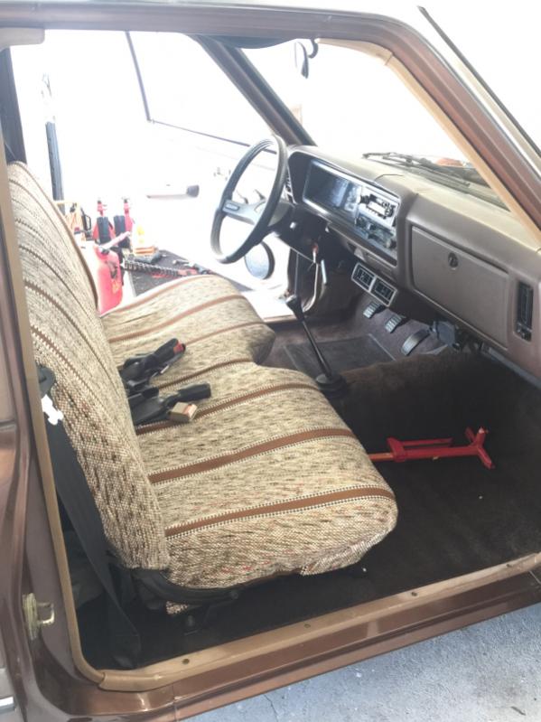

    Today I got to changing the Tranny and differential fluids. Drove around and got the everything up to temp. Then drained and filled. I also got my NRG aftermarket steering wheel hub paired with a Momo steering wheel installed. I used a steering wheel hub for the eclipse. The reason for the detachable steering wheel is for theft prevention. These older vehicles are easy to steal so i want to make it as hard as i can for would be thieves. Big shout out to NRG for working with me and letting me test fit the hub first before purchasing. image-2191180064.jpg image-1865233429.jpg image-1036204536.jpg image-3572257700.jpg
    Looks good phillie. I see you still have the old standby of the wheel lock/polo mallet combo. Little trick I learned with steering wheel locks - when you fit them, have the lock mechanism facing towards the instrument panel. It will take a lot longer to forcibly remove the lock. If they're determined it won't stop them but the chances of getting busted increases enough for them to think twice. You need a kill switch and if you ever fit an electric fuel pump, have another switch to disable it. Even if they get it started they won't get far.
    Thank you. I will do that. Its true, if they want it they'll figure a way to get it. I do need to fit a kill switch but if the buggers don't know about this truck they'll have a hard time starting it anyways. My glow plugs are connected to a momentary switch. If they don't warm up the glow plugs it won't start. So I kinda have a kill switch.
