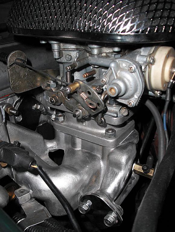

    Does anyone make a block off plate for the mechanical fuel pump on the 2.6 ltr engine in the 1980 Dodge D-50?
    Converting to Weber and don't want to leave the old pump on as I'm installing an electrical pump at the tank for the correct 3.0 psi.
    Summit Racing doesn't have one for the G54B engine ....
    I know companies make block off plates that look close to the 4G54 fuel pump gasket but not sure if they are a direct fit. Something like these? - http://www.ebay.com/itm/Polished-Alu...te9IsQ&vxp=mtr
