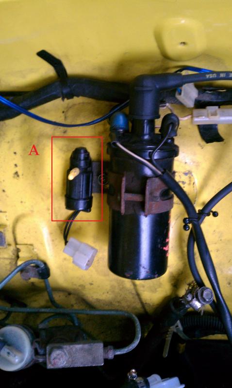

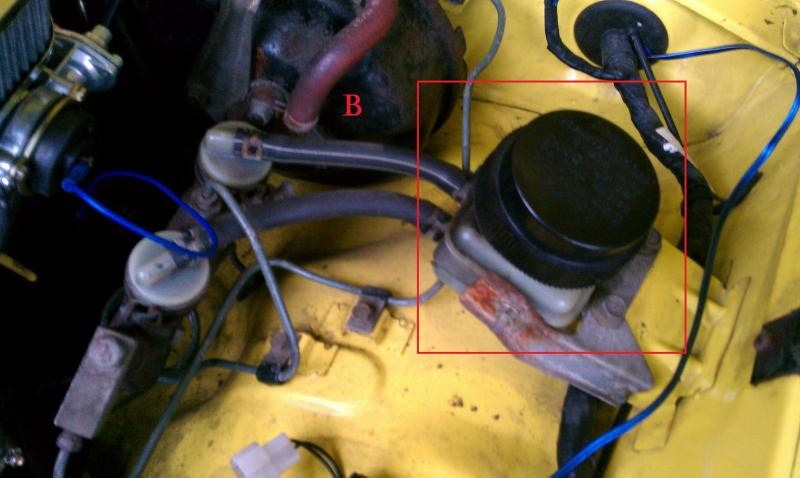

    Alright guys..... because of my lack of knowledge in some of these off parts, I need some help. I have taken pictures and put a red box around the part that is in question. If you need a bigger view, simply click on the picture and it will open it up in a bigger view.
    Left to right top. Brake fluid reservoir. Evap canister. Vacuum Advance. AC throttle kick up solenoid.

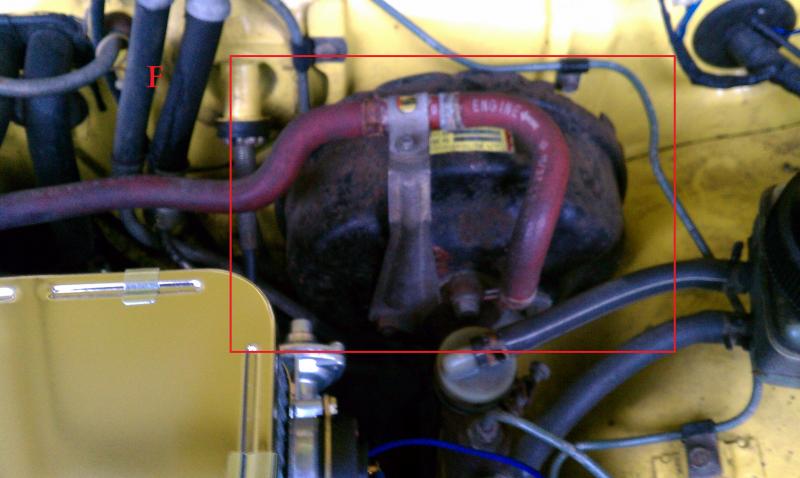

    How about these?
    Look at how clean that firewall is. Holey Crap.
    I can tell from picture D that your house is lower than the street or you park with the front lower the the rear.
    Mine is a 1.025" heim joint spacer.... aw Come on man,, you can do better than that,,,,. Uhhh-uu E is a uuuh ATR, Automatic Tampon Remover. ????
    Wiper motor. brake booster. How do you test the booster to see if it's working???

    Testing brake booster: first make sure you have a booster (I do not) then a) in traffic; run up on busy intersection, on yellow light vigorously apply brakes....if you go through intersection, run straight home, hide and go to b)
    b)in garage; get in and push brake pedal down to where it naturally stops with engine off. Start engine, if the pedal sinks a bit more then vacuum supply and booster are OK. Option b) is a lot less abrasive on the nerves and wallet.

    And Grumppa is correct on the testing.
