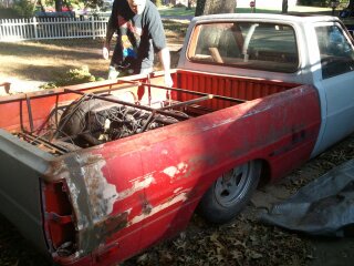

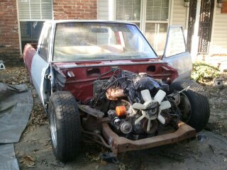

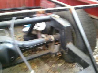

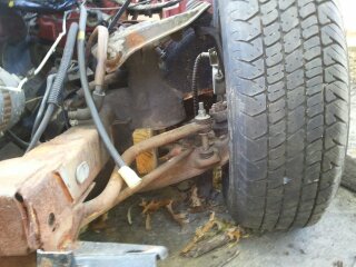

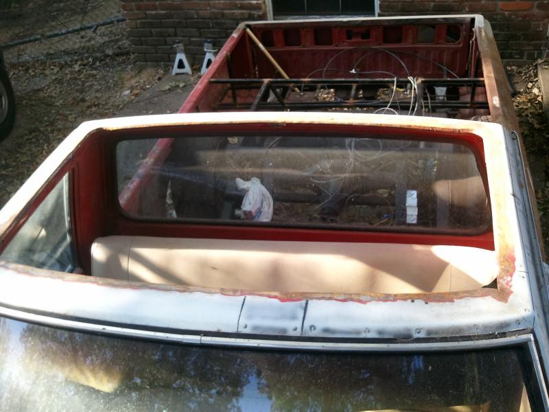

    So this is it. I bought it as it sits. I just need some jump off points! The motor and trans are both rebuilt. My main focus at the moment are the front bag setup and the top of the cab. Sorry about the pics had to use my phone.

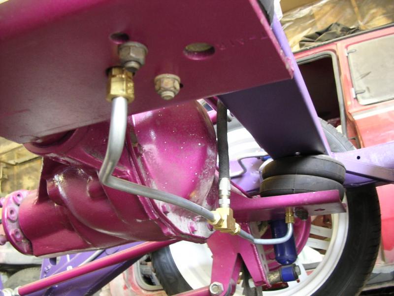

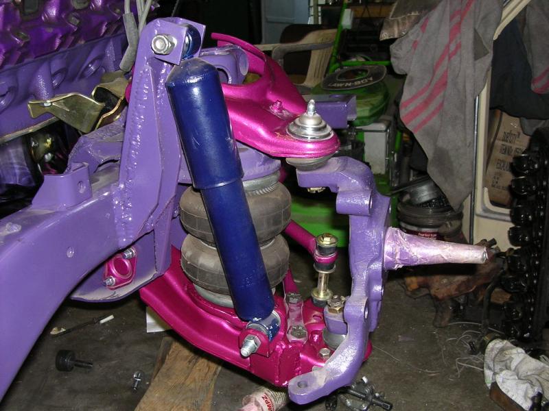

    Not sure if this will help but I got the full front air ride (brackets,shocks,bags,mounts,etc.) from Truckn.com for around $250 (aim industries). It's a weld in system but not to bad to do.
    Front system.

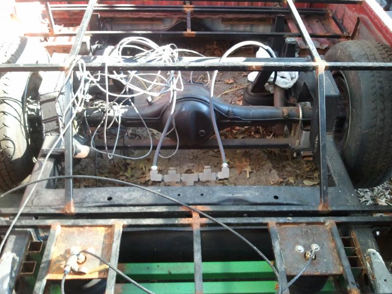

    The back was the X-member. bags, axle mounts,and misc. other parts.Not sure if it would work for you as I run a 4 link. Again its a weld in system.
    Rear system

    The guy I bought it from inherited his grandfather's old pickup and wanted to focus on restoring it. I have a 86 d-50 with a bad engine for parts. I am going to try and fill in the roof with some sheet metal. I am concerned about it though. I do plan to four link it as well. Anyhow I will start a thread as soon as I get all my parts and tools ready. I kinda fell out of the mini scene and did the Honda thing for a minute. Wasn't really my style though. And I completely understand the video game interference! Lmao! Thanks for all your input and keep it coming!! I will need all the help I can get!
    I have 3 sets of convertible tops for our trucks - they are nos ragtime minis kits. Unfortunately, I only have the vinyl top inself, no other parts. Ragtime mini was the first convertible top kit for minis back in the late 70's before hottops was in the business(now aim). I have an 80 parts truck that had a sunroof in it; I thought of using one of the kits as a mock convert before I realized the cab was toast. I can take pics of one if you like. The sunroof is intact in the parts truck, but it is too small for that hole. For something really different, do like the street rodders do and use a ribbed roof section from a van or old station wagon.

    What do they do with the ribbed sections? Use them for support?
    When they used the ribbed sections on a van, it was to keep the metal straight over a long distance without sagging or warping. On street rods, they were filling in the canvas sections on Model A sedans and phaetons that spanned 5+ feet in length and 4+ feet in width. On our roofs, its not necessary to have the ribbing on the roof; it was just a suggestion to have a different look, and add strength to the roof for adding a rack.
