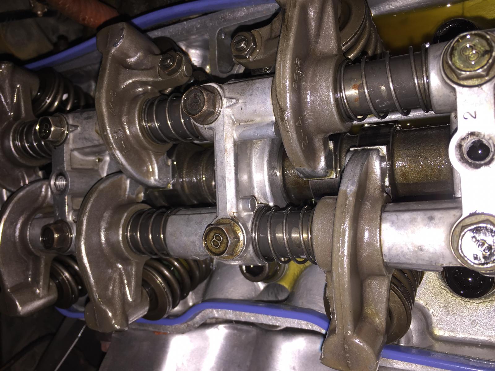

I also noticed a hissing/sucking/ "liquid being compressed through a tight space with air in it" sound coming from this area while doing leak down test. looks like a little rod that rides on the cams leading to some vac pump maybe? Im not sure what it is. Is this sounds okay? I can take a video of it tomorrow morning if needed.
Thanks again for your help.
