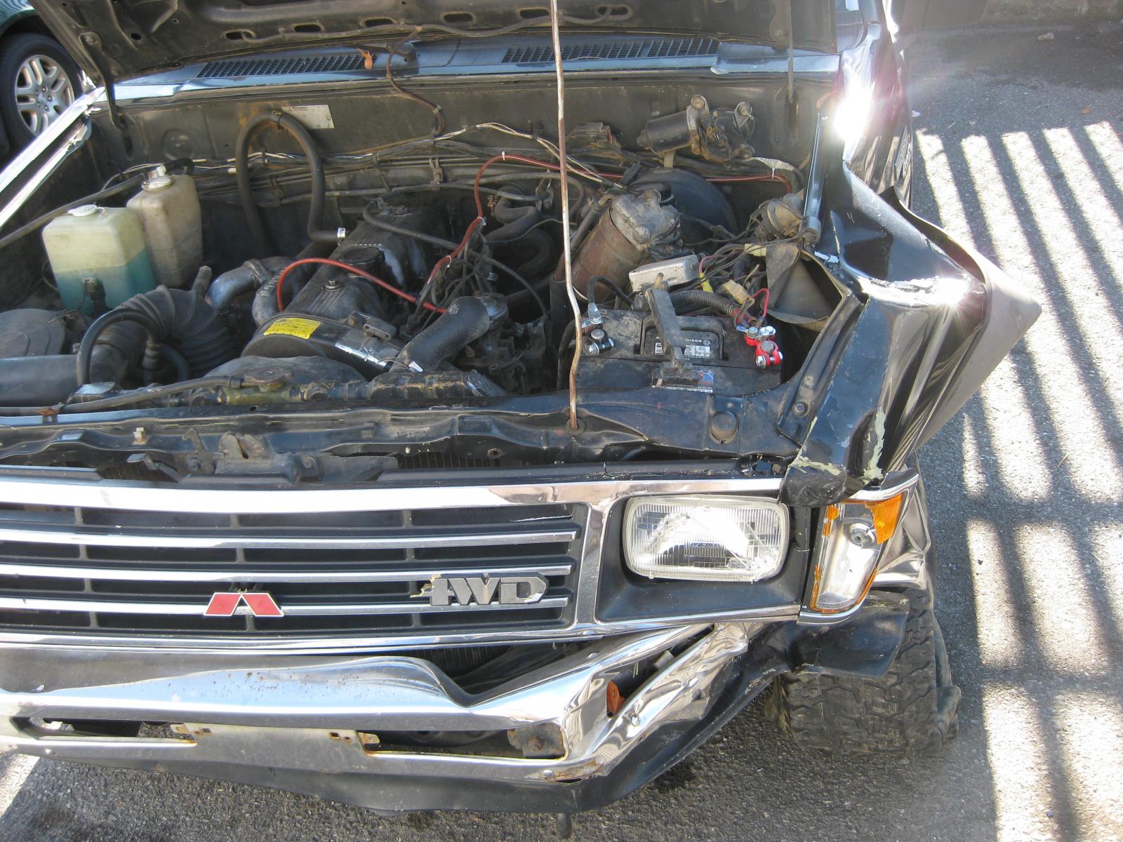

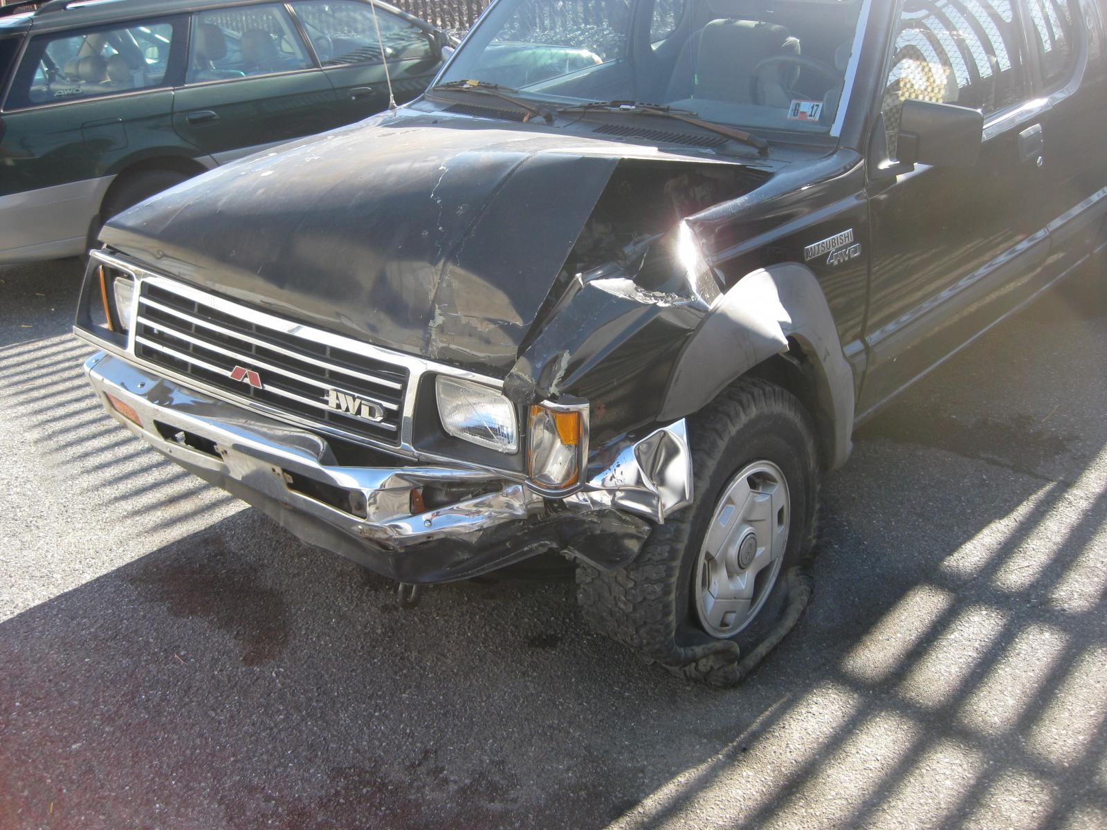

    The story:
    I was in a front end collision 2 days ago. Wet road coming down a hill and the car in front of me stopped at a green light to turn left. I locked up the brakes and slid probably four car lengths into her. By the time we collided I was going approximately 20mph.
    At first glace, I believe the frame is ok. I shut the motor off at the scene, so I know that made it. It didn't even blow the radiator, just pushed the fan into the shroud.
    What I do need is a ton of front end body stuff. Fender, inner fender, hood, bumper, grille, lights, and a lot of little pieces underneath that hold it all together.
    Which brings me to my question:
    Do I need to find body panels from a 2nd Gen Mighty Max/D50 ('86-'96), or is there any parts interchangeability with any other Mitsubishi vehicles? Of course I want to bring it back to it's original glory, but if I am having trouble finding the same front end and need to swap on a different front end, then that's what I'll do. I just want to be informed of my options when I start my massive search. As you can tell, I'm just worried about being able to find the parts.
    I am a mechanic, I just have way less experience with body work. Unless your talking about welding old rusted VW diesels back together.
    Thanks everyone.
    -Eli
    You need parts from 86.5-96 Mighty Max or Dodge D50(its imported twin). If you end up going with the 93+ bumper you will need the supports/reinforcement brackets for it. 2wd fenders are diff from 4wd as they don't have holes to mount up the flares, will prob be the hardest to find. Everything else is the same and will bolt right up.

    that looks like a rough hit - pulled down and back. You may be able to pull it back into shape somewhat with a chain and a tree / telephone pole if you can get the angles right to reverse the impact damage. Basically you are doing a shade tree frame machine.
